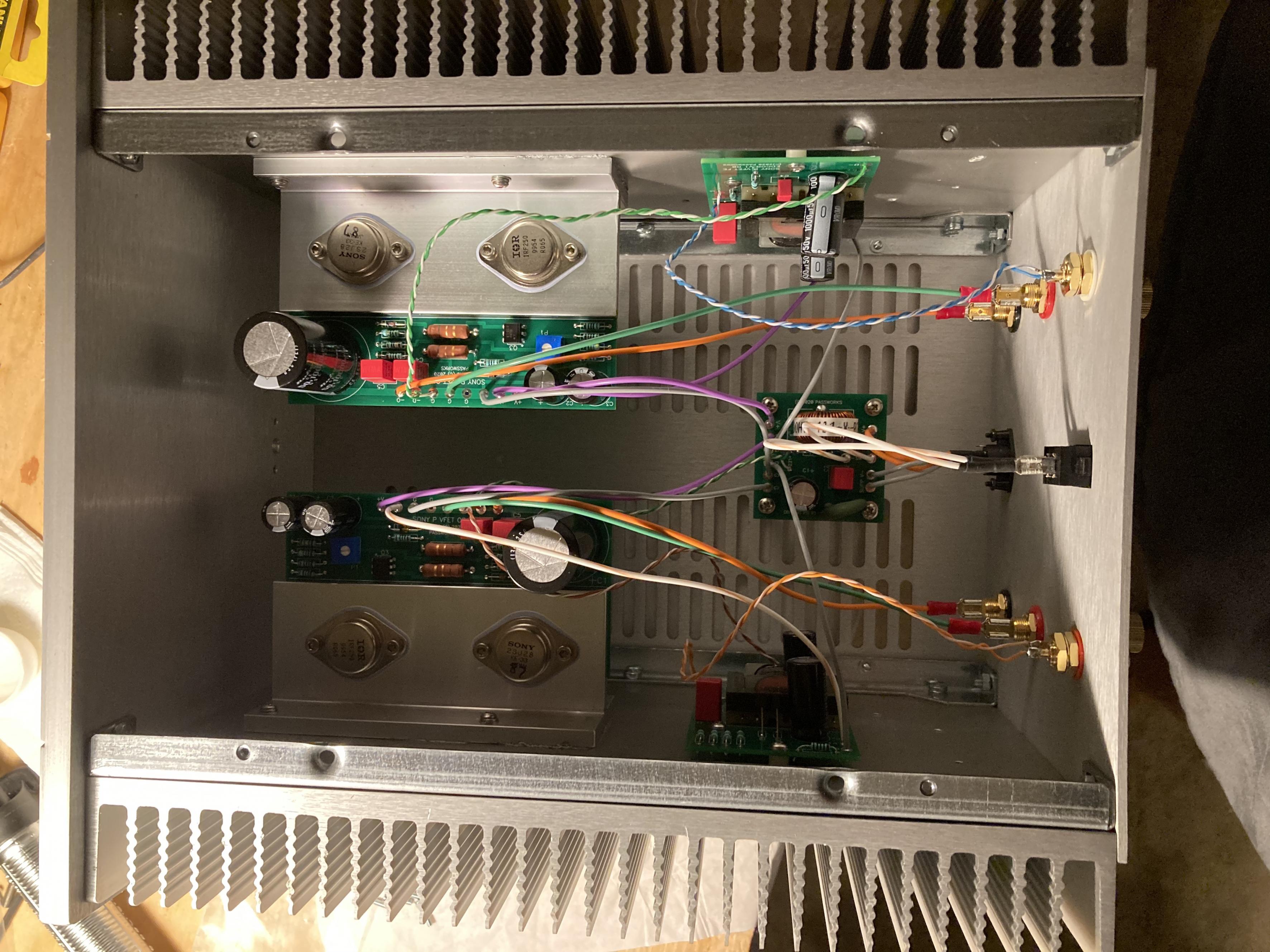

Finally got one channel hooked up. I have set the bias to 20V. As TungstenAudio reported, some upward drift with temp, but stable after 30min. Output DC offset 8mV. However, on turn-on, output DC spiked -15V before falling. Turn-off had a +15V spike.
Pass DIY Addict
Joined 2000
I was going to ask about the same behavior on start up. I am seeing -15v about 4 sec after power up. It declines rapidly and is at -5v by 15sec, and -180mV by 1 min. By 3 mins, it is at -25mV and steady state when warm is about -6mV. Both channels behave exactly the same way.
Guess it's not to worry about.

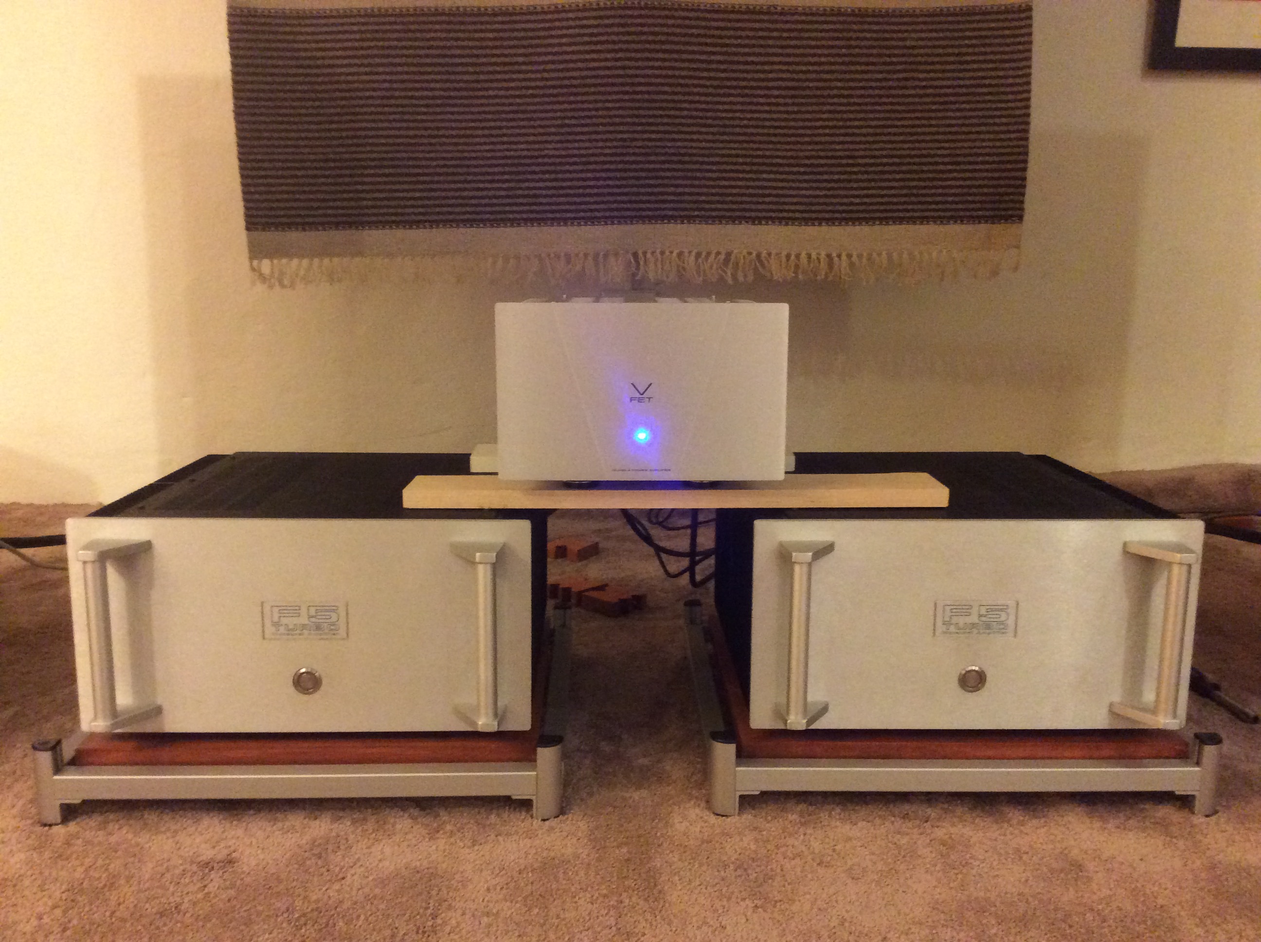

Folks:
Thanks for the support! Number 12 is up and running. This is a fun amplifier; it has much of the authority of my F5 Turbo mono blocks (more so than my F6) and it has a very good grip on my Elsinores. The soundstage is a little narrower than and not as deep as the F5T. The soundstage is more on a par with the F6 but there is precision here; neutral and well-balanced. It's doing a lovely job making my speakers fade into the background. Given the strengths of this little amp, Nelson's larger Sony VFET amplifier must be amazing.
As always, thanks to NP, diyAudio and the community. And HiFi2000 -- really cute chassis!

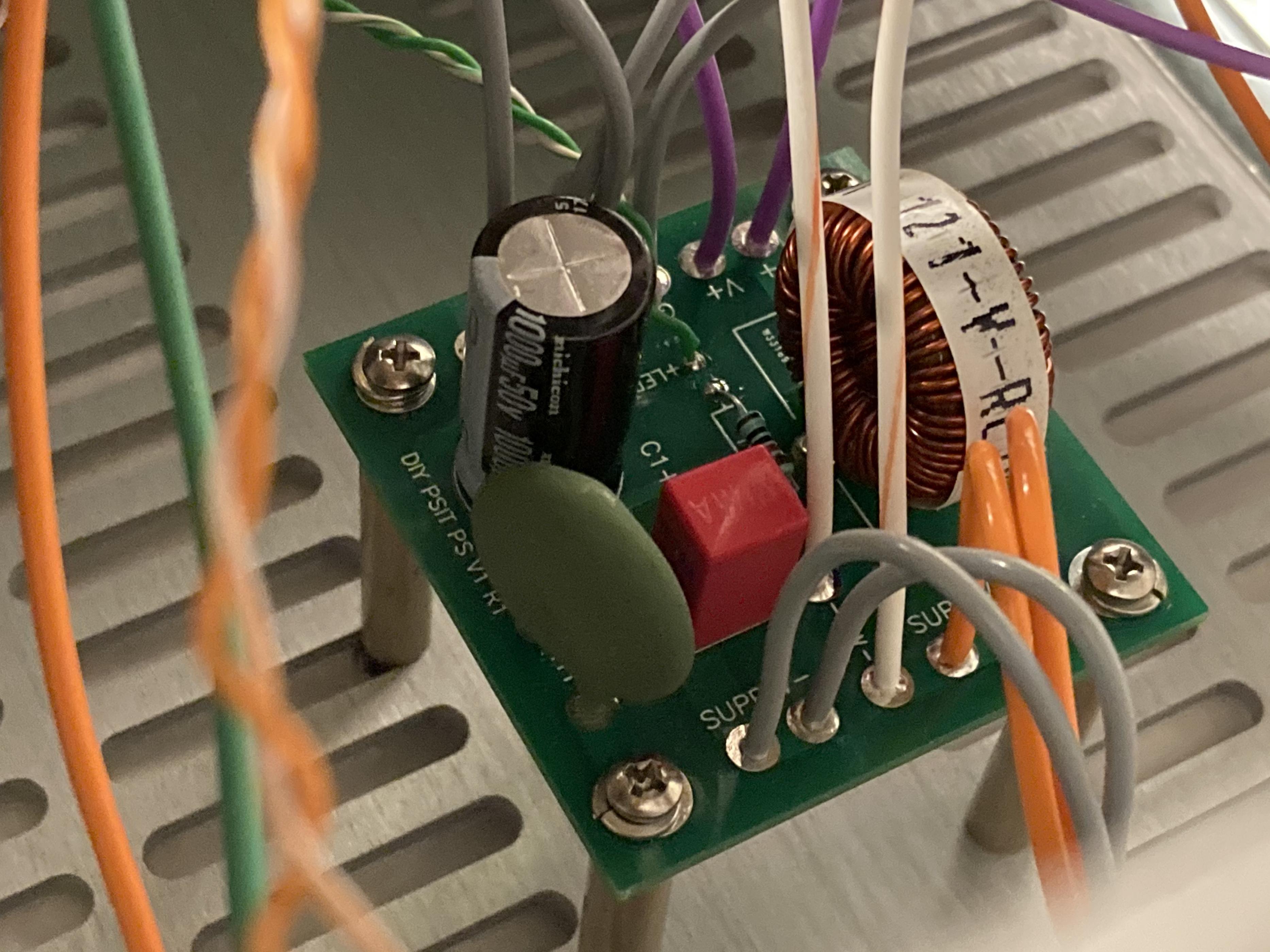

Supplied speaker and ground wires are not long enough to reach the posts. I followed the instruction in the guide to the letter and they are incorrect.
Please make grey, orange and green wires 4 inch longer. I have plenty of signal wires left over.
The head of the bolts supplied to fasten the supply board to the bottom plate are barely wider than the plate slots. Consider using a bolt with wider head or a washer.
I had to use higher stands and lift the filter board up in order for the wires to reach their destination properly, I will have to replace the orange wires of the left channel. I m about to fire this up and adjust xfingers.
update: adjustment done...started at 18.75 V, brought up to 20...purring like a kitten! I m hooking it up to the altecs!
btw the sony gets hot QUICK!

I'm sure I can't be the only one with this question...
In the wiring diagram, it is showing the outer tabs of the power connector (continuity to -Vo and mains Earth) connected directly to the chassis.
Is this similar to the safety GND for a mains voltage supply? Chassis is connected directly to mains earth, and "Audio GND" or all the "G's" on the boards are lifted through the thermistor....?
I am also confused by this. I am still waiting for my kit, but if the MeanWell brick is similar to all my other MeanWells, the DC output side is nicely isolated from the mains side. This means there cannot be any "mains earth" or "safety earth" in/at the amp. Also, the shield and the -Ve wire share the same connection inside the MeanWell brick, so the thermistor between the -Ve/GND and chassis is shorted and does not seem to have any function.
Can anyone shine some light on this?
I just measured my meanwell and both the 0V and the shield around the din appear to be connected to the plug gnd. Seems to me the gnd is real.
The supplied meanwell is NOT isolated, i.e. Earth Ground (AC side) is connected to the DC negative output (AND the shield)
I you want to preserve the isolation from audio ground to earth through the thermistor on the power input board, you must NOT connect the shield of the power connector.
