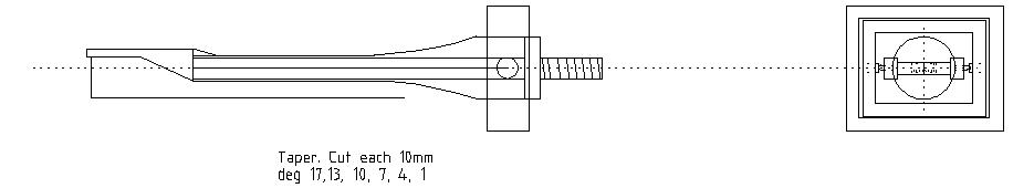

Use an aluminum section instead of making one yourself?
And use epoxy or silicon as the damping element in the joint.
I have not seen the drawing.
The problem is 7075 T6 aluminium tube is not available, I can even buy 6061 T6 tapered tube. The only option is to machine it myself.
There will be no epoxy in the arm. The goal is a rigid arm tube including the CW stub. The drawing is in my last post.

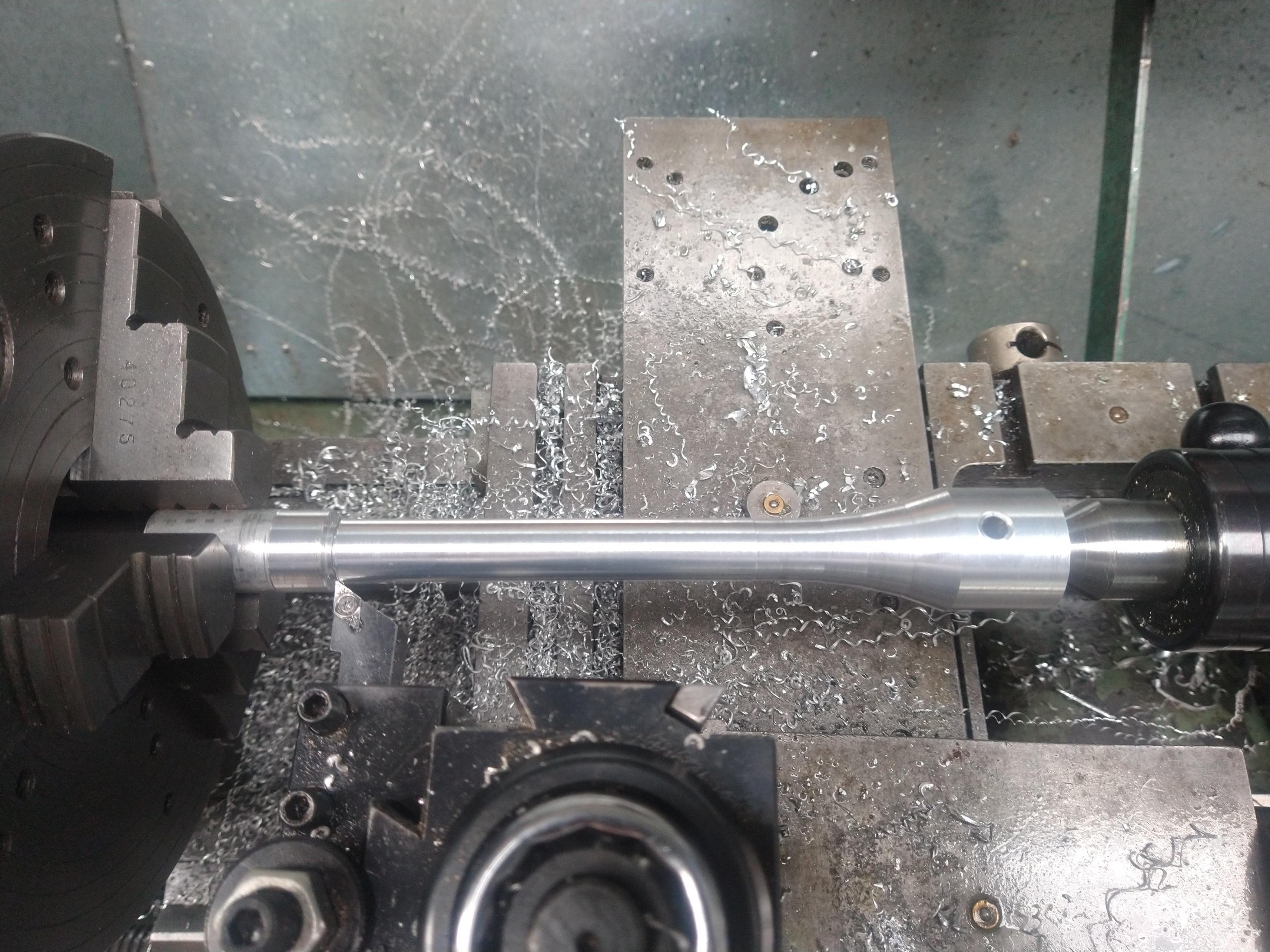

I can buy 7075 T6 round bar locally. I have the machining capability so I can also make the wall thickness vary over the taper.

I know using off the shelf CF or aluminium tube would make fabrication of the arm wand easier. My decision to machine the wand from a billet of aluminium is to have no joins in the wand, glue joints however good provide a reflection point for vibration traveling down the arm.
An arm made from a single billet has no reflection points so almost all of the vibration energy will travel down the arm to the bearing before some is reflected back to the cartridge. The heavy variable taper will prevent vibrations being reflected directly back they will bounce around in the arm so what energy does return to the cartridge will be attenuated.
This arm will have the headshell and arm wand machined as a single structure. The arm wand is 30mm OD at the bearing housing and 12mm at the headshell.

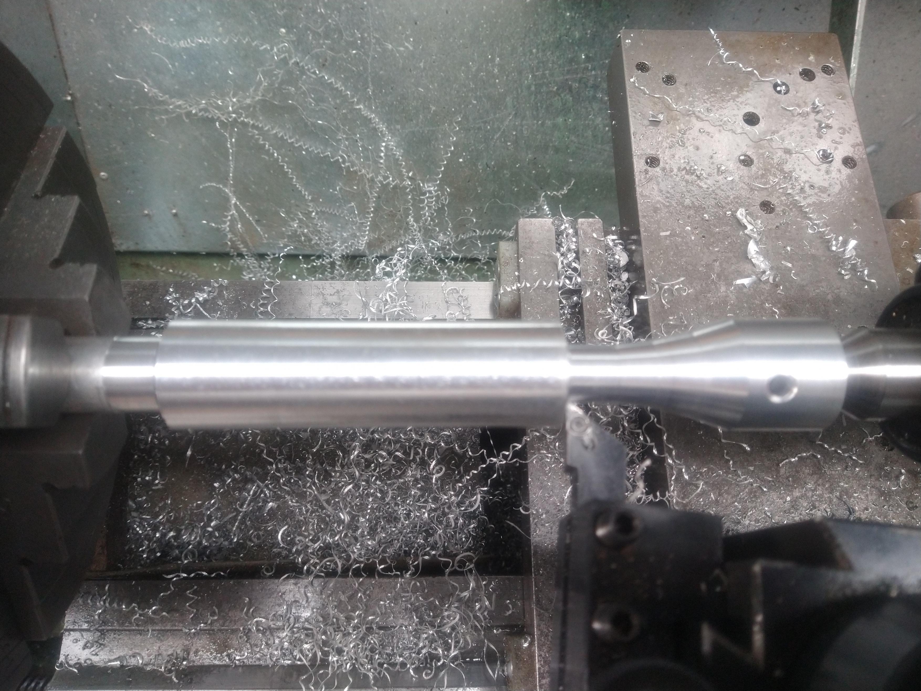

Having a variable taper in the arm wand greatly reduces reflected vibrational energy traveling back to the headshell. So it's important to have as few joins in the wand as possible.

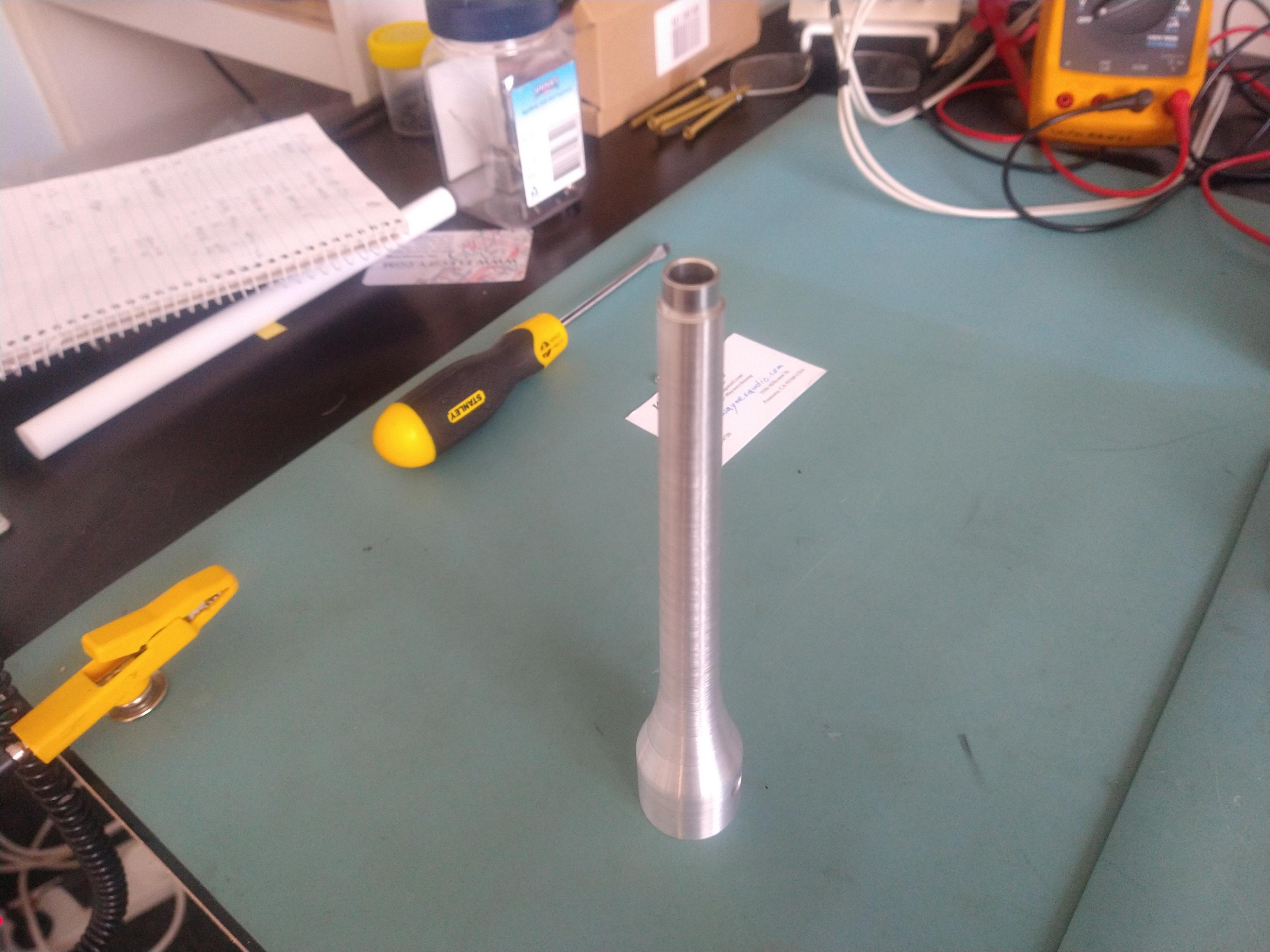

Just thought I'd post pics of the arm wand I finished machining today. The bearing end is 30mm OD with a variable taper for 40mm then 1deg straight taper to the headshell.
