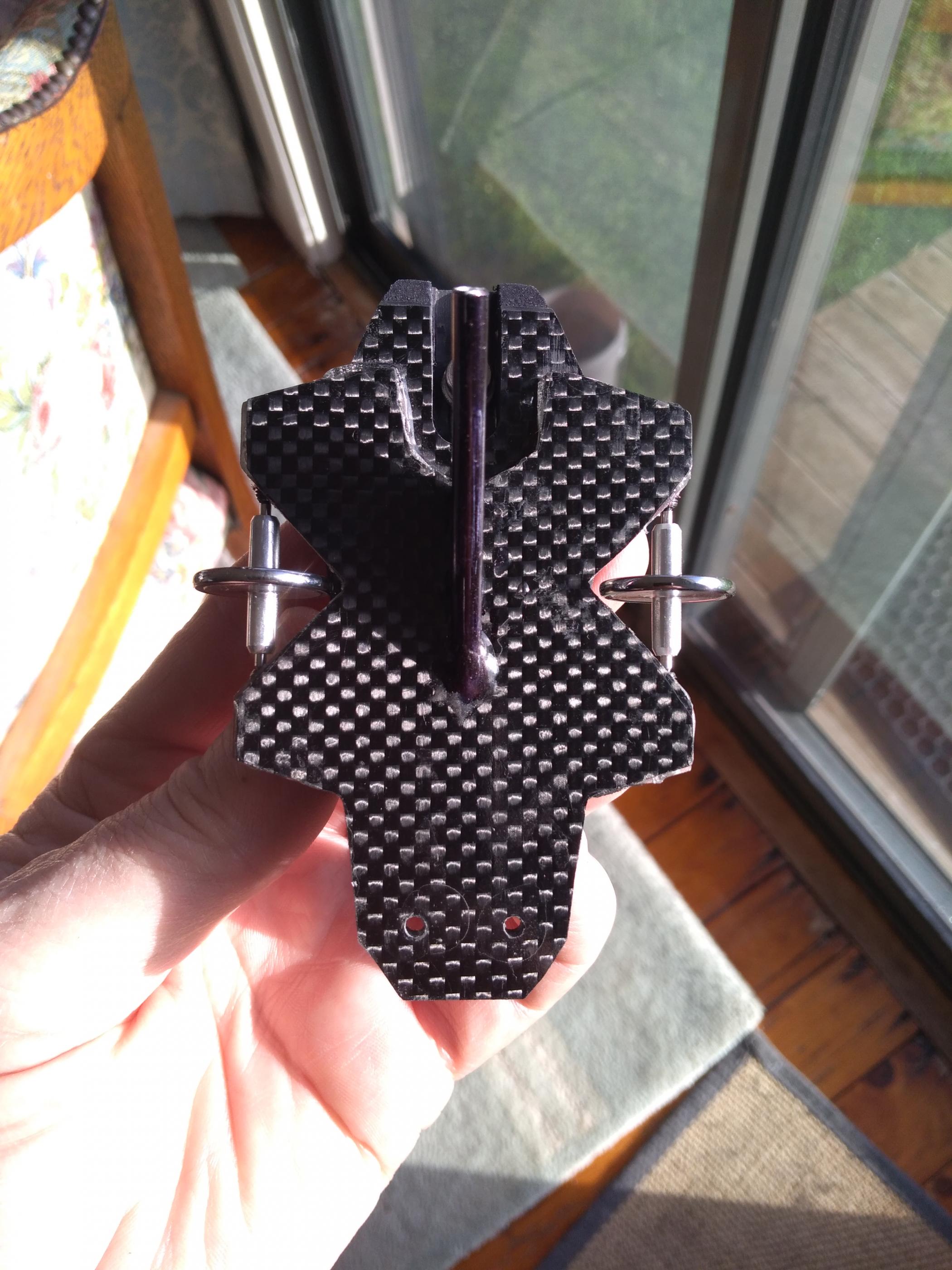

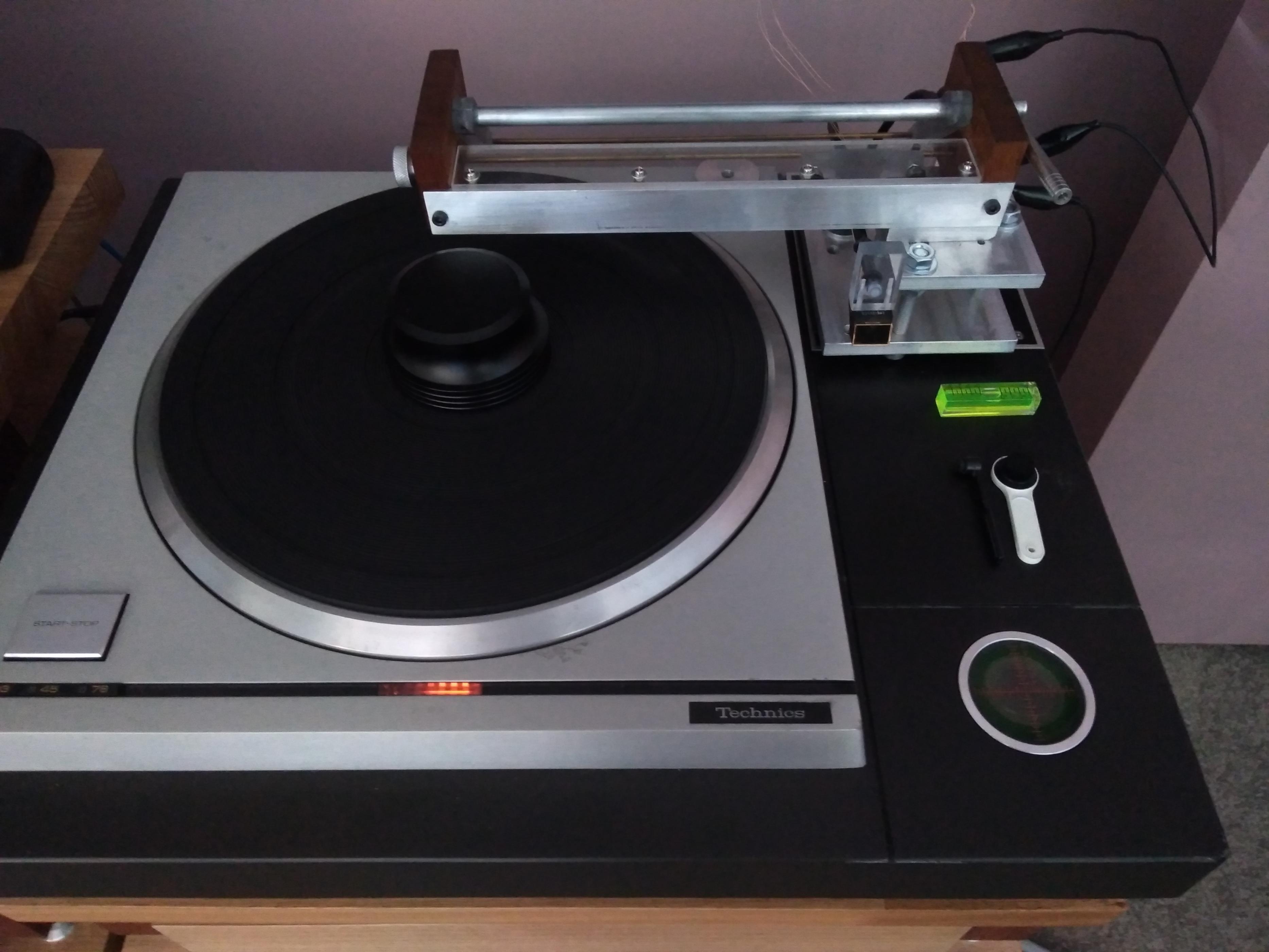

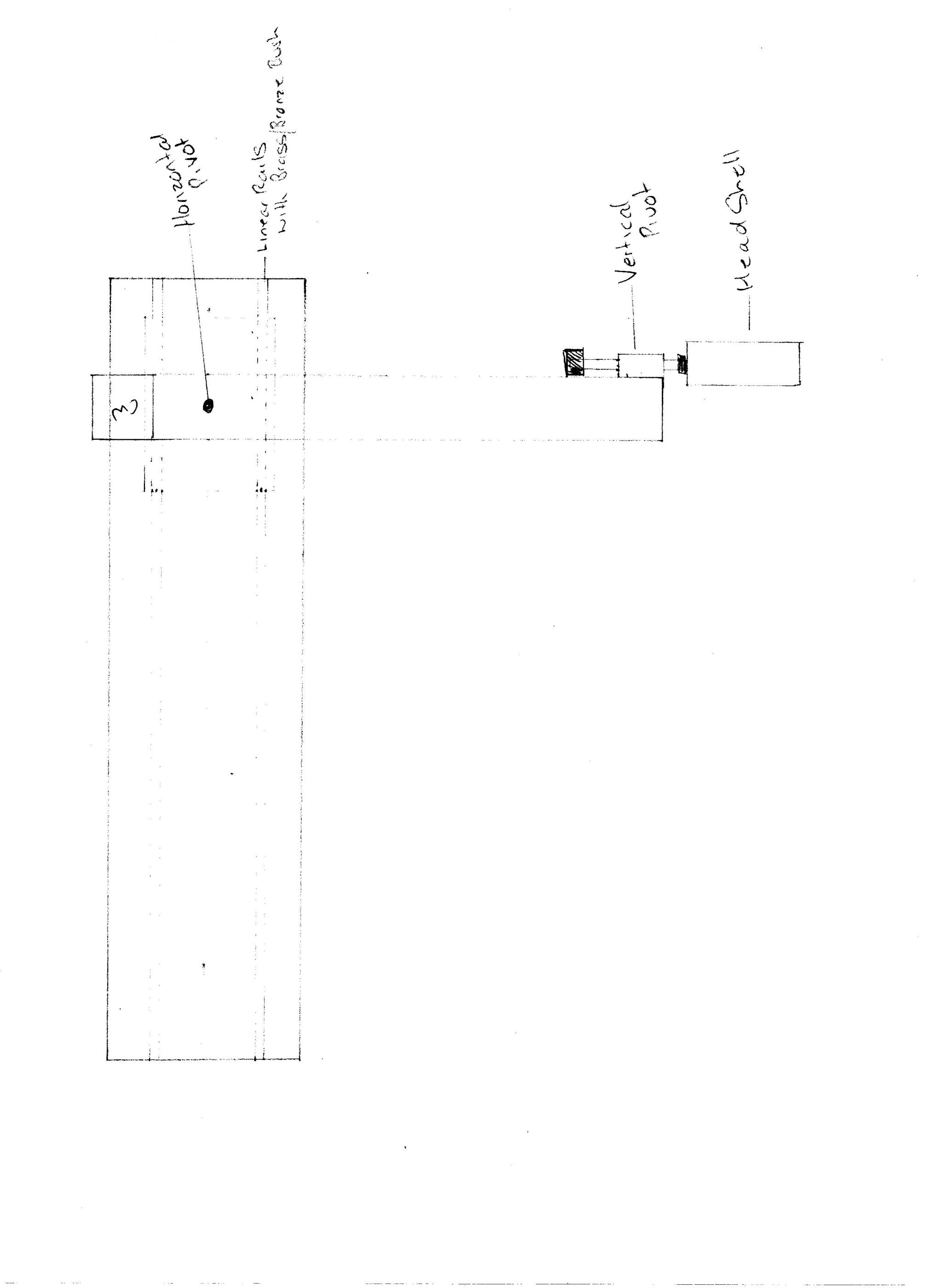

I have been experimenting with LT tonearms over the past 6-8 months, and have built 2 different LTA's with 4 different carriages. During this process I have learnt that a short stiff carriage/armwand is what is needed.
LTA 1 - Built as a proof of concept. This was about as good as my reference arm a Technics EPA100. Bass response was better and noise floor slightly lower. It struggled with stock bearings to track the Stanton 881s so I increased the diameter of the wheels which made a huge difference. Changed to my Technics EPC205mk2 with a Jico SAS.
LTA 2 - This is a total rip off of the Clear Audio TT1 and Niffy's carriage (the FROG). What this does amazingly is lower LP surface noise to levels I have never experienced, detail and dynamics are fabulous. Its issue is tracking off centre pressings where the voice has a lot of energy, I can hear distortion in each channel as the carriage moves back and forth. I built another carriage this time 20g lighter. This new carriage still has distortion on very heavily modulated tracks on the test LP, but I haven't heard it on music yet. It sounds great, but does have higher surface noise.
The reason I started this thread is I am considering building a motor driven LTA and I'm looking for others thoughts and ideas.
Goal is to duplicate LTA 2's FROG performance without the distortion tracking off centre pressings. Is this even possible
First decision is either mechanical servo like the Rabco or use an Adrino robotic controller?
Arm will be split effective mass like the Dynavector DV505. Main arm to be large and rigid with horizontal bearing and secondary arm on the end with vertical pivot.
Technics SL1200 bearings can be used for both pivots.
Carriage will run on 2x 8m linear rails in brass/bronze bushes.
Drive will be toothed belt driven by O rings
Drive motor 12V geared run at lower voltage to keep noise low

I was hoping you and Ralph would add your experience with servo LTA's. I have the mechanical working exceptionally well on good pressings but on anything with a lot of modulation (female voice especially) and off centre I can hear distortion that is not there on my Technics arm so I know it's carriage inertia causing this.
My idea with the DV505 style is to split the vertical and horizontal effective mass. I hadn't considered the Revox style so I asked Dr Google and a mate who has a Revox B795. The Revox style arm maybe a better approach.

Hi Ray,
Been thinking about this, the only down side I can come up with at the moment is carriage damping. I was going to use a silicon oil bath to dampen arm resonance with the Rabco style. The Revox short arm would require this over the LP?
Any thoughts.

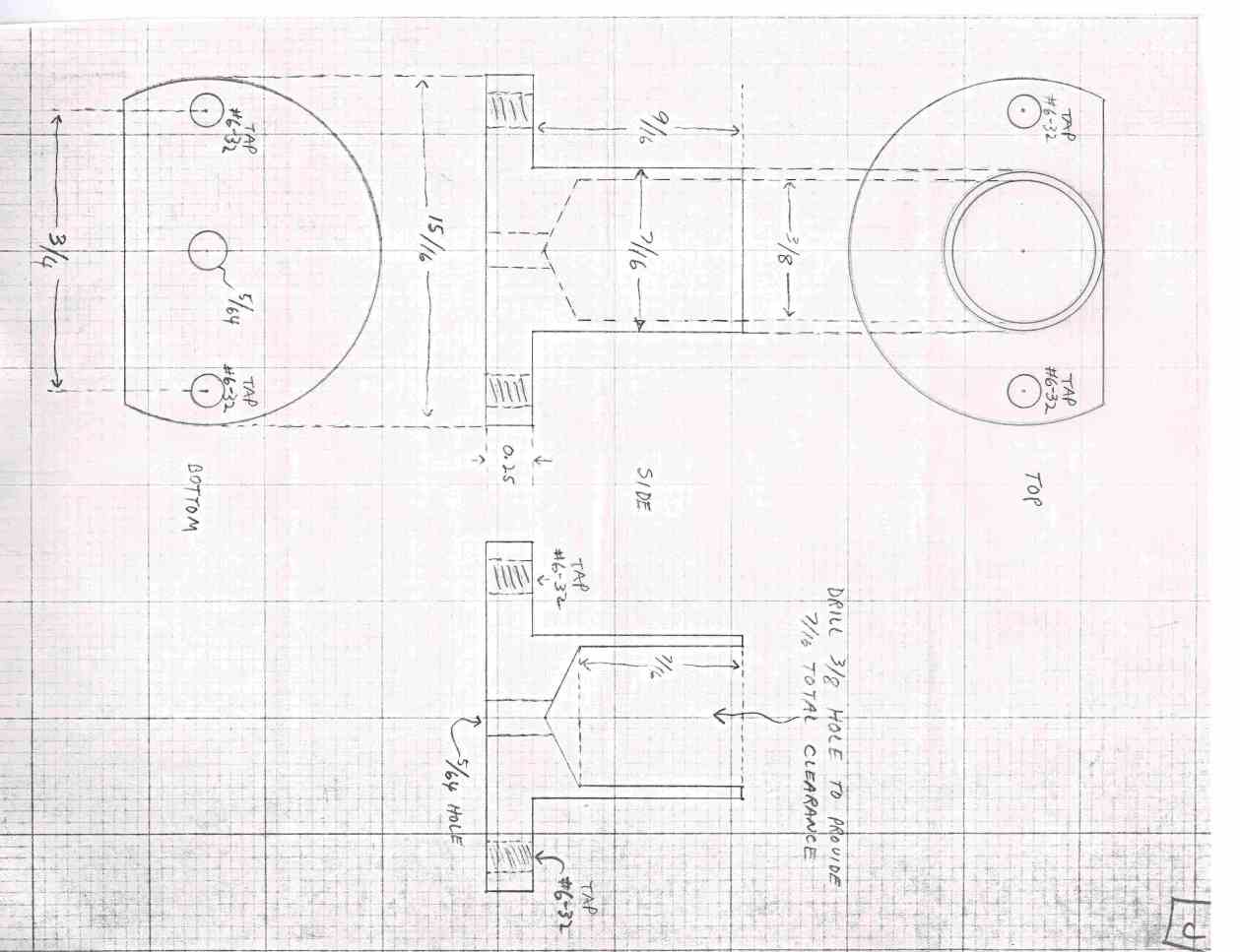

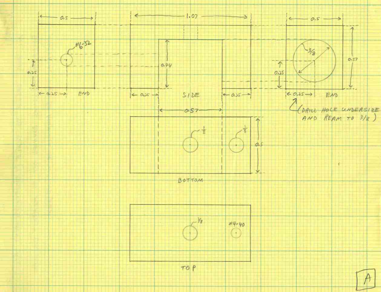

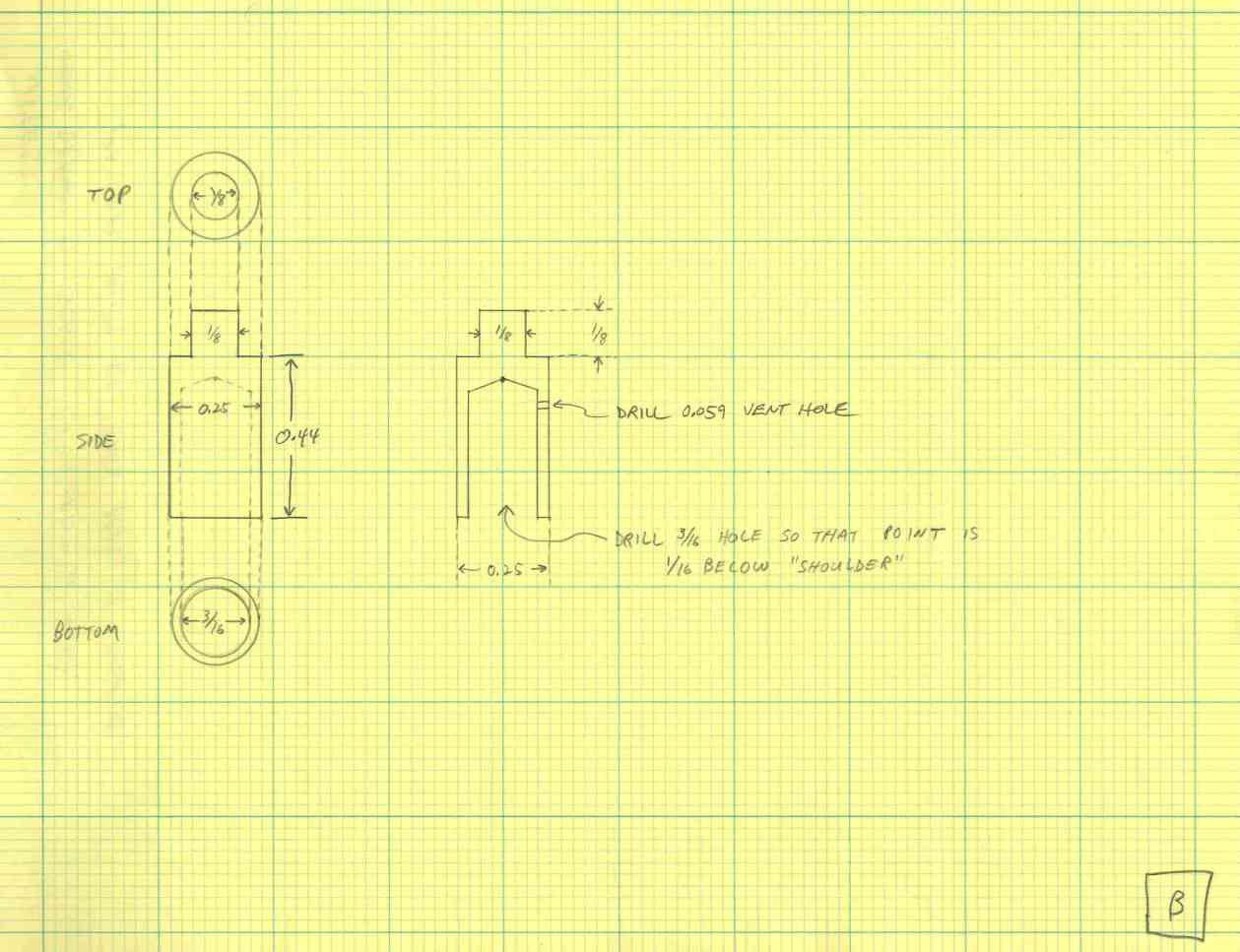

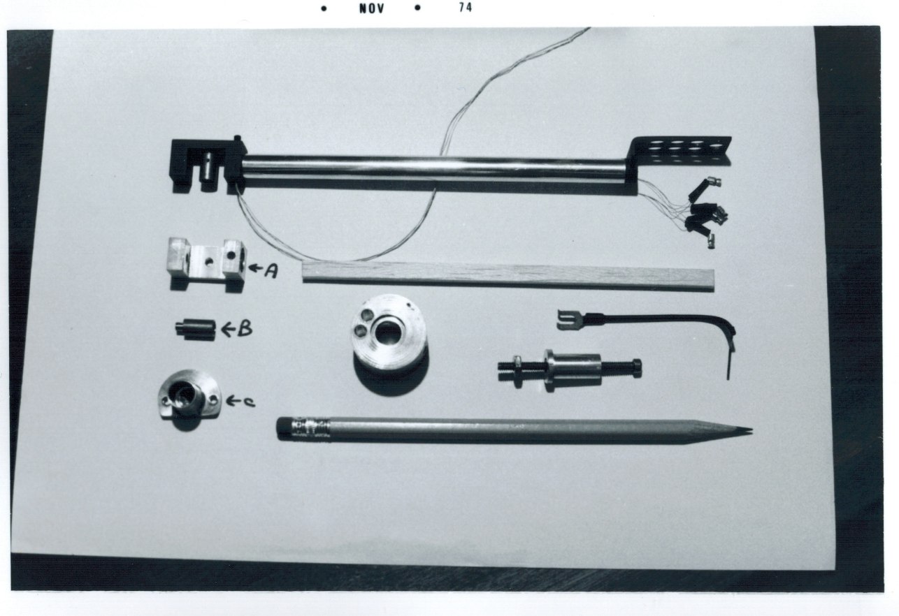

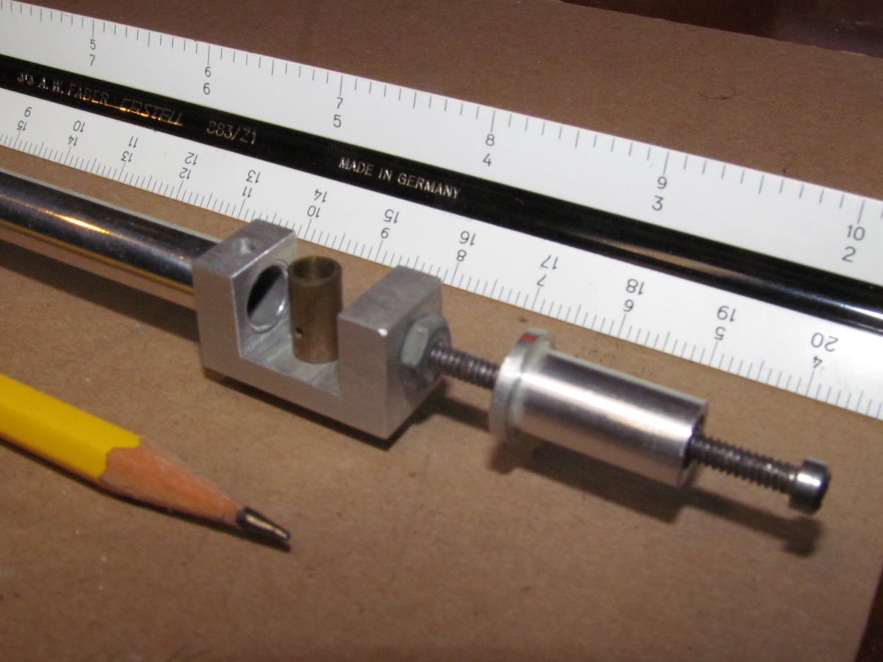

Warren,
As a diy’er I am partial to unipivot bearings. They are easy to make. They have low friction. They are automatically preloaded to the correct amount just by sitting there. It is very easy to incorporate viscous damping as an integral part of the unipivot design. If you put a unipivot arm on a servo driven carriage and get rid of the offset angle, all stylus drag forces and vertical warp induced forces are in the same plane as the unipivot bearing, so there is no residual torque causing azimuth shift.
These are the sketches from my arm. It uses an inverted brass cup bearing (part B) that sits atop a high speed steel rod with a ground point. The cup bearing is press-fit into an aluminum yoke (part A) to which the arm tube and counterweight support are attached. The steel rod is press-fit into a brass cup/base (part C) with the point upward and the brass cup/base is half filled with silicone damping fluid. Sorry, I never got a picture of the finished rod assembled into the cup/base. Unlike outrigger oil trough dampers that are applied to conventional arms as an afterthought, the silicone fluid used here is thick and will not spill or run, even if you turn the whole assembly upside down for several minutes. I would have no qualms with something like this hovering over the LP.
https://www.diyaudio.com/forums/attachment.php?attachmentid=862061&stc=1&d=1595214211
All parts
https://www.diyaudio.com/forums/attachment.php?attachmentid=862062&stc=1&d=1595214211
Part 'A'
https://www.diyaudio.com/forums/attachment.php?attachmentid=862063&stc=1&d=1595214211
Part 'B'
https://www.diyaudio.com/forums/attachment.php?attachmentid=862064&stc=1&d=1595214211
Part 'C'
https://www.diyaudio.com/forums/attachment.php?attachmentid=862065&stc=1&d=1595214211
Parts 'A' and 'B' assembled
Ray K

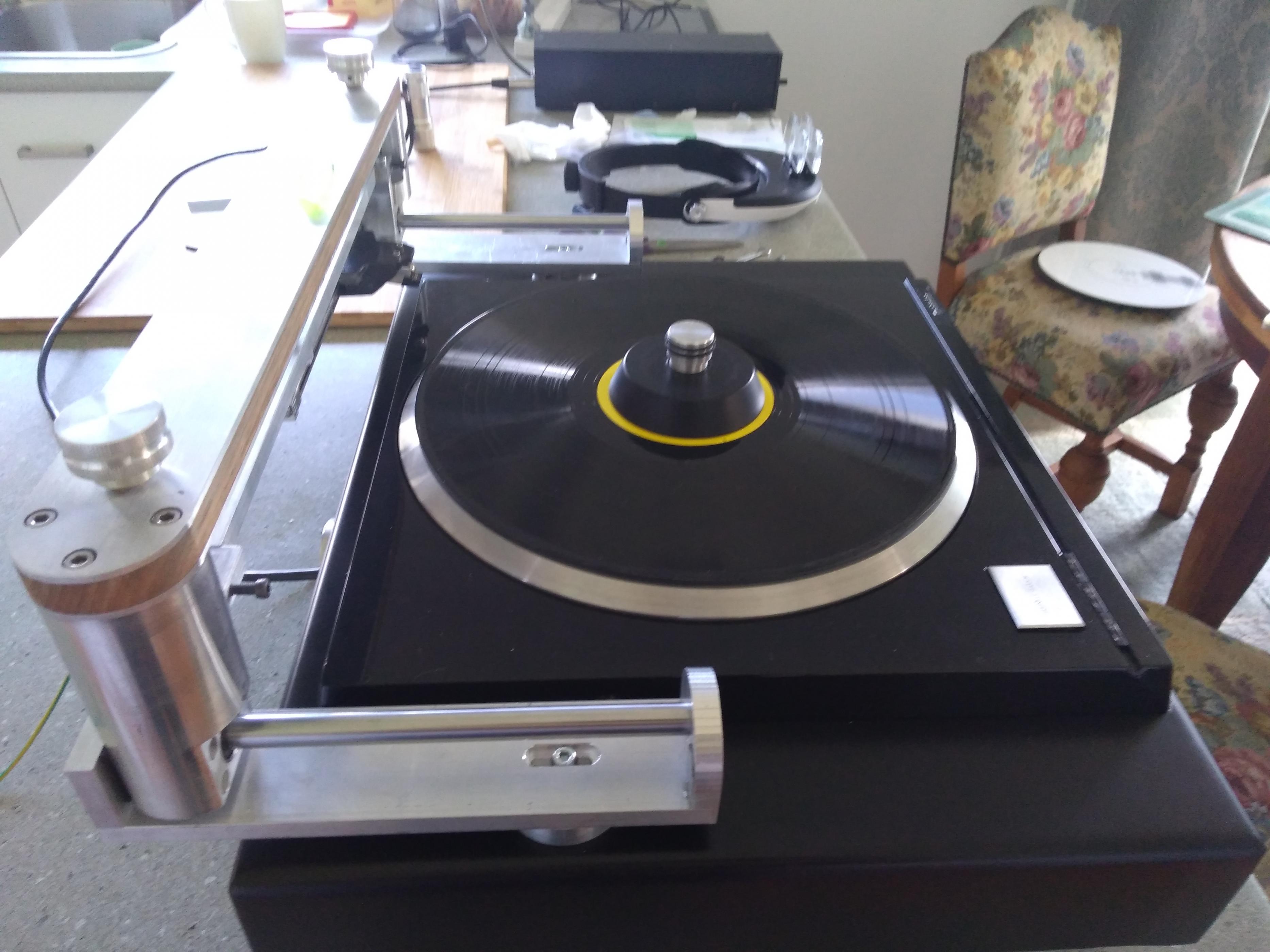

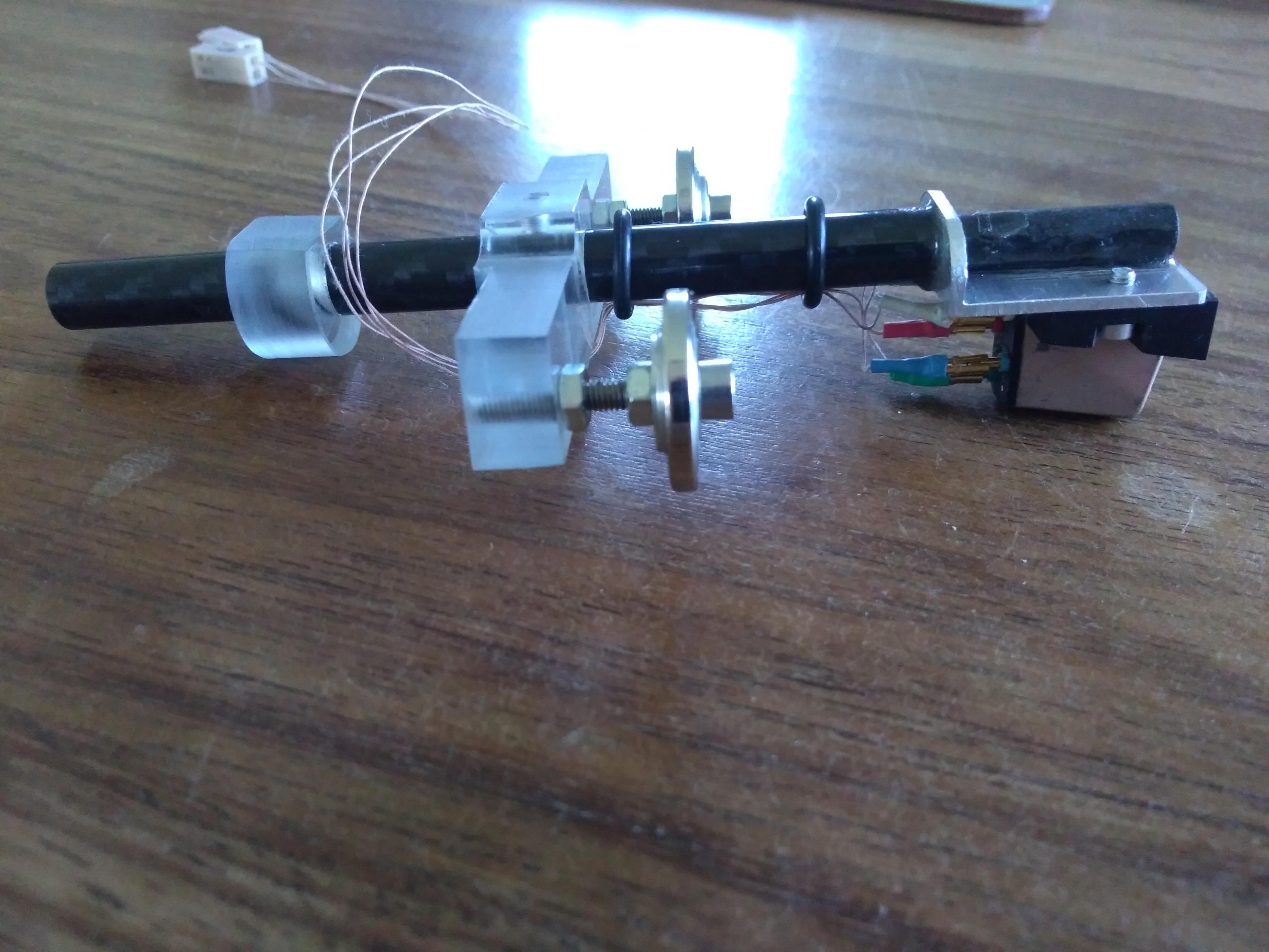

I have ordered all the bits to motorise the carriage using an Arduino and a geared motor. Time to learn to program.
Did a quick sketch of a unipivot to run on the rail. Dual carbon fibre tubes to increase rigidity and the arm wand will be removable, clamped by the 2 vertical bolts in the top.
Plan is to use 2x MGN9 rails under the carriage, this will leave the arm with nothing over the top so as to make setting up and changes easy
Does anyone have opinions on carriage drive my thoughts are lead screw with nylon nut or toothed belt.

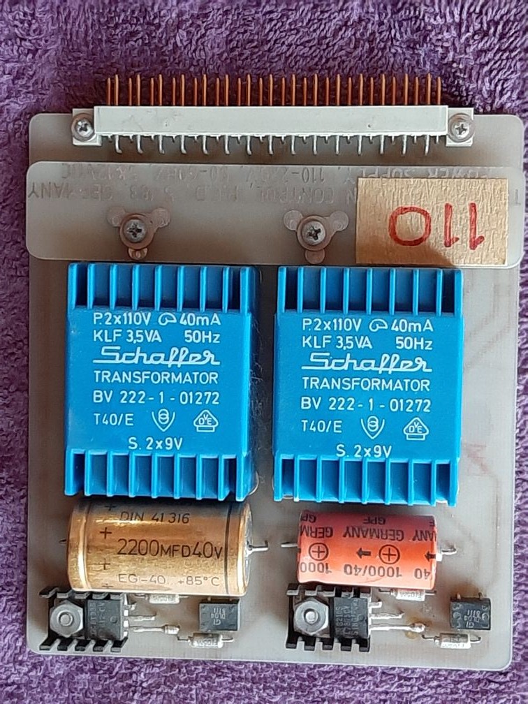

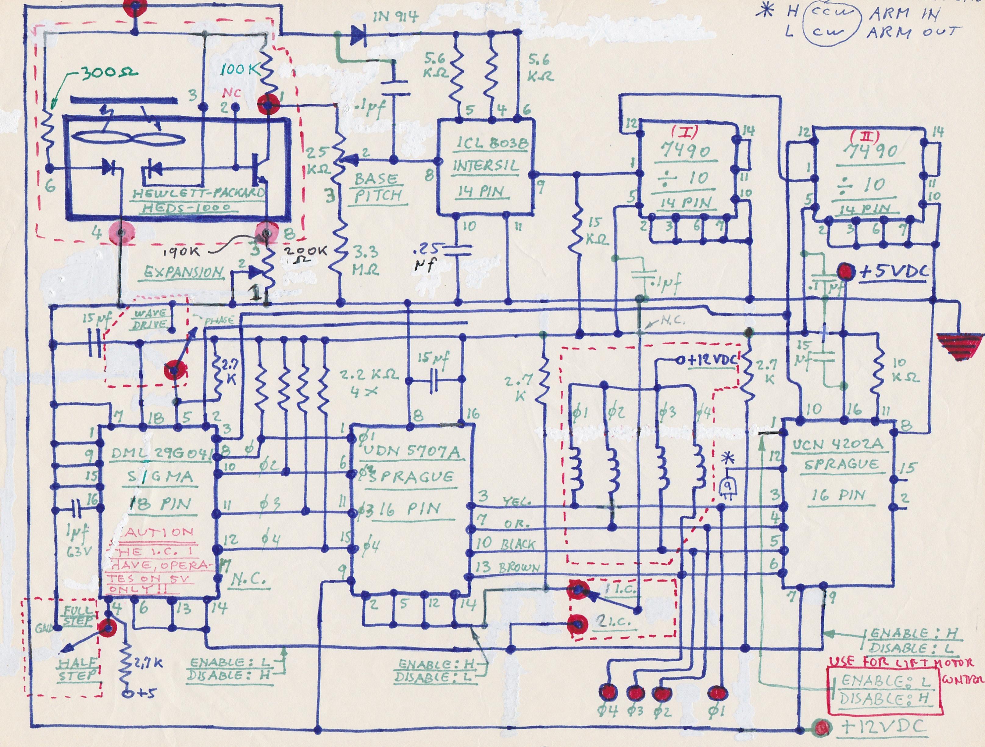

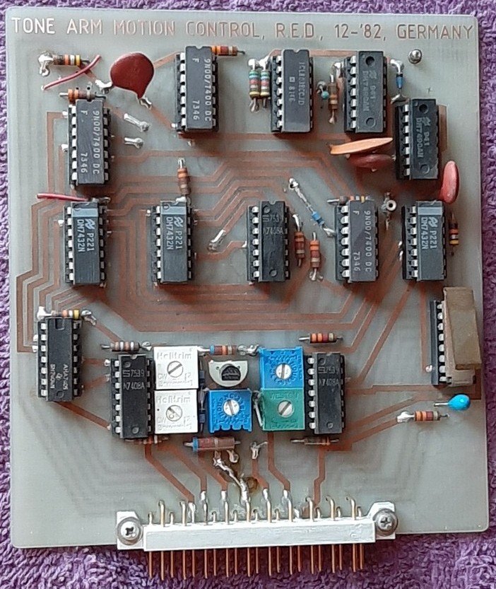

Hello Warren and Ray,
I finally got my files together. I think I'll post the pictures first and type a description after that.
I controlled the tangency of my first tone arm with an HP HEDS-1000 optical sensor. the target was a membrane of chrome mylar with half of it painted flat black. The analog output of the HEDS-1000 was applied to a voltage controlled oscillator. The VCO was supposed to be able to output frequencies as low as .1Hz. However, I could never obtain that low a frequency from that IC. So I used two "divide by ten" ICs and then applied that signal to a Sprague Electric UCN 4202A stepper motor driver to drive the carriage motor.
Not having any test equipment, I provided a digital display on the front of the control housing to alternately show a one and a zero every time the motor took a step. Then I played steady state tones from a CBS test record and listened to variations in pitch every time the carriage motor took a step. That was an excellent test, because I have always been sensitive to variations in pitch. (it drives me nuts if I can't tune my guitar just right) The Sprague Electric IC UDN 5707A is the driver for the seven segment display on the front of my control housing. The carriage was moved by two silicon o-rings and they effectively absorbed the shocks from the stepping motor.
Other circuits included on the circuit board, are TTL logic ICs to control the tone arm lift motor. They made sure that, the carriage motor would not run when the tone arm was being lifted and vice versa.
I did not design the circuit myself. I had major help from Richard H., an engineer at Scully Recording Instruments in Connecticut where I worked at the time.
And I almost forgot: the PCB on the right is the 5 and 12v power supply, 5v for the TTL logic ICs and 12v for the Airpax stepping motor.
