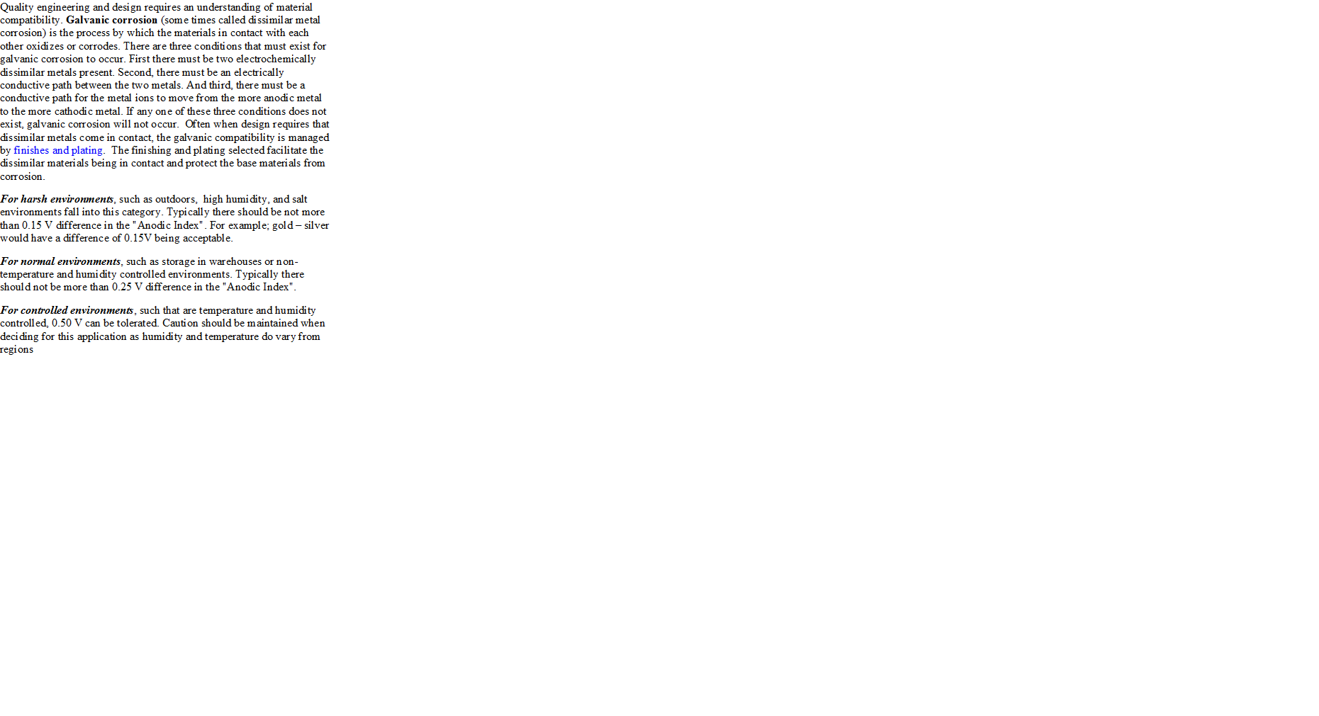

I did a bit of research yesterday on galvanic corrosion between dissimilar metals. What I found was very interesting.
Ya' know, you just never know where a project will lead you, and the seemingly unrelated facts you'll learn.

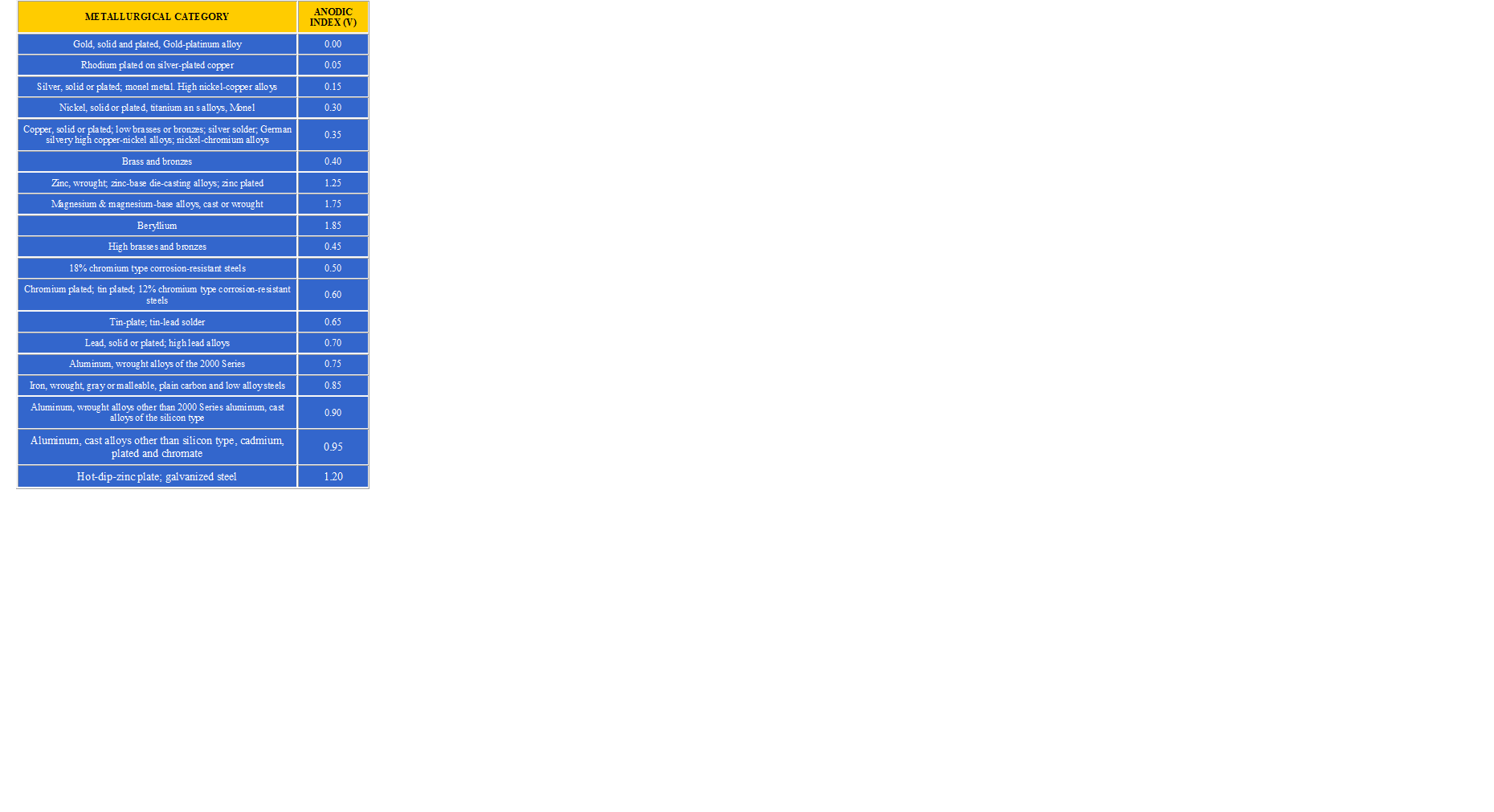

Here is a text and chart of reactionary values of dissimilar metals.
Added moisture aids the galvanic process, ie; sweat, humidity or worse yet acid environments.

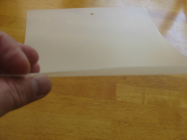

Only sure way is to prevent continuity. I'm going to use one of these as a gasket between the tower pieces and the gallows arm. 🙂

Going off on a tangent here, but, Zinc Phosphate, which I use as a conversion coating on aluminum prior to powder coating has a fantastic side benifit. It's dielectric as well as a corrosion prohibitor! I'll try it out and see if it works on polished surfaces of aluminum and brass. Easier to detect any etching if it's polished first. Once again, just thinking out loud.

Yes, I have a table like that in a book I bought when I was a kid. Your insulating sheet should work fine. I suspect that your zinc phosphate idea will depend heavily on how good your finish is (surface projections will punch through).

For any brass to dissimilar metal joints, PTFE thread compound is cheap and effective. Neversieze is an old favorite, too.

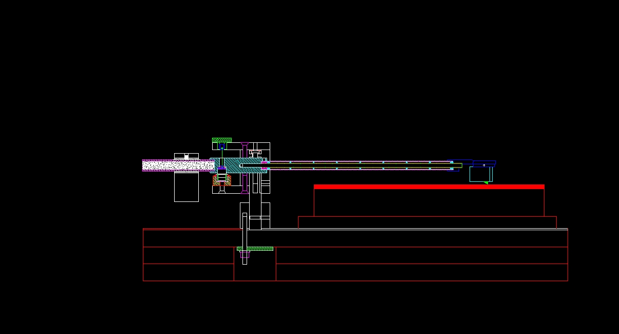

How did you calculate the length of the gallows arm(s)?
Does it matter?
The only thing I can think of where it could be a problem is if it's too short, the counterweight would bump the arm.

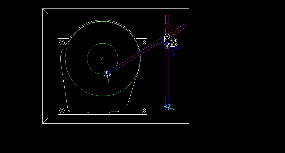

The arm was a co-development with the plinth I was building for my Garrard 401. I laid out various configurations of arm length and geometries and ended up desciding on a 10 1/2" effective length arm. I decided the dimensions of the plinth and where I wanted to place the arm to get the length and width of the plinth to what I was after as far as size
From there I simply drew up the arm components to accomadate travel across the record and clearances of the components during arm travel at the same time keeping in mind the original layout and intent of the Schroeder Reference arm.
Not really that complex if you break it down to the individual components. Of course there was a lot of trial and error developing the final drawings.
You have to look at the arm in 3 dimensions, (or at least conceptualize it) and keep in mind what everything is doing in relationship to each other.
For example...the plinth and turnatable you are going to use to be able to see how much adjustabiltiy you need to design in. I gave myself a range to be able to dial it in once built. a byproduct of this is to let me put the arm on different tables if I so choose.
If you look at the attached drawing, you can see the arm at rest position and at full swing. I then designed the bas and arm to accomodate this movement. The arm geomerty came first, then the rest of the support componets came after.

JD,
Thank You, very detailed without being prescribed. As usual.
Your CAD drawings are superb, and a work of art in themselves. The gallows length is, as I would have guessed, variable. Depending upon it's relationship to the platter. I cannot foresee any issues with being too long, perhaps vibration? Probably not.
It occurred to me, that unlike most TT arms, this one needs to be located on the axis of the string / magnet point rather than the center of the tower platform. Something to keep in mind when drilling a hole in the plinthe ........................ this rabbit hole keeps getting deeper and deeper........LOL.

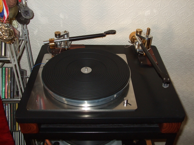

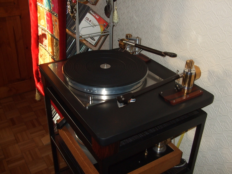

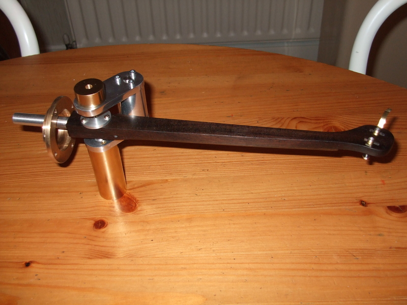

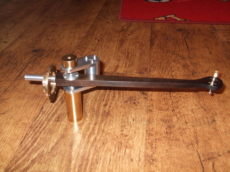

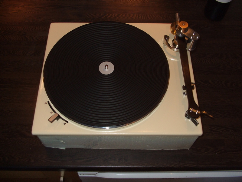

Hi, heres another magneticly suspended tonearm specificaly for a Lenco project, this one fits right on the standard Lenco, and uses the original arm lifter.
The use of a tapered square arm section reduces the amount of turning considerably.
The lower magnet is mounted directly into the height adjustable mounting column, and the upper magnet in a small turned item bolted to the rosewood wand.
I found this method of construction saves a lot of awkward precision turning, and its much quicker to make.
Obviously the arm is awaiting a proper counterweight in the first two pics, but the final pic shows it almost finished mounted on a Lenco.
Still a little bit more final shapeing to do, before i am completley happy with it, buch much simpler and cheaper to make.

Wonderful Ideas!
A great looking arm with a different twist, very ingenious. Good craftsmanship with an eye for style. I'm impressed.
I only hope mine looks as good when I'm finished.
BTW, Which Lenco model# is that? and are Lenco's as good as a DIY Teres? Teres within reason of course. I realize we could build a $20,000 Teres clone. I'm asking about a $ for $ comparison.

I have a teres 265 clone and a lenco L75 rebuilt into a heavy plinth. Teres edges it out in terms of tone, but to be honest, if I had built the lenco first, I never would have gone for the Teres. I do think though, the lenco needs to be mounted in a heavy damped plinth, with the main plate securely coupled to the plinth and preferably the arm mounted spearately (mine isn't).
I would have loved one of the PTP plates, but missed the boat. I think they would have made this a really top notch table. I think the Lencos are the most under rated table out there, in fact I would advise anyone just to buy one up cos like the garrard, they will only rise in price.
