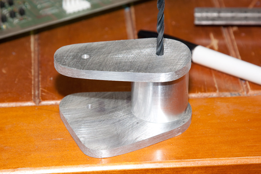

Well, I got my new inverter hooked up tonight and chucked up my first piece of this tonearm!! It was only one quick bit though..... barely started!

Well, I'm not committed to anything - I can use any geometry. In fact I wouldn't mind trying something other than the Rega sizes, just to make it different.
So any measurements still greatly appreciated!!
In the meantime I bored out the arm wand today (cocobolo). That will go inside now for a few weeks to let it completely stabilise. I also prepared the metal for the main body. I need another bit for the lathe to do the stub of the arm.
Pic of progress so far:
