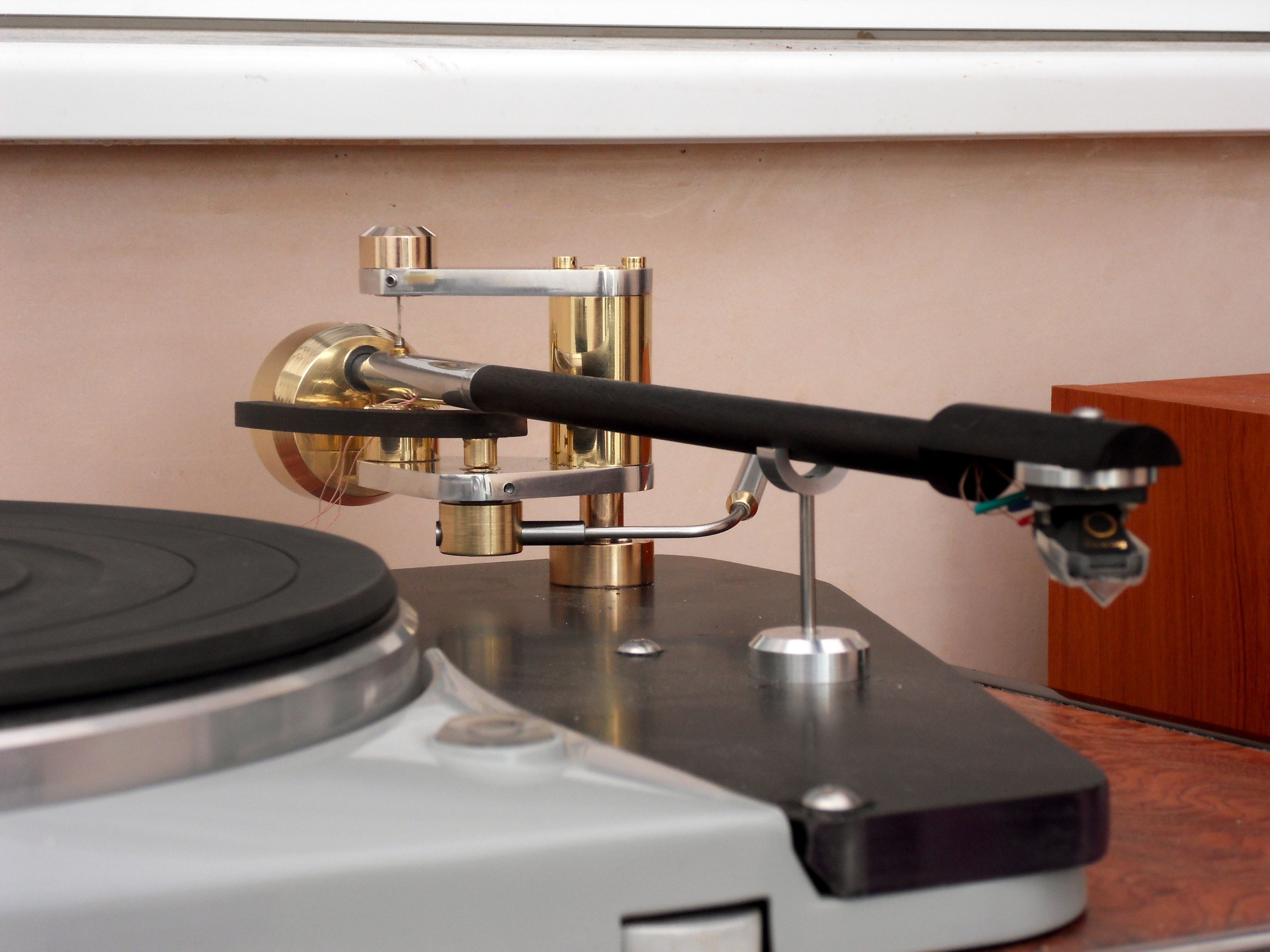

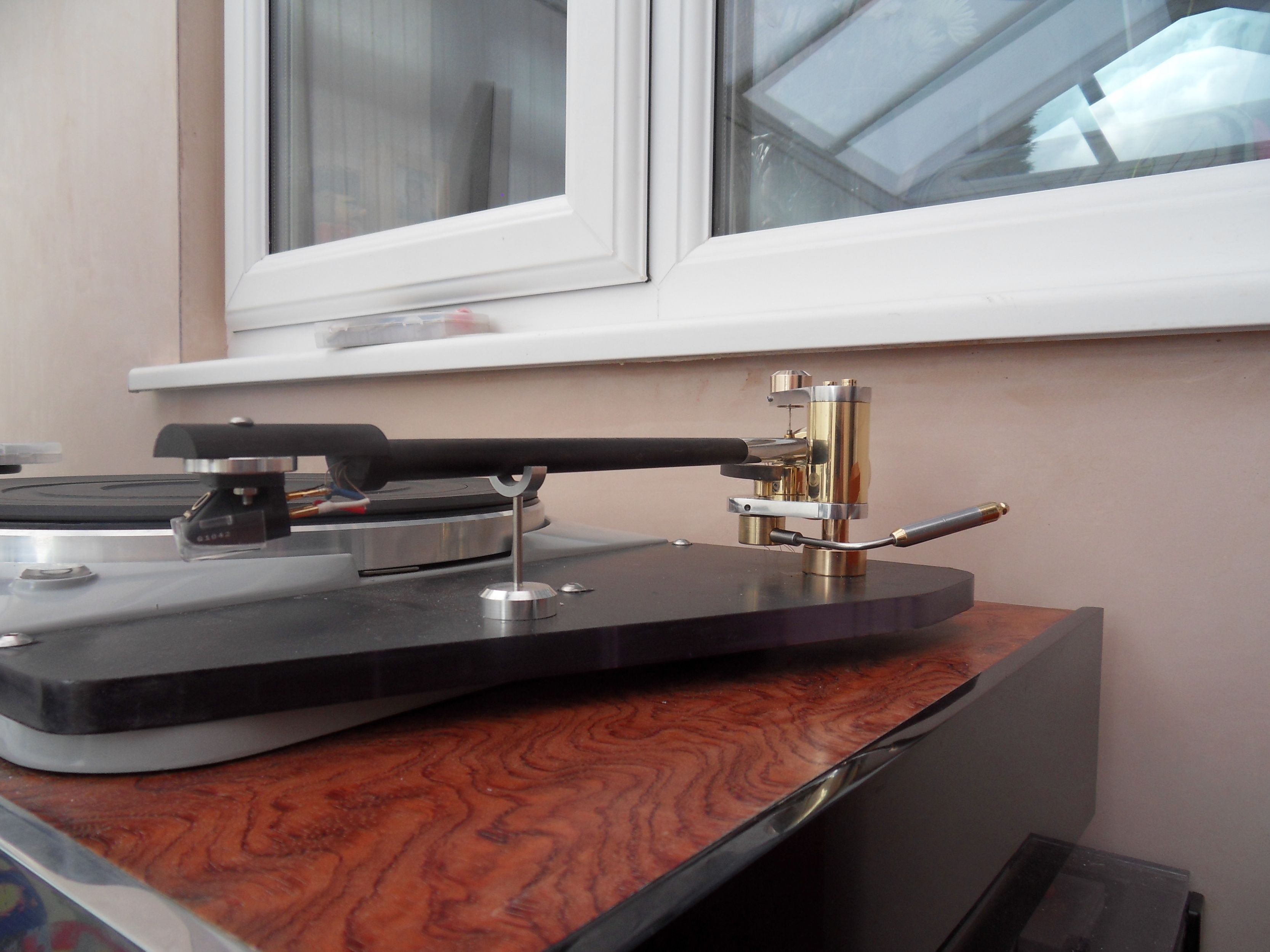

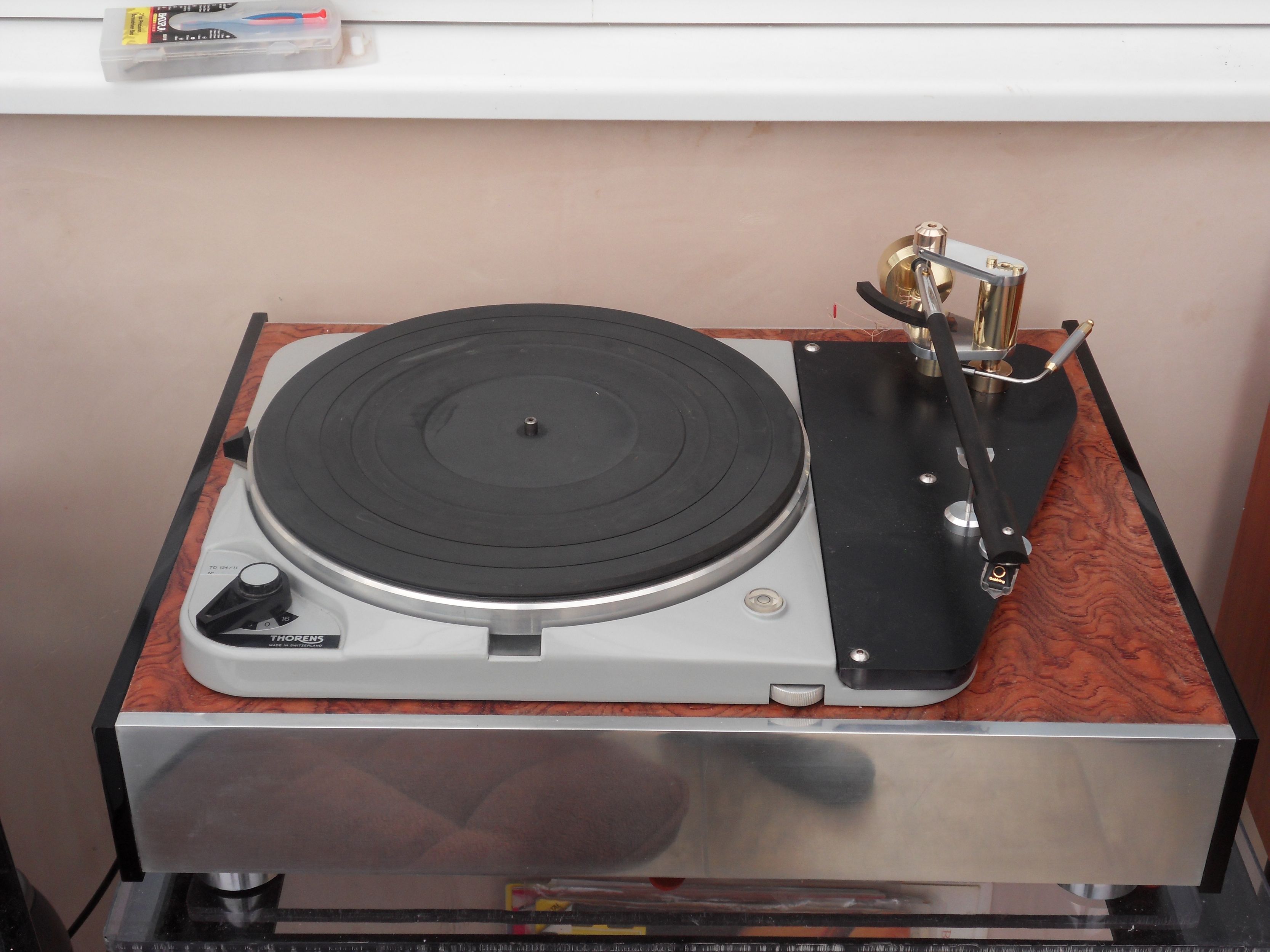

hi i'm a new lad here. i would like to show you my schroeder clone that i have almost completed. i am about to rewire it and make a new arm board. all my own work sounds great to with a G1042.
schroeder clone

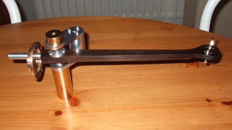

hi bins and all of you, the tone arm lifter spindle was made in three parts on the lathe and it is basically a cam action which pushes the verticle spindle up it must be done to close tolerances to keep any play to a minimum. i reamed my holes to ensure this.here are a couple of pictures. i've still got a few jobs until i'm completely happy with it. it sounds fab. with a bow to herr Schroeder. regards Sean

Very nice work, Sean! What species of wood did you use for the tone arm? Were you able to drill the arm with a long bit or is the arm laminated?
Great looking tonearm, seanb!
A few questions: what is the turntable your're using? (btw, the plynth looks great too). And what are the dimensions of the tonearm?
hi all, the arm is ebony. For the hole down the centre i cut it in half down the centre then put a small groove down both sides with a router before gluing it back together. After the glue had set i put a long drill down it to clear any glue out. it worked well.Having a hole either side allowed me to turn it between centres on the lathe.The effective length of the arm (pivot to stylus tip) is 285 mm and the turntable is a Thorens td-124 series 2. nice to hear from you and best wishes Sean

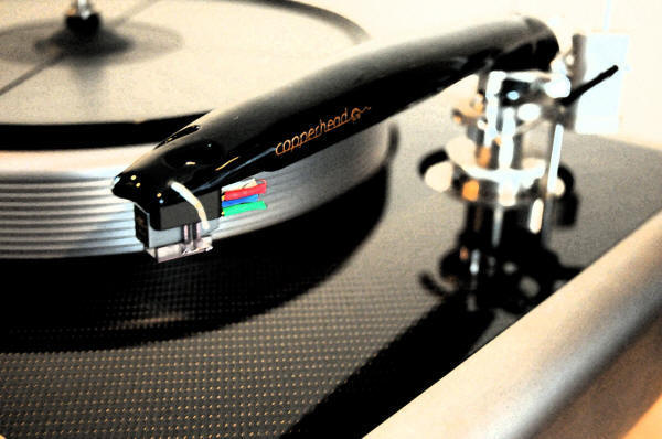

Truth is, if I think it somehow degrades the sound then I can always knock up another armtube. I have some more cocobolo, african blackwood, ebony, pau amarelllo and box here. All of those should sound excellent I think. The other thing I thought of doing was to make the armtube thicker in the middle. I understand that the high end copperhead tonearm does this and they reckon its a benefit.
