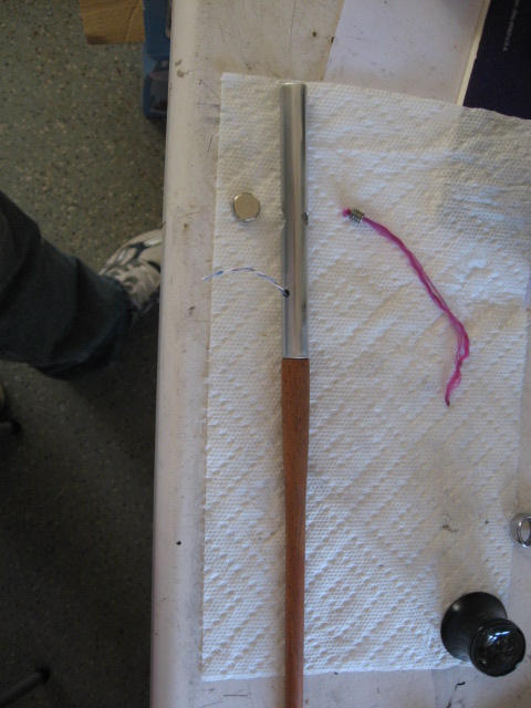

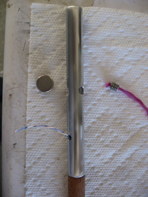

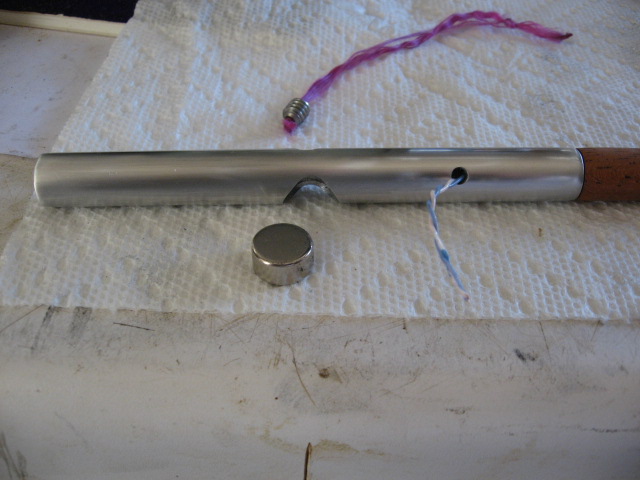

And it was going so well too. 🙁 While trying to press-fit the N48 magnet in the tonearm wand section it cracked. I removed too much of the inner wall trying to align it perfectly. It is harder than it looks to drill a hole straight through the diameter of a tube, I was off just a "RCH" and was never able to center it up perfectly. Oh Well, good excuse to make another one, now that I have some experience! 🙄

Too bad, one more instance of being close to a RCH that doesn't work out well 😀And it was going so well too. 🙁 While trying to press-fit the N48 magnet in the tonearm wand section it cracked. I removed too much of the inner wall trying to align it perfectly. It is harder than it looks to drill a hole straight through the diameter of a tube, I was off just a "RCH" and was never able to center it up perfectly. Oh Well, good excuse to make another one, now that I have some experience! 🙄
Ron
What size and wall thickness tube are you using? Another question, if you don't mind: What size and strength are the magnets?

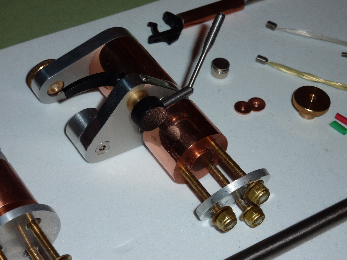

OK, emmm, back on topic. I'm trying to understand the VTA adjustment on your implementation of the reference arm. Is the center rod is hard mounted (attached by grub screw?) to the lower tower over which the upper tower slides? Which is then adjusted by an internal long allen set screw which pushes down on the rod from threads on the upper tower? I see that you also have included a keyway in your design that was mentioned as missing in a different thread from the original design. Is that correct? If so, good idea! It was mentioned that adjusting the VTA may change the overhang on Franks commercial product, your inclusion of the keyway would prevent that. If I see it correctly.
Does the arm lifting device provide enough vertical travel? I'm looking at one on FleaBay for $50. Jelco JL-45. JELCO JL-45 CUEING DEVICE(LIFT/LOWER) - eBay (item 300414166685 end time May-03-10 21:00:45 PDT)

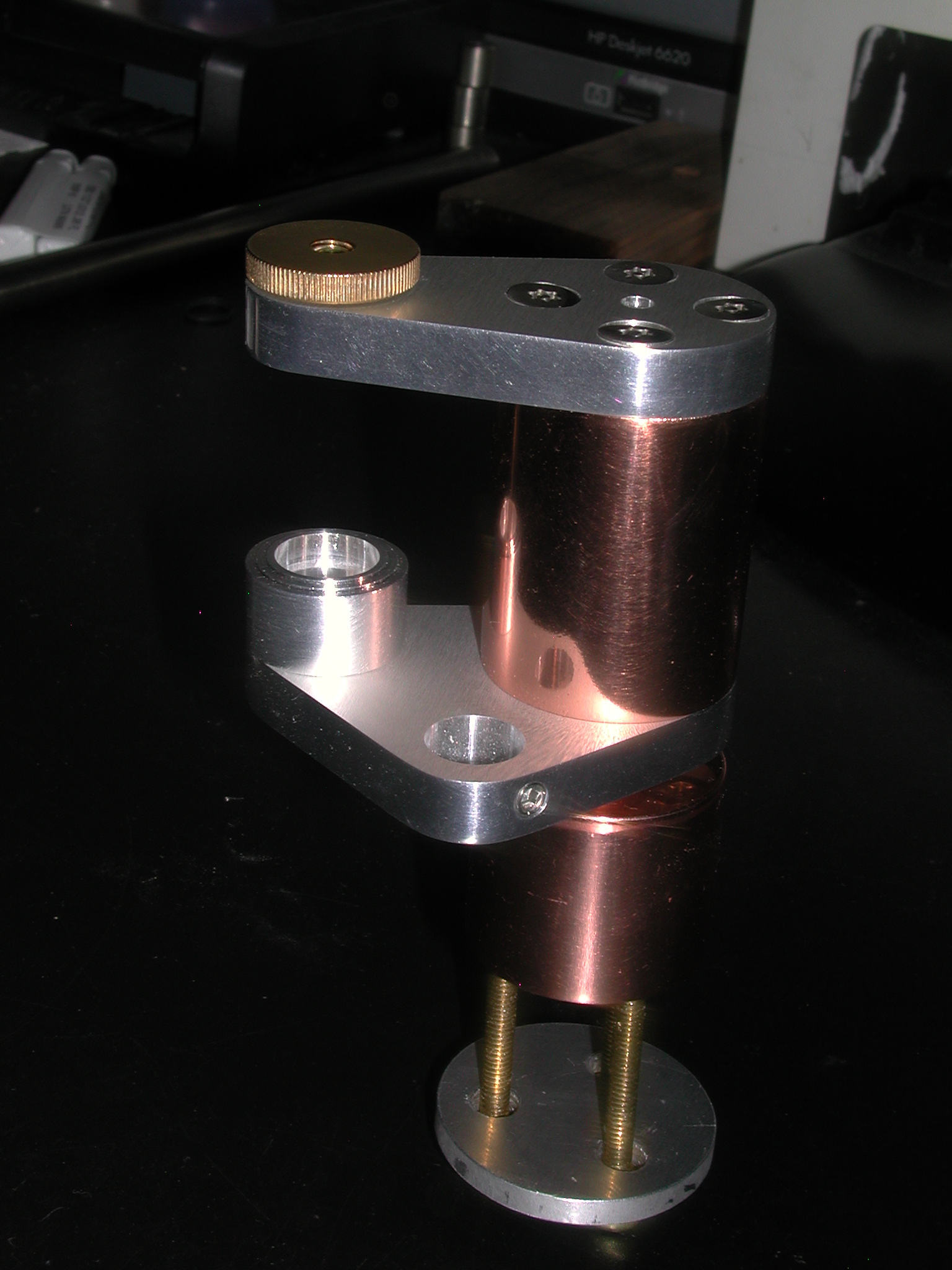

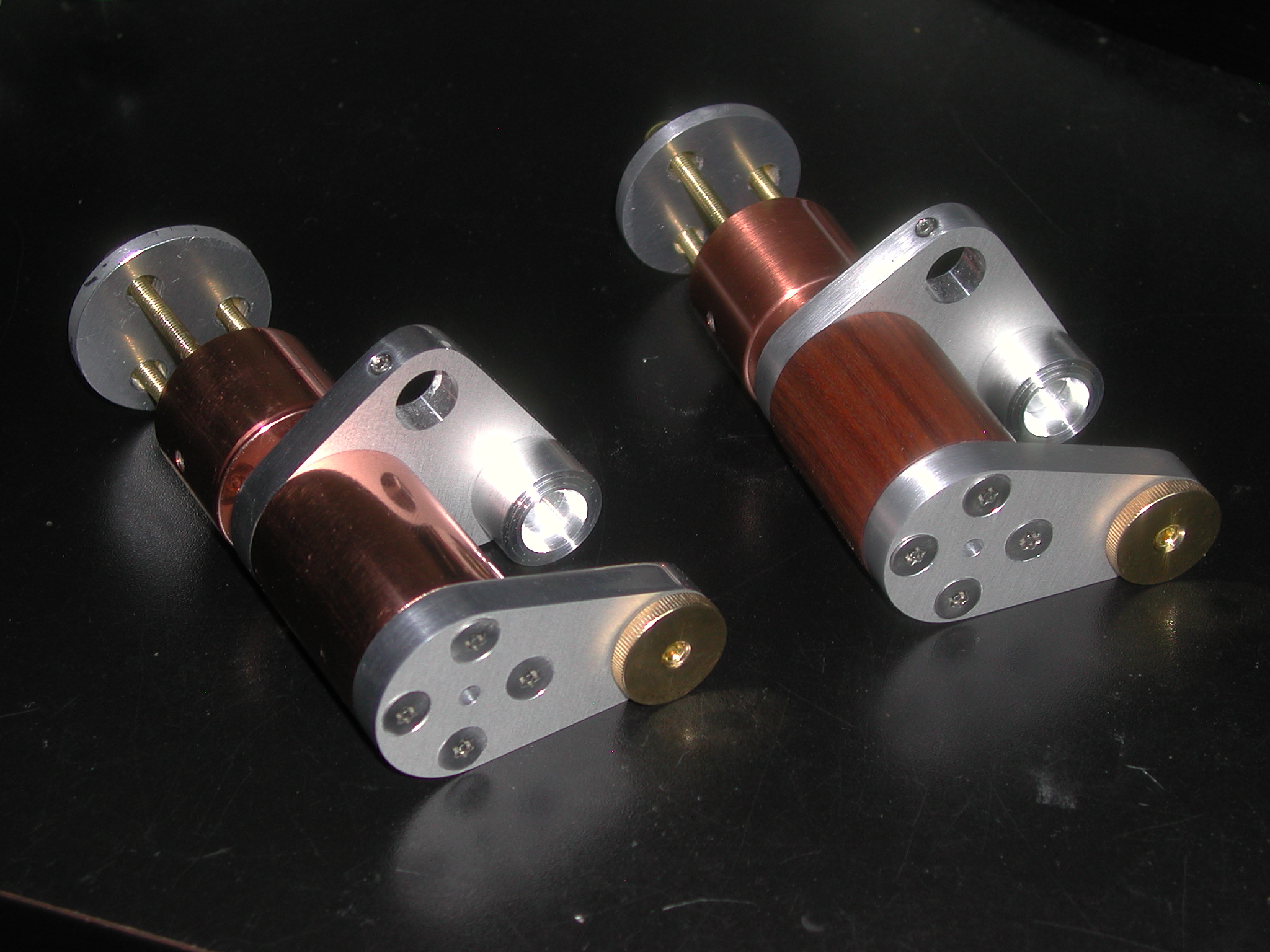

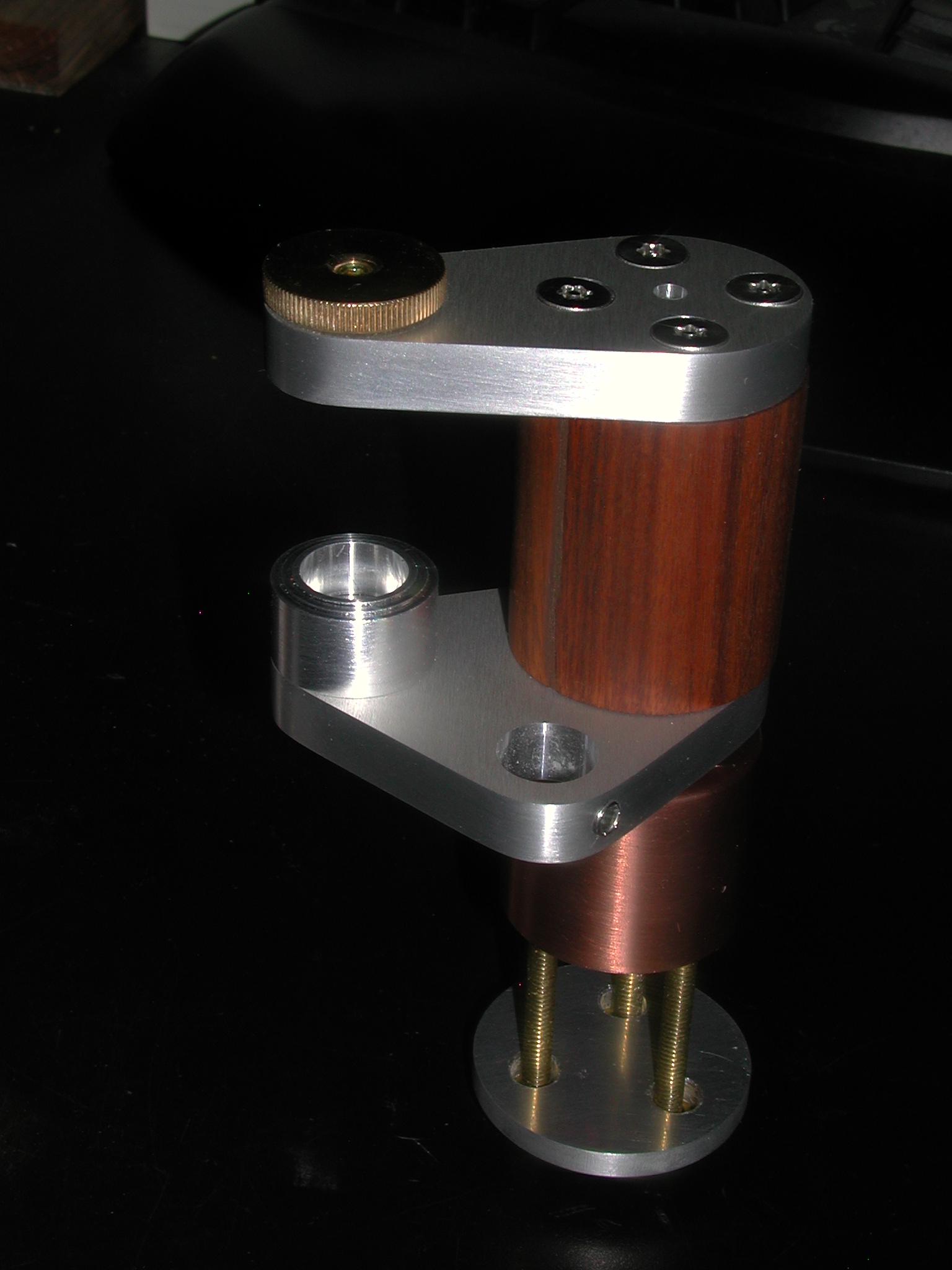

vta adjustment....
there is a central rod that is inside the base and the top main body.
at the bottom of that rod is a groove that runs around the circumference that is captured, held in place and locked byt the set screw in the base.
on top of that central rod is a threaded hole, and in that threaded hole is a captured hex head machine screw. The top plate has a central hole directly over that machine screw to accsess it with a hex wrench.
The central body has a land area that the screw works against so that by rotating the screw the assembly raises or lowers, while the central rod stays stationary locked to the base..

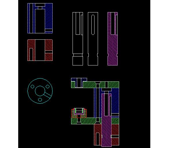

I can post a cut-a-way without dimensions for better explaination, provided that it would be allowed by Frank (even tho this is not part of his patent)

Westend,
Oops, sorry, forgot to answer the other questions;
Magnets are N48 1/2 diameter x 1/4 thick, shocking how strong they are for being such little buggers.
I reshaped my armwand, and got lucky and found a way that works great to drill the hole for the magnet. At first I used a set of drill bits but found it hard to center exactly. Very frustrating. 3 pipes later I tried just using a 1/2" counter sink bit, Voila, the clouds parted, sun came out, and the birds began to sing. Perfect hole. Yahoo! Sometimes we just stumble onto something that works. (I got lucky)
The string is just for trial purposes. Not what I will use in final build.

The vertical "key way" on the internal support rod serves two fuctions:
1, it limits rotation of the arm, thereby not effecting overhang ( other than changing the geometry of the triangle formed by the arm at stylus to top of assembly, the stylus to assembly (at platter height) and the height of the assebly. If you change the VTA, you are changing the Hypontenuse (?) of the right triangle formed so the arm may need to be rotated to get the correct pivot to spindel distance, etc..
2, it also serves as a limit to the total up and down height (once the set screw in th main body is loosened (unlocked) when the VTA internal adjust ment screw is rotated.

Hi guys,
Yup, the central hard brass shaft or post has a V-shaped groove running from its top down to slightly below the point where the upper grub screw is sitting when the base is fully "down". When you unscrew this grub screw, you can raise or lower the upper part of the base(the "gallows") via the cylinder head Allen screw in the central shaft, accessible through the top "gallows" plate(JD described the principle very well). After unscrewing the grub screw you could turn the gallows ever so slightly, but once tightened again, the overhang setting is restored. As with nearly all tonearms(the Eminent ETII is a rare exception) one needs to reset overhang after altering VTA by more than 3mm (typically).
In some of the early prototypes, I was using a polished guide pin(connecting top and bottom base cylinders) to allow for VTA "on the fly" adjustment(not recommended with the configuration above), but that complicated the manufacturing, doesn't sound any better and is prone to be screwed up by those customers who feel they need to disassemble every piece of audio gear they can get their hands on.
Try drilling the hole for the magnet in a lathe... much easier to get it centered perfectly !

Frank,
May I post a low res cut-a-way drawing?

Frank and Jeff,
YOU GUYS ROCK!!!
Frank,
Thank you for allowing Jeff to share those wonderful cut-aways with the rest of us DIYers. Your years of trial and error, not to mention the $$$ you've invested in prototypes and advertising are truly appreciated by those of us who can only afford the DIY route. Thank you for helping us with the technical aspects of your design and the complexity of it's details. If I had a lathe I would use it
