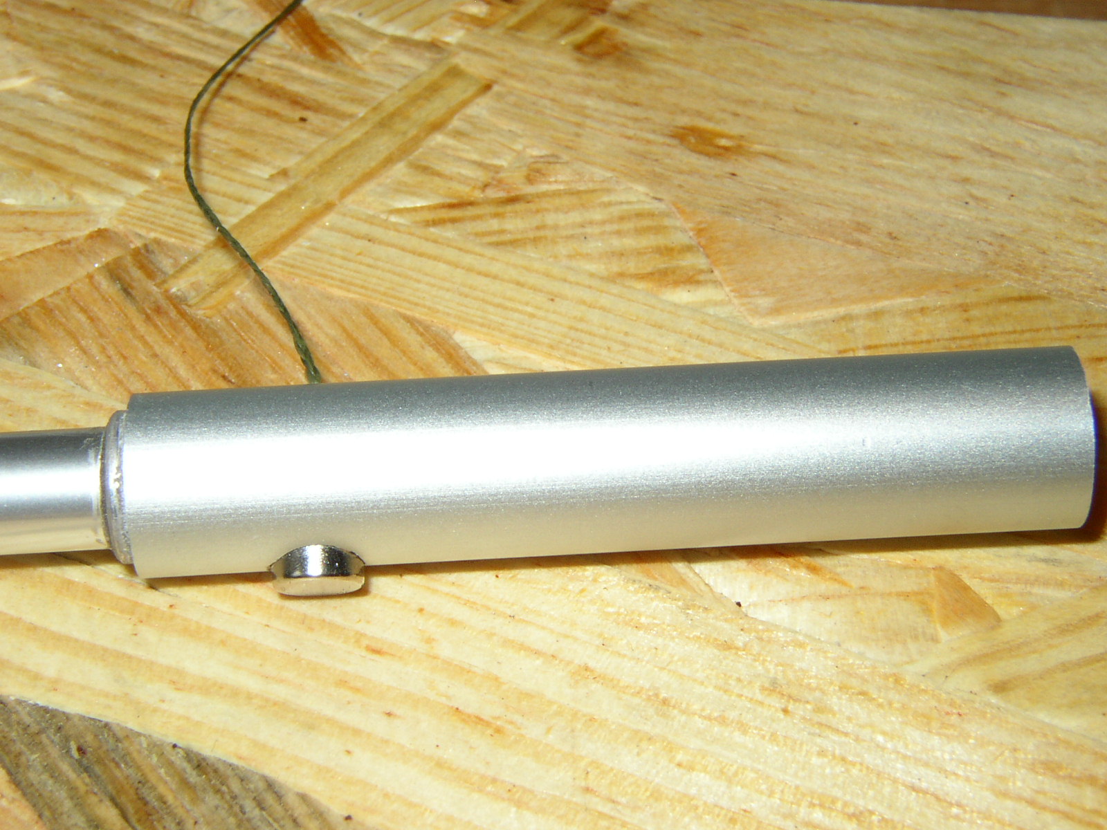

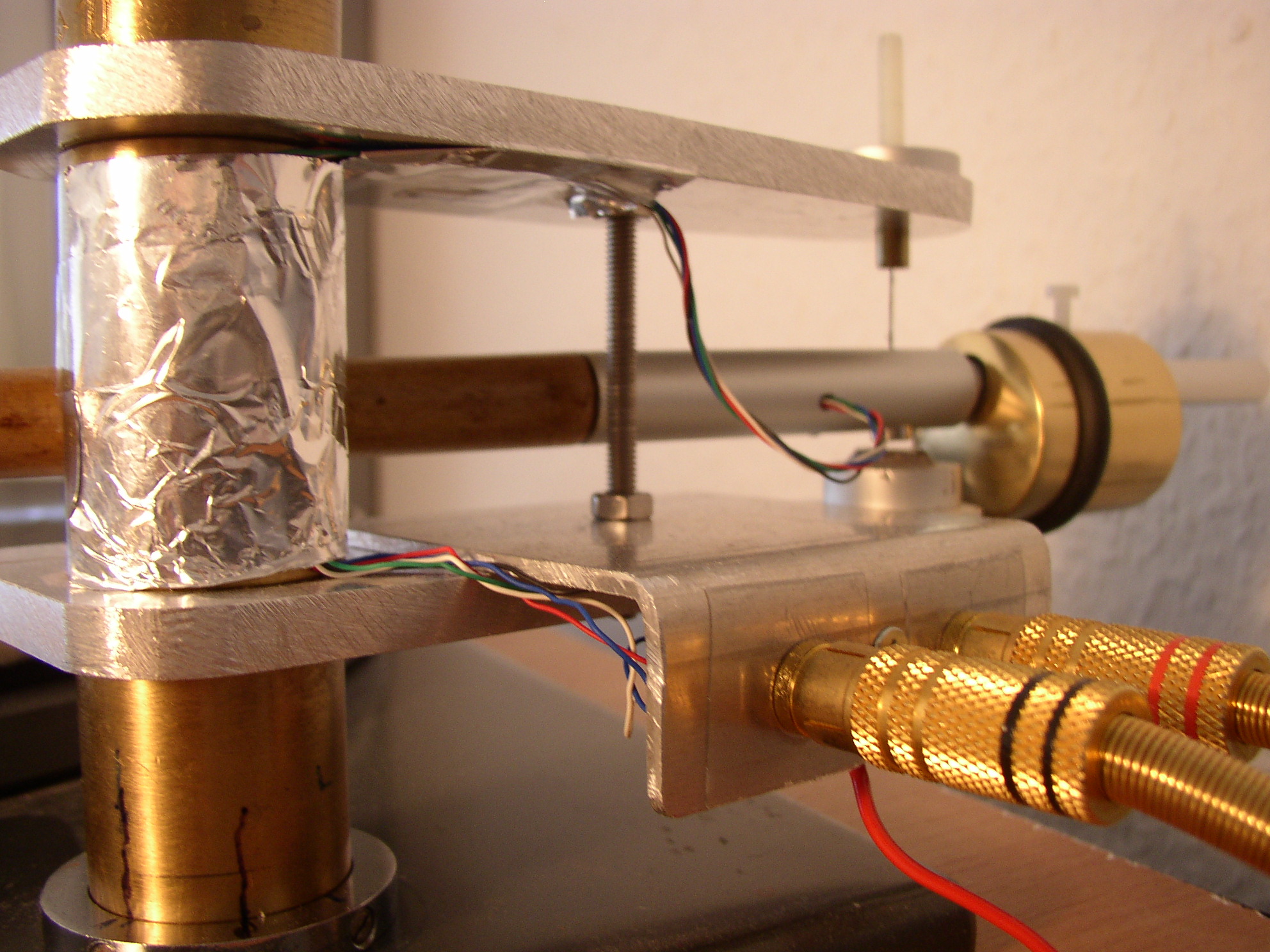

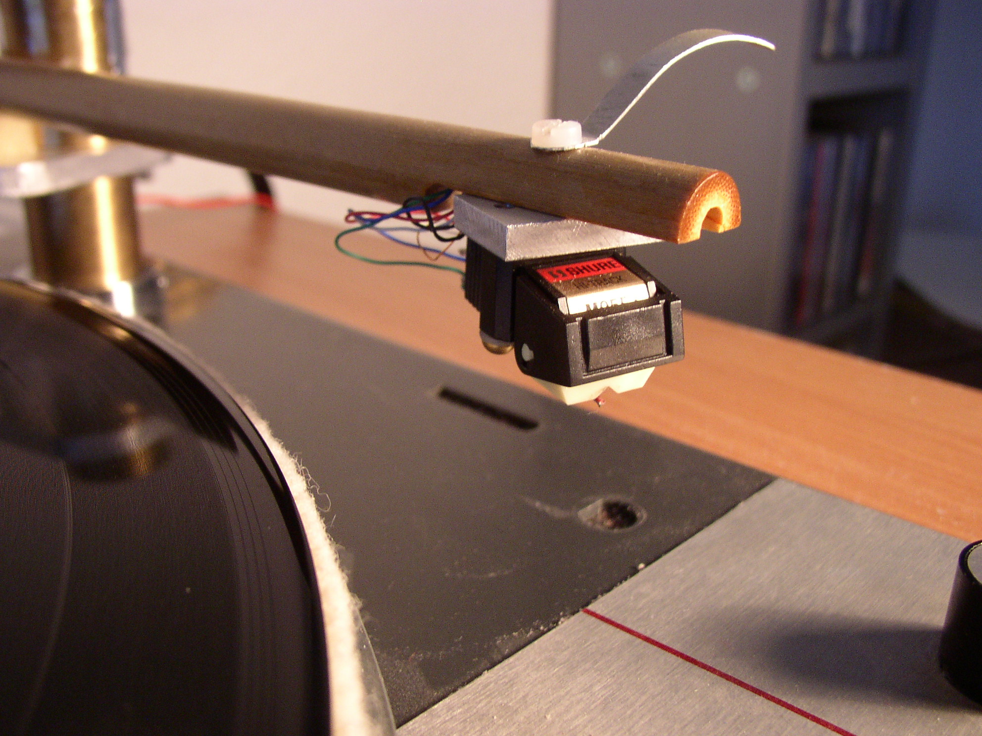

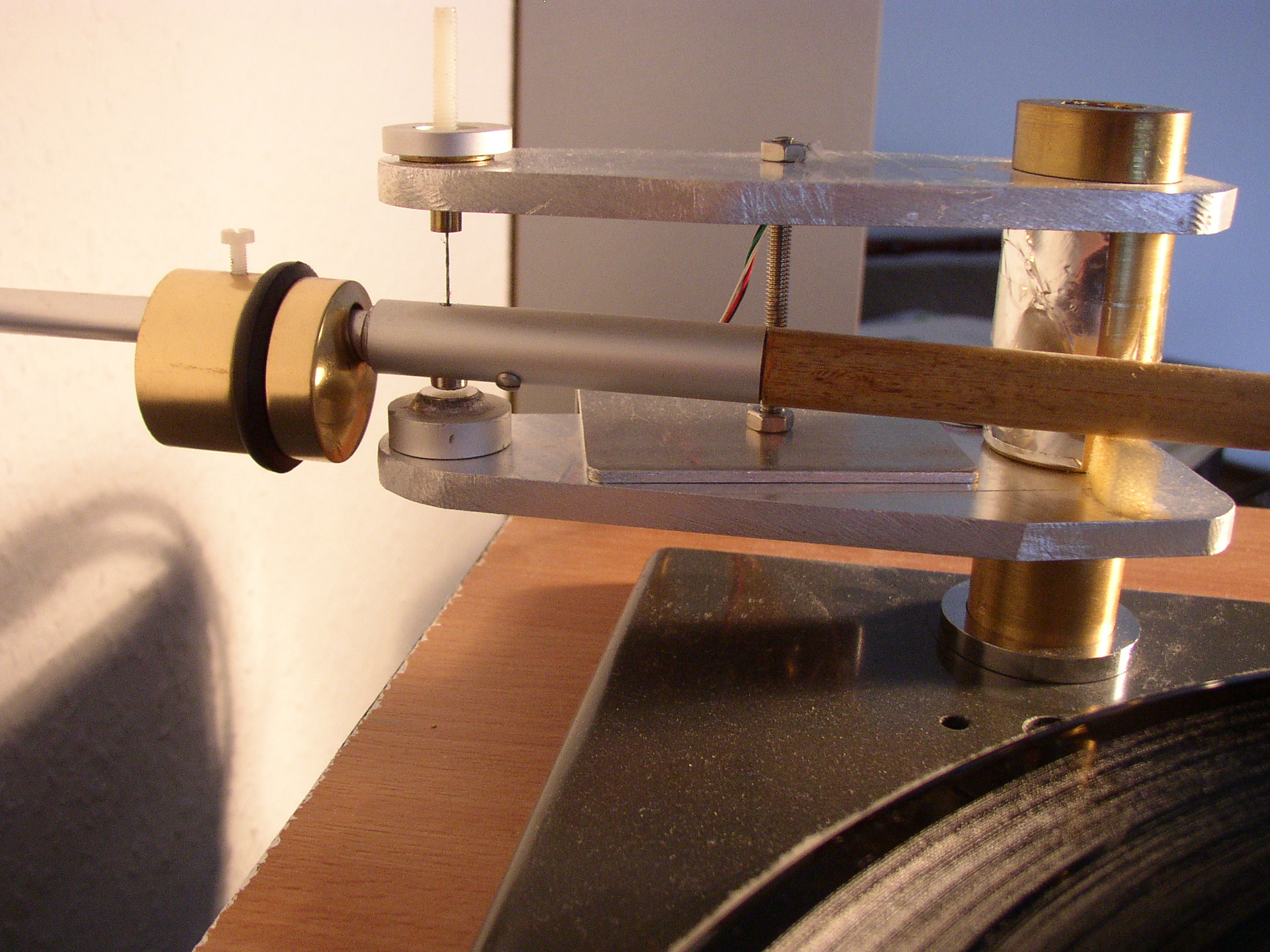

Another homemade DIY Schroeder...
Some 3 years ago, I also discovered the Schroeder tonearm, and was fascinated by its (deceiving) simplicity and the brilliant solution of the combined string and magnetic suspension. At the time, I had just rebuilt a Lenco turntable and equipped it with a Rega RB250 tonearm. It worked beautiful, much better than other turntables that I owned (Thorens TD166, Dual 506, Luxman PD282). Of course the project of building a clone of the Schroeder tonearm came in view. The Schroeder Reference looked beautiful (it still looks fantastic!), and especially attractive to me, seeming somewhat simpler to build. So I took an image of it and enlarged it to 1:1 scale, to be able to estimate the different sizes. Not having my own workshop or special tools, I searched primarily for ready-made pieces that could be easily adapted to my project.
I decided to use the original mounting hole of the Lenco for the arm, as it allowed for the VTA adjustment. For the length of the tonearm, I chose 10.5", based on different information gathered on the net. I made a sketch of the overall geometry of the arm and the turntable, to make shure it all fits. I will not go through all the details of building the tonearm, but there are some things which I found to work well and thought I should share in this thread. I also have some photos to show the overall construction and some details.
The armwand is build of bamboo. An obvious advantage is the already-drilled hole. Another thing which I thought good for the damping of the tonearm is the density of the bamboo - very hard on the surface and softer towards the center. I picked a well-dried bamboo rod about 12mm outer diameter and 4mm inner diameter, which I adjusted at one end and pressed in a 12 mm aluminium tube. I did not oil the bamboo rod, just laquered it for moist resistance.
In the aluminium part a 5mm diameter Neodym magnet is simply press-fixed. On it I glued (2 components polymer glue) the string, which comes out through a 3mm hole in the arm. The opposite magnet (fixed on the lower support plate) is larger, 10mm in diameter, which allows for an increased attraction force. On the open end of the aluminium tube another smaller tube is fixed, supporting the counterweight. I found the string in a fishing shop, it's used for trout fishing.
The couterweight is made from brass, in fact it's a door stopper which I just drilled through so that it can fit on the arm. The door stopper had also a rubber gromet, I left it on, it could influence positively the vibration absorbtion.
The tonearm shaft is also made of brass, in fact there are 3 plumbery fittings screwed together. I reduced the diameter of the bottom piece to fit exactly in the original Lenco hole. The two supporting plates are 5mm Al sandwitched between the pole pieces. Since the support plates are 100mm long, I introduced an additional screw in their middle to tighten them together and increase rigidity.
For different fixations (counterweight, string, cartridge mounting piece) I used nylon screws. They are easy to process and are non-magnetic.
All parameters (VTA, anti-skating, azimuth) are adjustable, much like on the original Schroeder. With the final version of the tonearm as presented above, all settings correctly made, the sound is excellent: natural, dynamic, reduced disc noise and distortion on inner grooves. I tested it with the following cartidges: Shure M95, AT 440MLa, Nagaoka OS300, Denon DL103.
