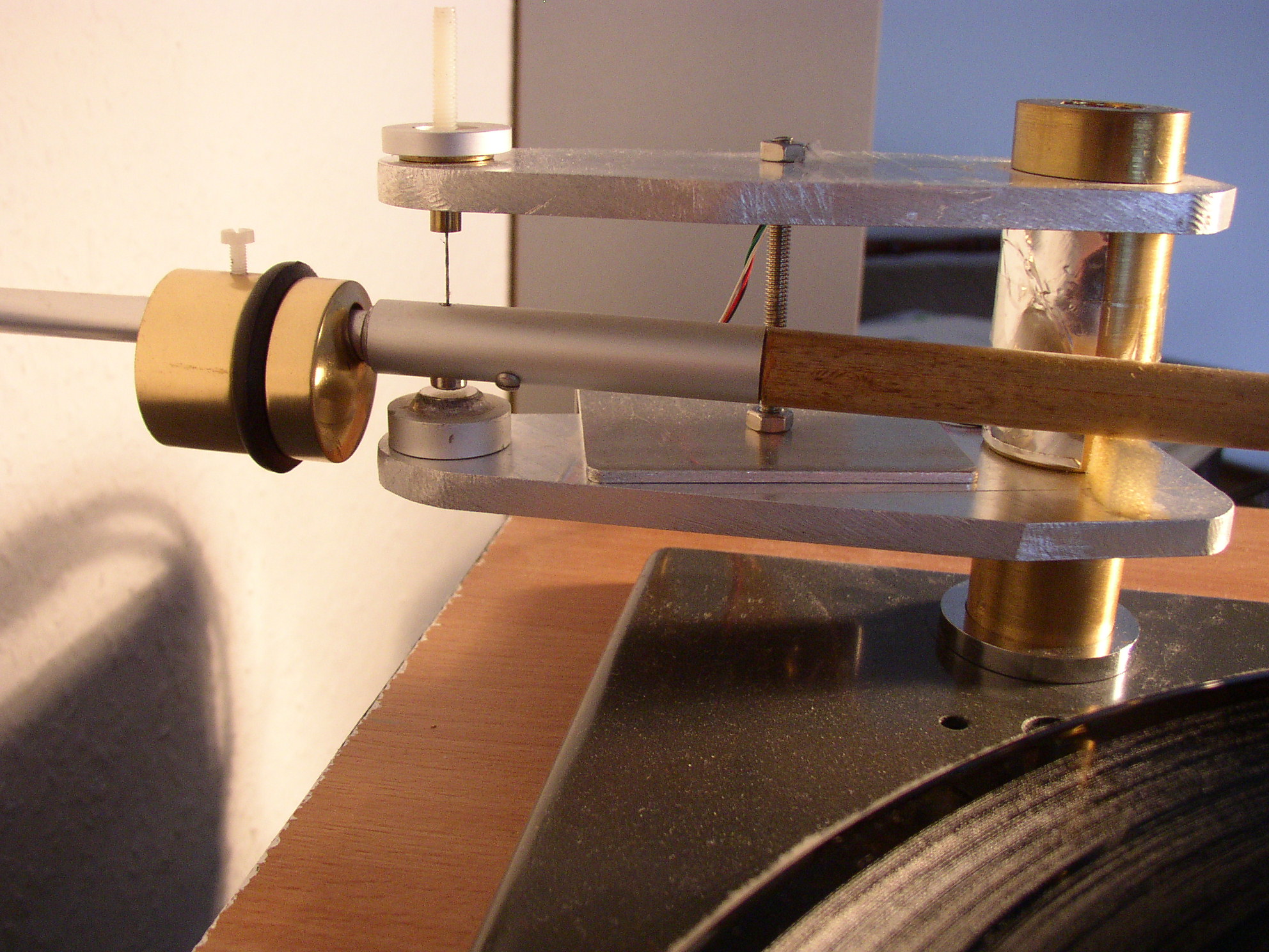

Dene001,
Thanks for posting the pics of your version of Franks brilliant idea. A little rough around the edges perhaps but I'm thrilled to hear that it sounds great! I'm still drawing out parts and understanding arm length and geometry. Hope to share some pics in the future.
Ron

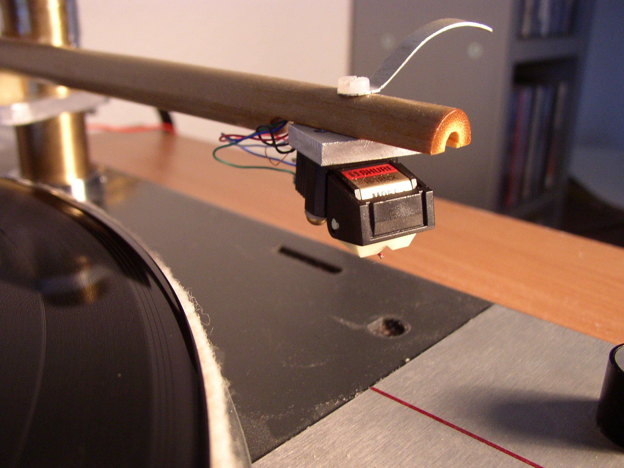

Yes, my Schroeder DIY is a little rough, most of the work was made on my kitchen table 🙂) As I said, I picked up many ready-made parts for building it.
Anyway, thanks for your acknowledgement. And it sounds great, some choices in my tonearm made a big difference. The bamboo armwand for one (btw, I wonder why bamboo is not used more often by the DIY-ers). I have tried with another wood essence (beech), oil treated, and the result was dissapointing - thin, coloured sound. The counterweight is also fundamental; have tried with the (lighter) original Lenco counterweight and the lower bass range (wihere the fundamentals are) loose precision. Also (as Frank Schroeder mentioned), the way you tighten the counterweight is important - also affecting the bass response. On my arm, the tightening screw is made of nylon, allowing for some softness and damping, I found it better than the metal version.
It's a lot of experimenting, and adjusting all the parameters can be lenghty, but you get fantastic sound even with low budget cartridges.
I wish you have soon your Schroeder DIY version, so that you can enjoy it playing!!

The bamboo is only lacquered on the surface, not inside - nothing else. But I take it that some bamboo rods are better than others, so selection is important. Here's one photo where the different densities are visible - dark and solid on the outside, lighter on the inside.
Regarding the counterweight and the tightening screw, my remarks are essentially coming from trials. At first I used the Lenco counterweight with it's own metal tightening screw , then I made the brass one, using both a brass and a nylon screw for tightening. I also used some damping between the counterweight and the shaft (soft rubber). Best tresults (to my taste) are with no damping and the nylon screw rather firm tightening: bass is firm and "bouncy" but explores well the lower part, and I can easily follow the bass line in the song.
Dan
Dene001,
I applaud your accomplishments!
Thanks for sharing those last few photos. I would agree that the dual density of bamboo should provide some natural dampening. I don't understand how different types of materials used in screws can effect the frequency response, I DO believe you, it just seems weird.
I have not had the courage to start building my tonearm yet. 😱 Perhaps I'll found out myself.

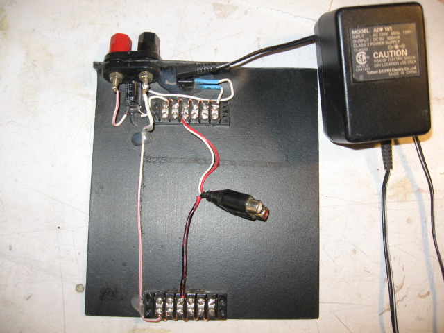

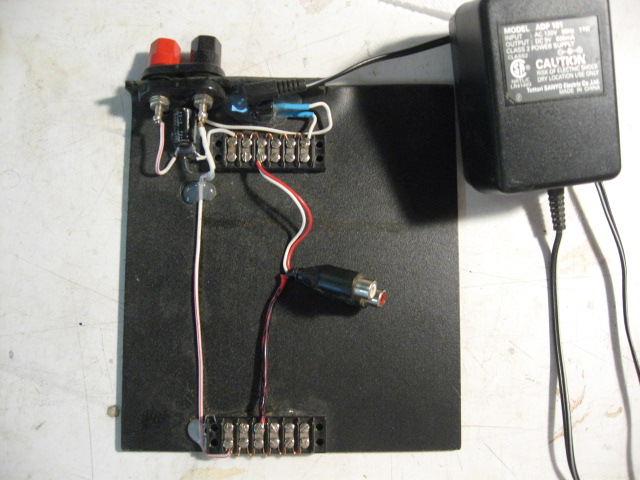

I wish there was some device to burn in a tonearmwire. I have a DIY cable burning machine which I assembled. The basic design and main board is from Hawaii( I am forgetting name of the company, which makes Phono amplifier also). But their is no provision for Tonearm cable burning and no sockets or pins to attach tonearmwire. Can you suggest. How do you burn a Capacitor ?
SKR
SKR,
I built a device, from the junk parts bin. We all have at least one! 🙂
It is a small wall wart transformer (forgot the voltage), but it's also hooked up to the speaker outputs of a junker radio. I left it on for a week to burn in my Xover caps for my Thor speakers. If you want the details I'll dig it up and post build details later. Let me know.
Any ideas on how to measure the mass of a DIY Schroeder style tonearm?
I started working on the wooden arm today.🙂 Fun!
Ron
Ron

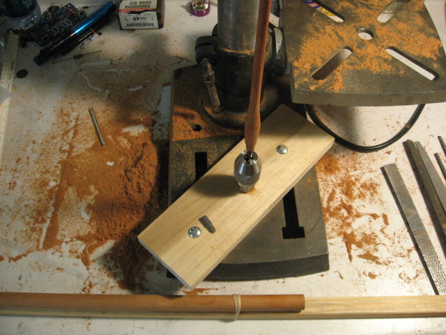

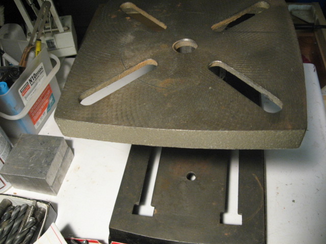

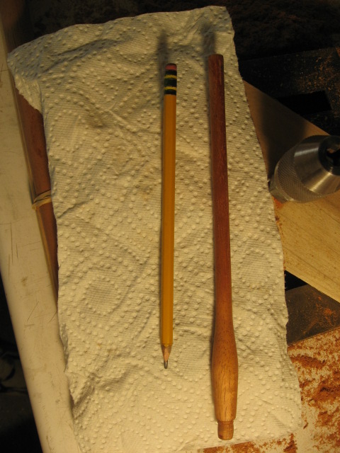

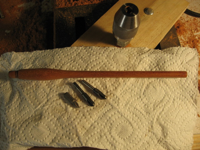

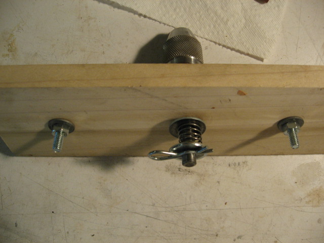

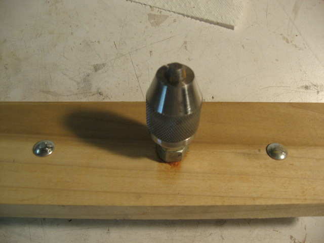

I don't own a lathe and frankly can't afford one, but I do own a drill press. Not a great one but it works. Only Ryobi tool I own, most others are Bosch.
I modified my Drill press by installing a "live" center in the bottom cast iron plate. It is spring loaded underneath to help keep it turning smoothly.
I started with a 3/4" mahogany dowel and drilled a 1/8" hole through the middle of a 10" piece. I used a 6" bit and drilled from both sides. It came out pretty close for a first effort. I think I can run the wires later no problem.
I tried a Phillips screwdriver bit for the live center pivot first, it stripped out very quickly so I changed to a countersink bit, same as installed in the chuck to drive the spindle.
Rough cut files and later sandpaper works slowly but works fine. I now have a nice pile of sawdust on my workbench. The turned down end fits inside a 1/2" aluminum thick wall tube perfectly, it will be epoxied in later. Tung oil and mineral spirits mixed are soaking into the wood. I will finish cut it to length later.
Ron

Your "lathe" is brilliant and I'd like to set one up in my shop. Would you go into a little more detail on the live center? Is there a bearing? Is it something like a bolt shank turning in the wood base? Are you concerned about side thrust on the drill press bearing? I've noticed frequent out-of-round in dowelling. Was that the case with the mahogany and did it effect turning your arm?
SKR,
It is essentially a cable burner / capacitor burner, I"m thinking with a resistor in series it could be used for the minute tonearm wire burn in as well. (for those of us who believe in this black magic / snake oil stuff) 😉 Here's a photo or 2.
It gets the AC from an old (garage) receiver's "B" set speaker outputs. That way it can be left on all night and the "A" speakers could be set to mute. I set it to a FM music station. The 9V DC power supplies the higher Voltage to help "condition" the caps / cables. The cap is there to prevent DC from returning to the receiver. Upper bar is connected to the +DC and through a cap the +AC from the receiver, the lower bar is both -DC and AC. The pics should make it self explanatory.
Ron

Dtut,
Interesting Name.
I cannot take credit for it, I found it "on the net" somewhere. There was also a Live center made from a bicycle wheel hub. I think that might be a better solution as I had a slight bit of slop in the bearing / spindle connection that made it more difficult to obtain a round shape. Sometimes it would go out-of- round and I would have to sneak up on the high lobes by moving the rasp out far enough to only clip off the high spots / lobes. Not a huge deal in the overall time it took to make the arm wand, maybe 10 minutes more total. It took me about 5 hours to get to this profile from a 3/4" round stock. Time includes drilling the center first, I used that hole as a guide for centering the stock in my "lathe". The Redneck lathe worked remarkably well for what it was. Junk pile scraps. The chuck came off an old hand crank drill that was a POS from China and never worked even poorly, so it is in a better place now.
I found a $0.95 Brass bearing 3/4" long with shoulder at OSH (orchard supply hardware) kinda like a Home Despot or Lowes. Spring holds the chuck down and helps to prevents it from wandering. Moved the Drill press table out of the way and put in a long bit to find the bottom hole location. Mounted the chuck on the board and used carriage bolts to hold it down because that what I had that would fit. 😉
Worked slow and I'm happy with the results. Very shade tree mechanic / Redneck / trailer park compared to a real lathe, but as I said... it all came from the "Junk" drawer = Free!
Ron
Interesting Name.
Ron
