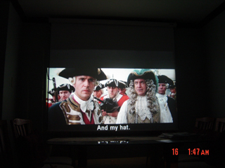

i NOTICED THAT ALSO. mAYBE i JUST GOT TOO EXCITED.
tHE LONGER I WATCHED THE MORE DISTRACTED I AM BECAUSE THERE IS A LOT OF STRAY LIGHT HITTING THE SCREEN AND DISTRACTED ALSO BY THE BRIGHT BLACK BARS. ITS ALSO VERY TIRING TO THE EYES.
CAN'T REALLY MAKE FULL EVALUATION IN A FEW HOURS. I HAVE TO RETURN IT TOMORROW.
I AM NOW WATCHING ON MY PJ, AND THIS HONESTLY I CAN TELL YOU. I AM MORE RELAXED BECAUSE BRIGHTNESS ON MY PJ IS JUST ENOUGH TO WATCH COMFORTABLY. SHARPNESS AND COLORS OF MY PJ IS MORE THAN I WISH FOR CONSIDERING A $500 BUDGET

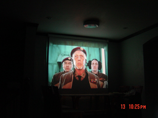

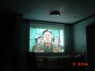

i actually like your diy projector better than the dlp..it's warmer..the colors look "richer" to me.. that is just my opinion..
and the brightness to me doesn't necessarily mean better as well- i wouldn't watch my projector with the lights on anyhow..

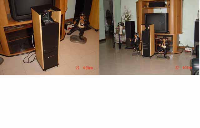

THANKS FOR YOUR SUGGESTIONS AND I THINK YOU ARE RIGHT. I BORE SO MANY SMALL HOLES IN MY PREVIOUS CABINET BEFORE NEAR THE LIGHT ENGINE SO THAT AIR IS COMING FROM BELOW GOING UP TO THE BACKSIDE THUS COOLING THE LIGHT ENGINE.
I BELIEVE THIS HAPPENED WHEN I CHANGED MY CABINET BECAUSE I DIDN'T NOTICED THE YELLOWING OF MY REFLECTOR BEFORE. NOW BELIEVE ME, AFTER POLISHING THE REFLECTOR IT TURNED YELLOW IN LESS THAN AN HOUR.
THANKS AGAIN. GOTTA BORE SOME HOLES NOW. I WILL KEEP YOU INFORMED.

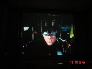

Anybody who has experience on chrome plating of reflector? I laways thought that i can still get significant brightness increase because i am using right now the cheapest soup ladle available in the store here. It is not a shiny as the most expensive one.
Any thoughts will be deeply appreciated.

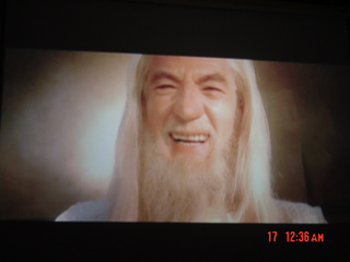

Yes my fresnel is warped because I don't use glasses to support my fresnel and protect my lcd.. A lot of guys may not like it because they may notice uneveness in image focus. But really I dont mind it because really it doesn't bother me as long as i have better color brightness and sharpness and acceptable lcd temp.
Aargh!!! by the way i replace my reflector with a better one because my reflector turned yellowish because of heat. Now i notice a considerable increase in brightness but i believe I lost considerable color vividness also. Can't show u some pics right now bec camera was barrowed yesterday.
Initially I thought that increase in brightness is the culprit in loss in color vividness but i need to consider one more variable. Right I am using a stainless soup ladle reflector, but before I really don't know the material. All I know is that it is much softer than stainless steel. I can puncture a hole using a nail and hammer in my previous reflector but I cannot puncture the stainless steel reflector. Can somebody tell me what possible material is it? Will aluminumm yellow under intense heat?

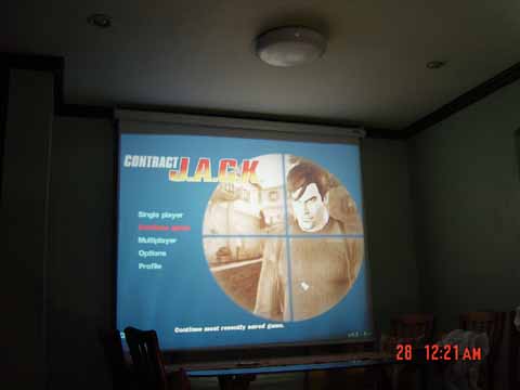

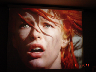

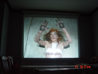

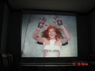

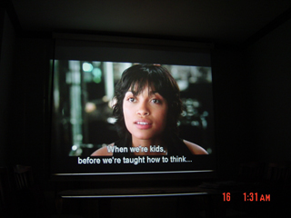

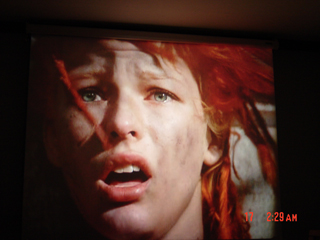

I review my comparison of dlp530 and my pj. Dlp 530 is sharper and brighter but take a look at color differences.
A lot of guys maybe right that brightness is not all that matters. Color must be well considered also atleast I can say it for my DIY projector.
