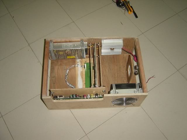

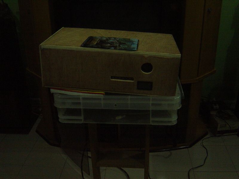

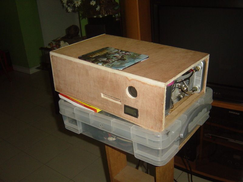

Reworked the box of 480p LCD w/ HDMi and Vga and installed 126w led. This by far the brightest projector I ever built. The LCD+controller is more transmissive than B101Ew05. Its water cooled. Hdmi+vga conections. The image is very bright at 120 inches diagonal!
Nothing change. Its the same old design.
Which Lcd this time.
The power supply is 24v but can be adjusted through its trimpot up to 30v. This a constant voltage source. The one installed in a heatsink on its right is the LM338k to make it a constant current source.
You can buy DC to DC Buck converter on ebay if you want to increase the voltage to 36v.
32-36v is for commercial led. I use custom designed led in which the voltage is 24v for 126w led and 28v for 128w led.

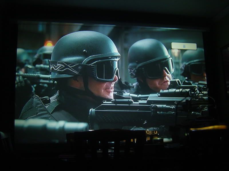

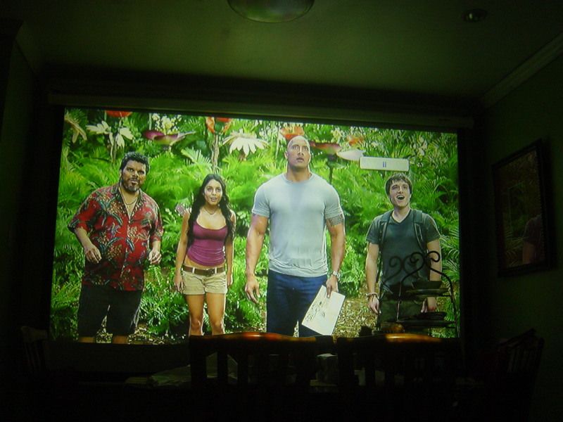

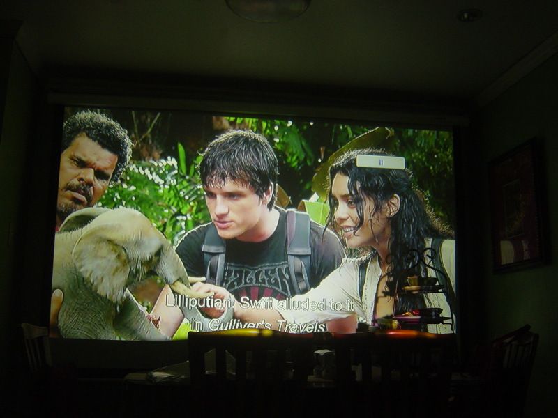

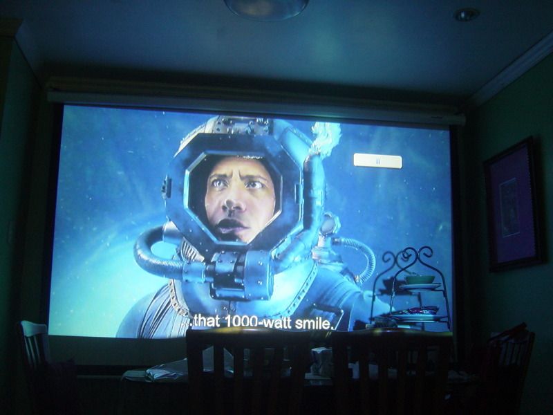

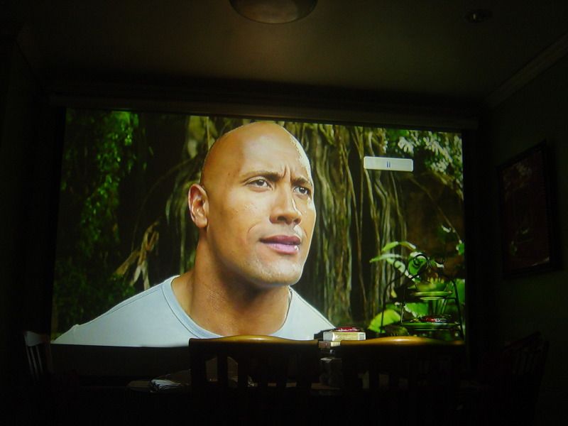

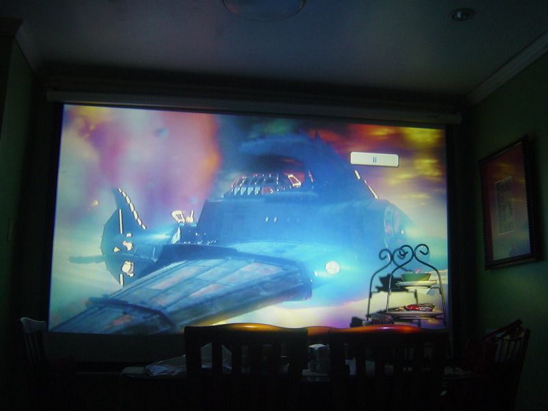

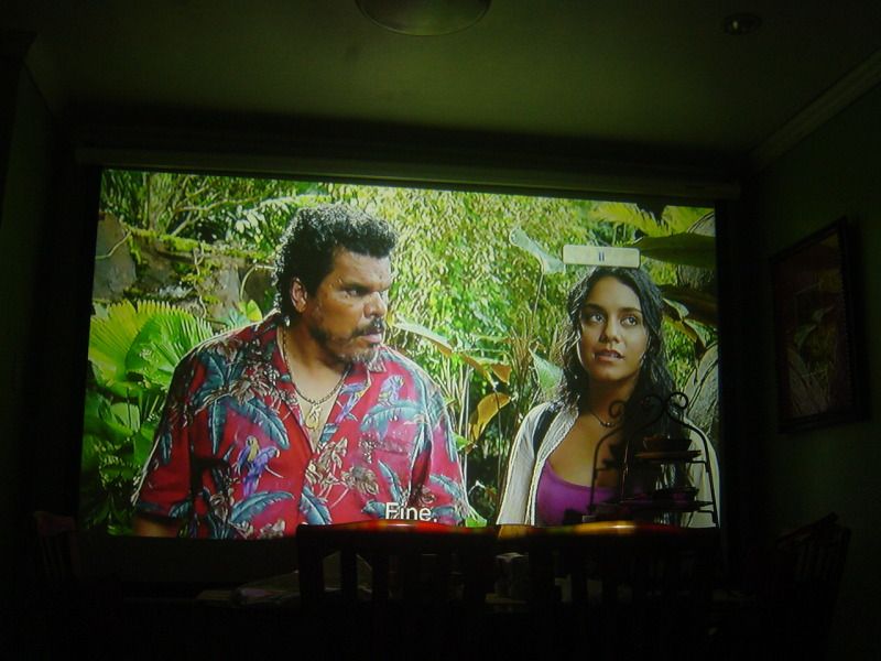

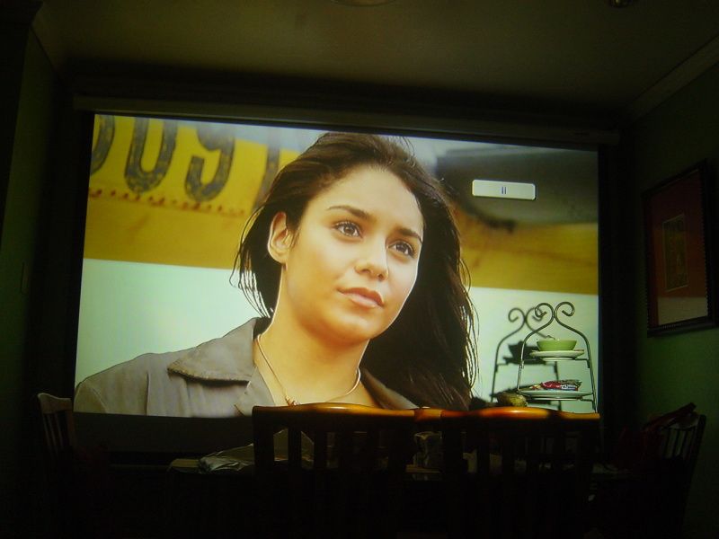

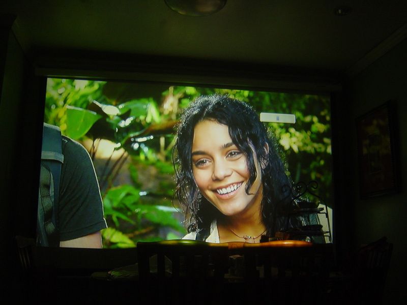

Men in Black 3 dvd- B101EW05 LCD + 126w LED + Aspheric lens.
The actual image is more saturated and contrast is much better. Black is blacker and white is whiter in actual.
I settled for DVDs instead of Bluray! Its already awesome on 10.1 inch 1280x800 lcd.
Bluray is fanastic but DVDs are alot cheaper . Sometimes I am having a second thought of trying 1080p LCD . This 1500 contrast is really very nice. If I opted for 1080p lcd, I will have to sacrifice the contrast though resolution is expectedly better.
Brightness is awesome! enjoyed this movie so much!
The hair in the images has bluish tint, but its solid black in actual.
Excellent results, very nice looking build! Are you going to paint the enclosure or stain it or leave it as is?
Box will stay that way.
