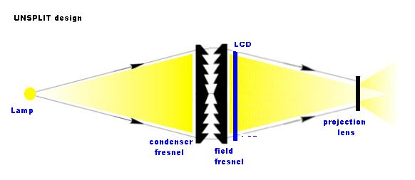

anyway Viki, for your satisfaction... i'm one of students of Sir Hertz (DIYPJPhils) and here's what u need to know:
Innolux 7 inch widescreen LCD Panel
Native Resolution: 800x480
Contrast: 500:1
Controller Inputs: VGA, Composite and S-Video
Projection lens 265 mm focal
Fresnel lens 220/120mm focal
We're using LED as of the moment... mine is 80W 32V@2.8Amps
I think this is the first Water Cooled LED projector.

BOE 1280x800
COntroller: HDMI/TUNER/Vga/Ypbpr/Svideo/Composite/Audio
LED: 128w 13,000 lumens. Customed designed with the manufacturer.
DIY led controller using LM338t
fresnel: 220/150 focal
aspheric condenser lens:75mm focal
projeciton lens: 265mm

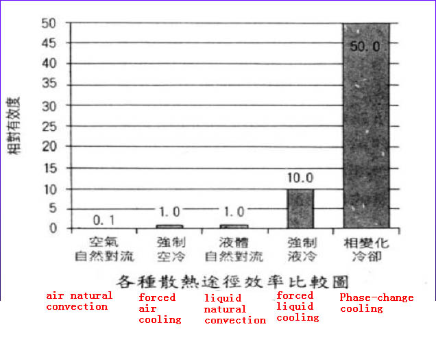

Water Cooling: 120x120mm aluminum radiator
diy aluminum water block
280L/hr submersibkle pump
Image is brighter than my 250w HSD bulb!

LG LP101WH2 1366x768 contrast 400 72w led
Comparing with my 7inch projector
Both are water cooled.
I will do the same box for 8.9 inch projector. So its gonna be smaller than the 10.1 inch projector./
