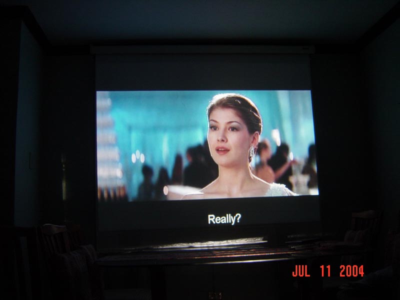

Based from what I saw, the liliput seems to have a wrong color tint. Its slightly greensh. i hope its just a camera problem
But i am not without problems. One is, i think i have to wait 1-1.5 hours to get full brightness from my light engine. I know i am using a cheaper ballast, capacitor ignitor set-up, I am now looking a cheap solution to this problem.

hi hertz,
looking better and better. nice to you see you using dual
condensers. they realy brighten things up stacked. but then
the focal shortens and they need to be right up to the bulb.
have you had any problems with heat?
great work, with the small lcd. keep those pics flowing.
