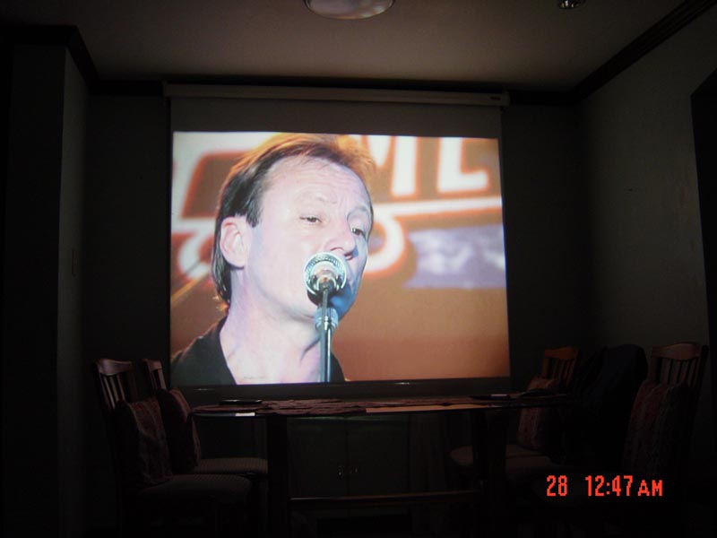

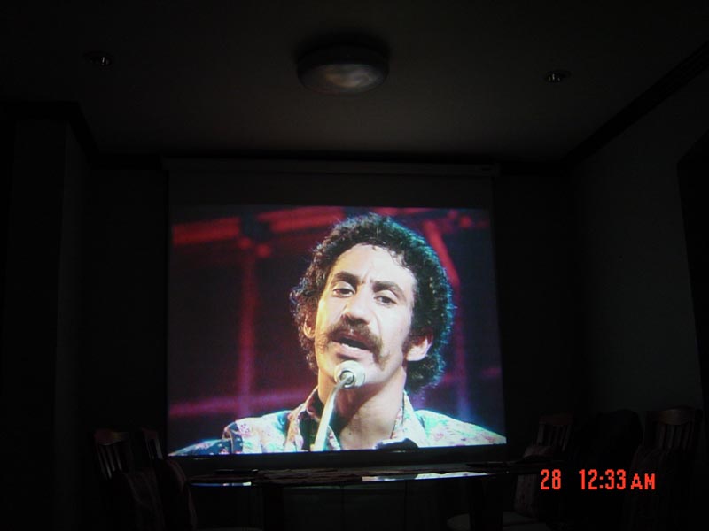

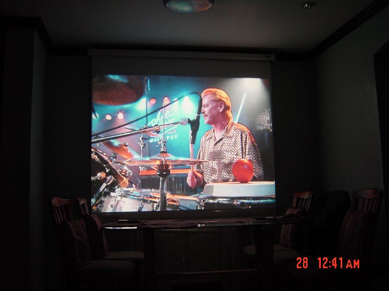

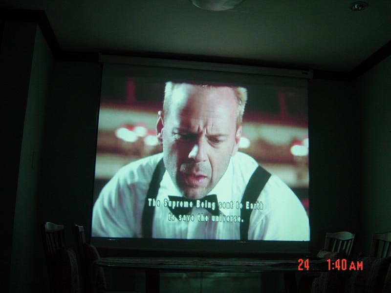

Anybody interested in HQI-TSD vs HQI-NDL projected image comparison? I am getting lazy now taking pictures but if there will be alot out there who is still deciding what color temp is the best before buying i can take lots of pictures tomorrow Saturday here.
BTW the last image I posted is using the HQI-TSD. The rest are all using HQI-NDL. I cannot compare now the quality with the image i posted before because my pj brightness is now even brighter than before because of the use of magnifying glass.
My initial results suggest the following.
HQI-NDL 1. white is white
2. Looks brighter
3. Color is lively but on the pale side.
4. More natural looking skin tone but a little in the pale side.
HQI-TSD
1. white is slightly green or sometimes slightly blue
2. Color is darker
3. Noticeable slightly green and slightly blue tint
4. Contrast looks better

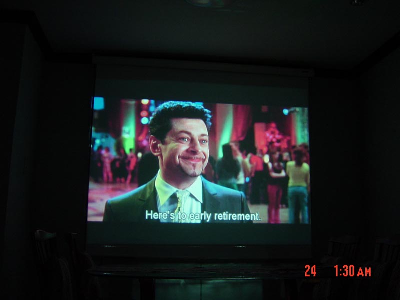

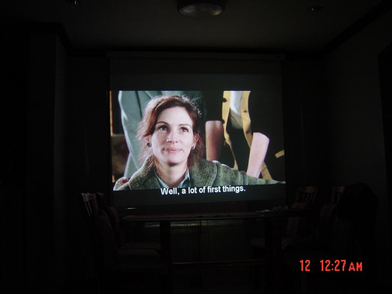

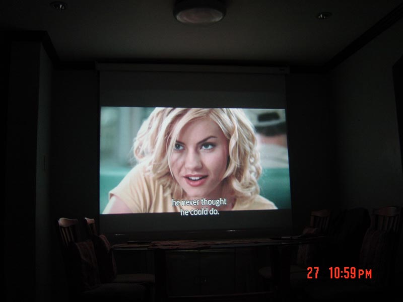

The attached pics is using HQI-NDL. Observe the neutral white color.
I am gonna collect images later using HQI-TSD. It really has a green and blue color. Its the same green tint i observed with some guy's images using HQI-tsd bulb or bulb with high color temp.
