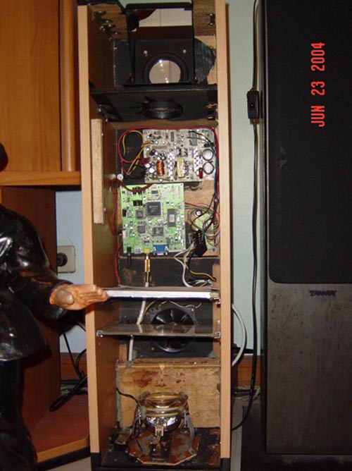

Hey Hertz,
!!!!!AWESOME Projector!!!!! Very, very nice job
Just was wondering if you can post some pictures of your frensel and LCD set up. Unless its top secret. 😉 I'm am interested to see how you mounted the LCD with the 20 degree angle and how the light path might have changed from the LCD being tilted.
Thanks very much... You are the man!!!

zaner21,
i will post picture of my design later in the night. Sorry i am in a hurry.
Hertz
