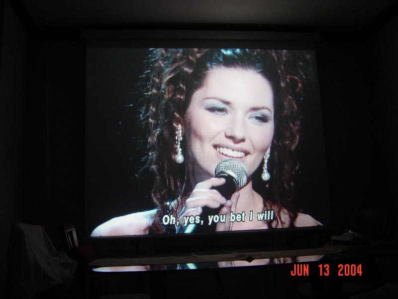

I hope you finished your project soon. We are all waiting of your good results. May the lady ( Shania Twain ) in the attached image gives you inspiration.
(Pls. whisper to me if she is too old or too young for you!)

Alittle to mature for me. LOL-Im 26. hehe. Beutifull woman though. Just not in my ummm errr-time frame I guess you could say. But I rate her a 9, Brittney Spears is a 3 or 4 if that gives you a idea of my chart! Cant stand her.:xeye: Stevie Nix is nice for her age!😱

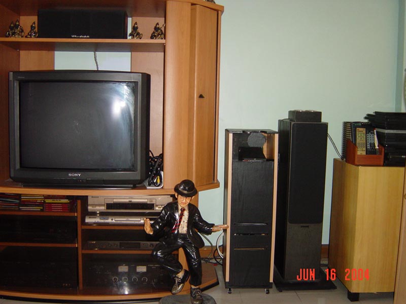

Hertz
note:
My projector is between the black speaker and the TV in the attached image. Its too big for my lcd. I think you can reduce still reduce the size by 30%. I hope you can do better.
