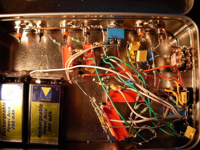

Here is the 1/2 of wanna be B4...😀
Lazy me, I just salvaged me Jfet Boz and built a high-pass active crossover for OB use.B1 buffer is the basis. Thank you Nelson and Zen Mod! Thanks to Nelson's advice from another thread, I trimmed the Q and altered a crossover frequency to 150 Hz. Now it sounds pretty good.
Yet, something is still bugging me, and I have to ask Nelson: Low pass. If I recall correctly, on your "small" OB's, you mentioned that the frequency is around 100 Hz 12 db/oct. But I could not understand what alignment it is: Linkitz-Riley (at -6 db), Bessel, Butterworth or...😕

Re: Rat's nest
I'm not guilty for anything , that's certainly mistake .........
http://en.wikipedia.org/wiki/Linkwitz-Riley_filter
upper right corner of page will give you at least few more names/types
use your imagination
tip : you can always trim value of one part in filter , altering Q somewhat more than Fc
or - make your own crazy net , calculating desired Q from crazy values , which all have pretty same Fc ............... but - don't go too far

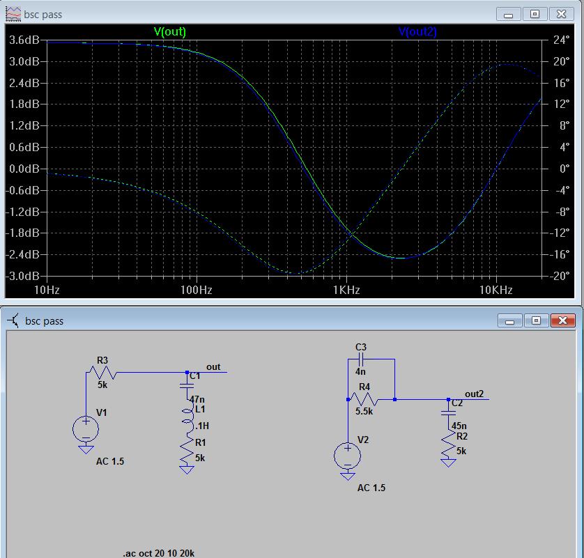

plep said:Notch filter? Choke are not easy to find, why not put a small cap (4nf) in parallel with the resistor that is in the signal path (and slightly trim the values) ?
If you use a cap you will have a much lower input impedance to that
filter at the top end. In a variety of cases, the impedance will to
too low for the passive JFET buffer to have low distortion.

Do you mean that with the added cap the load will be to low? Then will a complementary buffer or as Vix suggested scale the compnents do the job?
Do you mean that the input impedance will be to low and that we are at risk of instability? Then will a 1k resitance in serie do the job?
Best regards.
Philippe (who appologize for is limited english)
Vix said:If you were using an F2 amp instead of F3 for the fullranger in the OB, would you then prefer a passive equalization (notch filter). -the ones that you had described in here:
http://www.firstwatt.com/downloads/cs-amps-speakers.pdf
You try it both ways and see if you prefer one.
plep said:Do you mean that with the added cap the load will be to low? Then will a complementary buffer or as Vix suggested scale the compnents do the job?
The difference depends on the character of the source. If you are not
concerned about the load impedance seen by the source, both circuits
in your example are fine.
If you want higher Q without losses, the inductor becomes the preferred
circuit, I think.

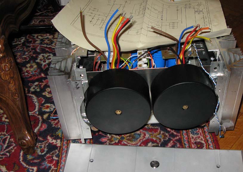

Happy Manu, just got rid today of donuts-buzzing-like-a-loud-razor-problem on my Aleph 5 (Papa, btw, be praised in eternity for this jewel).
DC filter etc. didn't help at all.
Changing Trannies to other ones (in that case black potted talema toroids from farnell or rs?) cure completely the 'blem.
You don't feel even slightest vibration with hand on it.
Conclusio?
Some trannies that are for sale are real drekk...
Manu
(After some metal surgery new trannies fits perfectly ...)
Conclusio?
Manu
