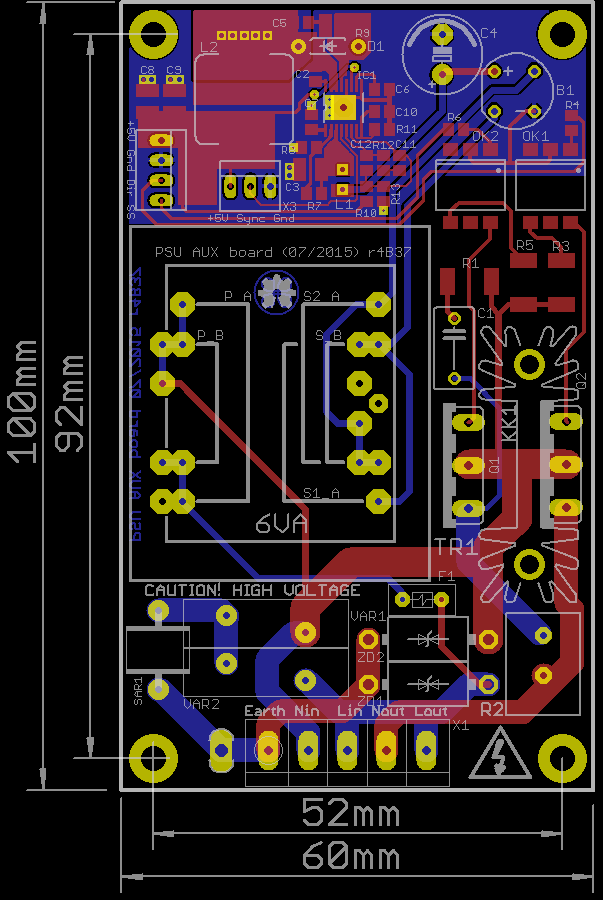

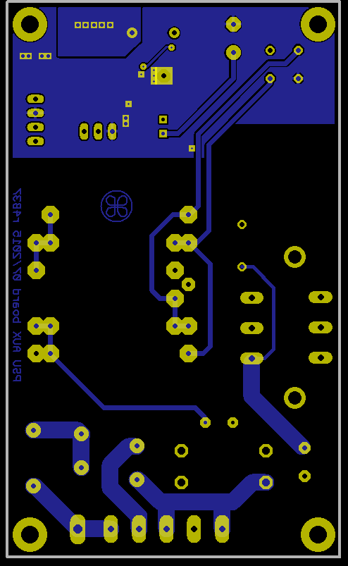

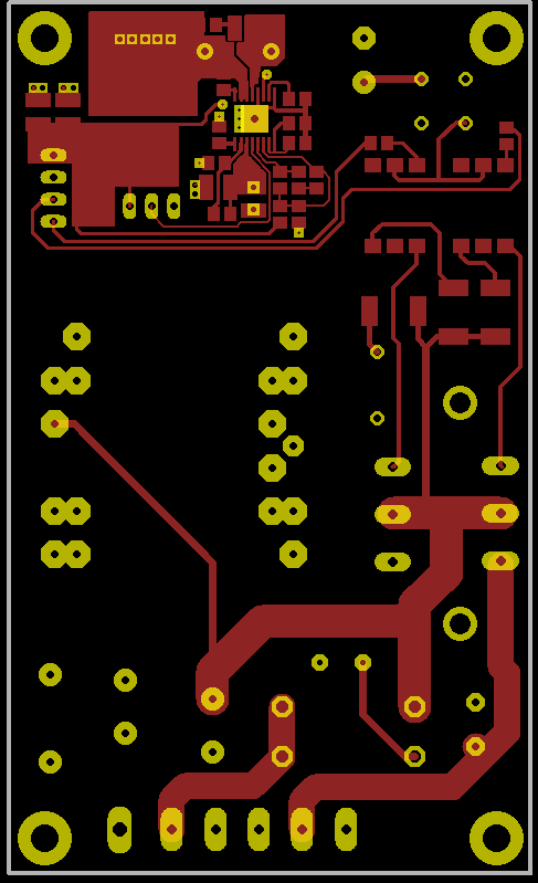

With introducing possibility to works with ARM MCU that can be found on Arduino Due board, requirement for power is changed. Existing AUX power supply is designed to deliver up to 300mA with LM(2)5574 controller that cannot deliver more then 500mA. New controller is selected, LM(2)5575 from the same family that can deliver up to 1.5A.
(version with prefix 2 is designed for lower max. Vin). PCB layout is redesigned in a way to insure better power inductor cooling and possibly better EMI performance.
In parallel with redesigning SMPS part of this PCB I start thinking about adding some sort of soft-start capability since toroidal transformer and huge input capacitor that is deployed in mosfet pre-regulator cause huge inrush current when main power is applied. I started with simple delayed relay which bypass power NTC that is connected in serial with transformer. Thanks to discussion with some people I ended up with replacing relay with two triac. Here is how the new AUX PS PCB schematic looks like:
Soft-start that is shown in upper right section. Solution is compromise between two contradicting requirement that require transformer and input/bulk capacitor. Optimally former has to be switched when input voltage is in its peak, and later when it is in zero. But there is only one power up and decision when to start is based on what is less stressful for the circuit. Since speed of current increase for transformer "pre-magnetization" is slower then one for charging up capacitor two triacs is deployed: one with ZCD (zero-crossing detection) optotriac and another with "non-ZCD". Power up sequence is controlled with MCU, at the beginning both triac are turned off.
Then one with ZCD is used to apply power resistor and after some period od time (up to 1 sec) another one with non-ZCD is fired to bypass power resistor. Now the first one can be turned off. Small heatsink is added to "direct" (second) triac to help dissipate couple of watts that is expected during operation.
Such solution also allows PSU stand-by mode and high current AC main voltage switch is no longer required.
New PCB layout is shown below.
