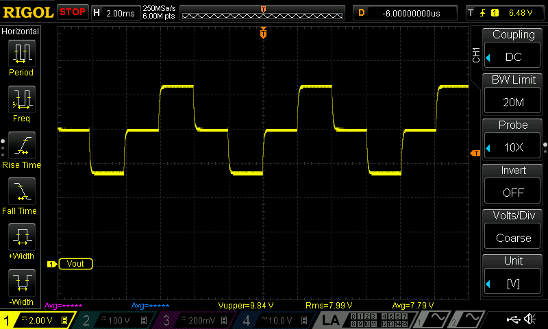

I have one question, what happens at the ouput terminals at switch on / off the supply?
Fex when using only manual control.
Thank you for sharing.
Don't know what fex means 😕 but if you asking about possible overshooting it is not present. In current design I added timer with relay to add power up delay and also power down cut off (Q4 gate is grounded). All this is tested with separate linear bias power supply (LM317/337) when on power down bias supply went out too early that Q4 control is lost what caused that remaining voltage from input capacitors (C12, C13) is present on the output (similar problem was with power up). With a new bias power supply which include SMPS pre-regulator IC3, and LDO'2 IC2 and IC4 and using Powergood signal to enable/start the main pre-regulator (IC1) possibly a timer+relay circuit will be redundant.

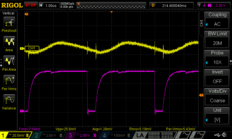

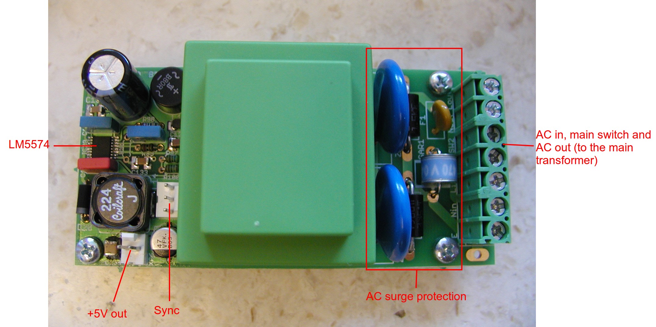

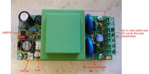

Aux power supply
Aux power supply PCB is assembled and tested. LM5574 works nicely and I choose it because it is also used for bias power supply on power board when input voltage could go up to 67V. The board is intended to provide separated +5V for MCU board and Binding posts board. Max. consumption is ~400mA (mostly consumed by binding posts LEDs and relays when all are active) which LM5574 is delivering without problem.
Here are some pictures of assembled board and basic measurements.

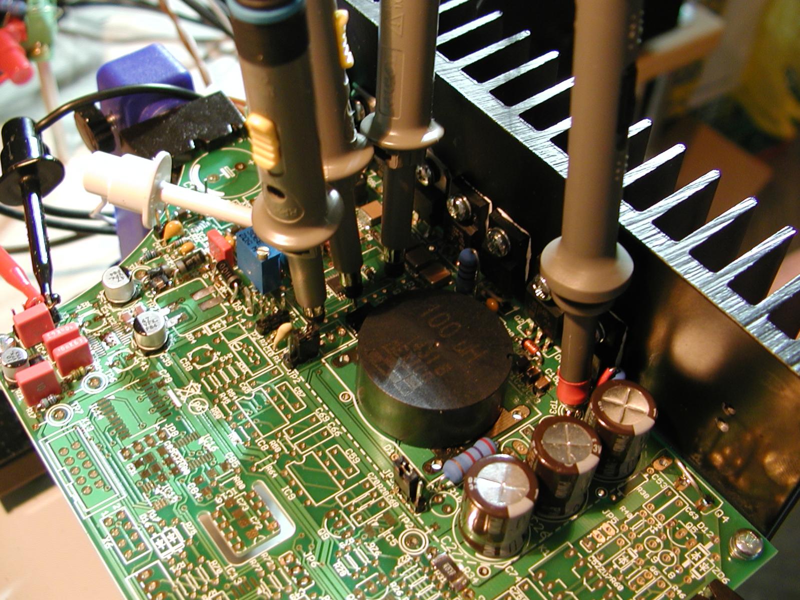

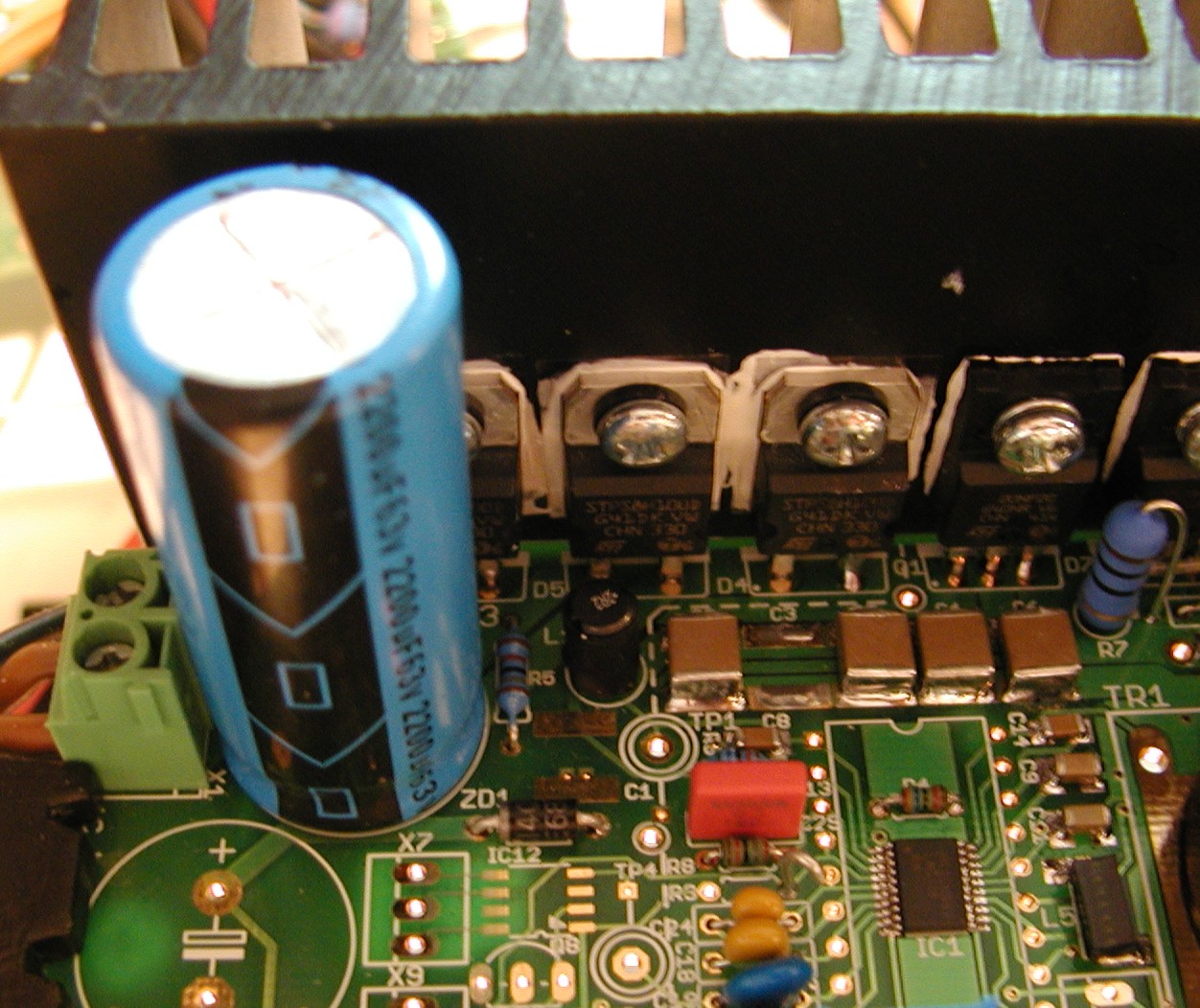

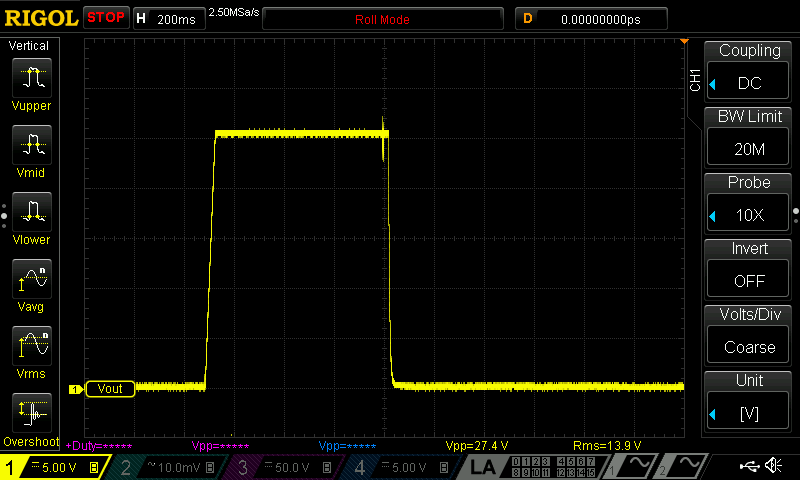

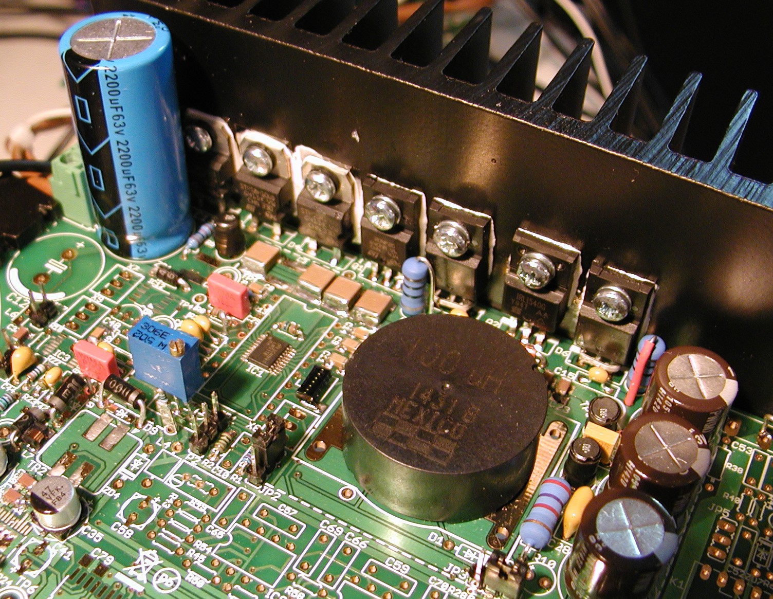

Power pre-regulator inital testing
Power pre-regulator is located on the power PCB (post #17) and initially presented on the Sheet 1 (post #2). I'd like to share some information about initial testing of this part of the system.
First I'd like to starts with some mistakes. Input filter capacitors are located optimistically too close to the rectifier diodes D2 and D3. Since that diodes has to be mounted with screw to the main heatsink there is not many spaces for maneuvering with a screwdriver. It's so difficult to mount mentioned diodes but they could be more accessible.
Another mistake that cost me one LM5118 is that I forgot to add a small resistor in serial with P1. In normal operation a whole section P1, R1 and R2 is not necessary since PREG_FB signal (Sheet 2) will be used for controlling PREG_OUT. I added this section deliberately because in that way you can assemble and test power pre-regulator section without tracking control and the rest of the post-regulator (Sheet 2). So what's happened? P1 was initially set for Vout below 10V and I started to turn P1 too fast (approaching ground) and since LM5118 is buck-boost controller it has no problem to increase Vout to 100V! I heard click and the next action was removing LM5118 with rose's metal from the PCB and mounting another one
In attachment you can see pre-regulator section of the power PCB. Power inductor (TR1) is Wishay IHTH1125MZEB101M5A. Selected heatsink is RAD-A52317/50 (painted in black). I'll play in the future with other inductors and try heatsink Fischer SK85/50/SA.
Currently I've measured the following temperatures on some key components under max. load when LM5118 enters buck-boost mode (@Iout=3A, Vin=48VAC, Load=16R4, Tabient=23oC):

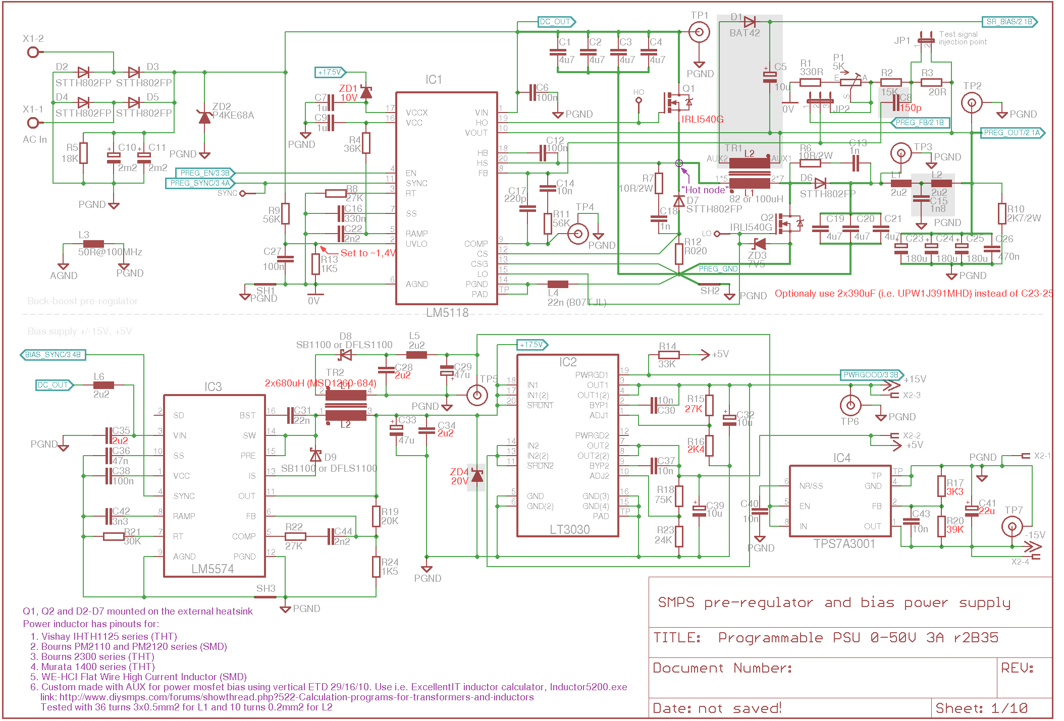

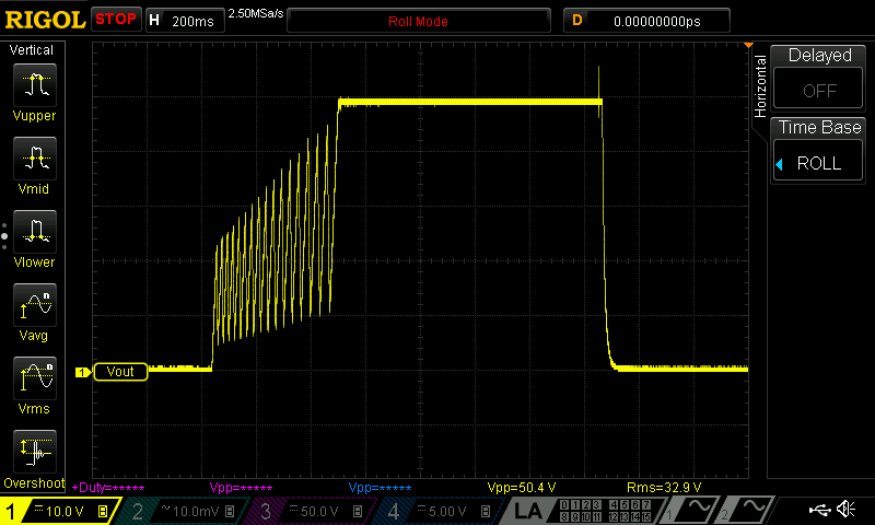

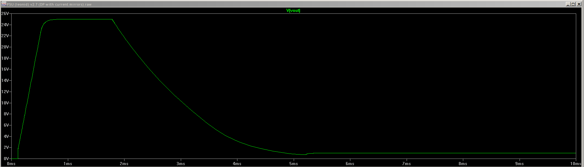

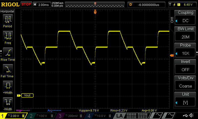

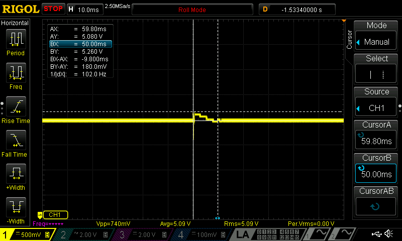

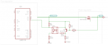

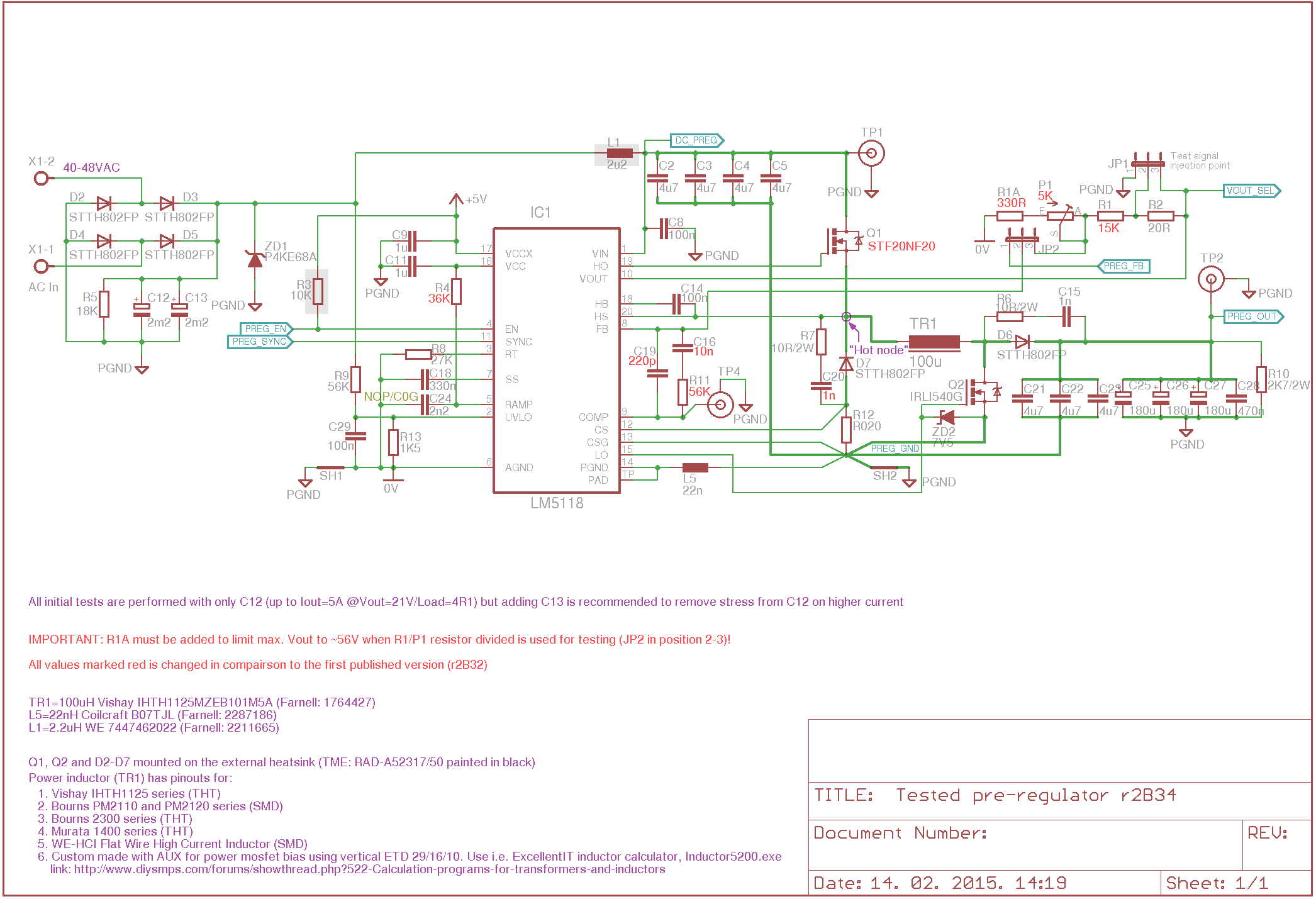

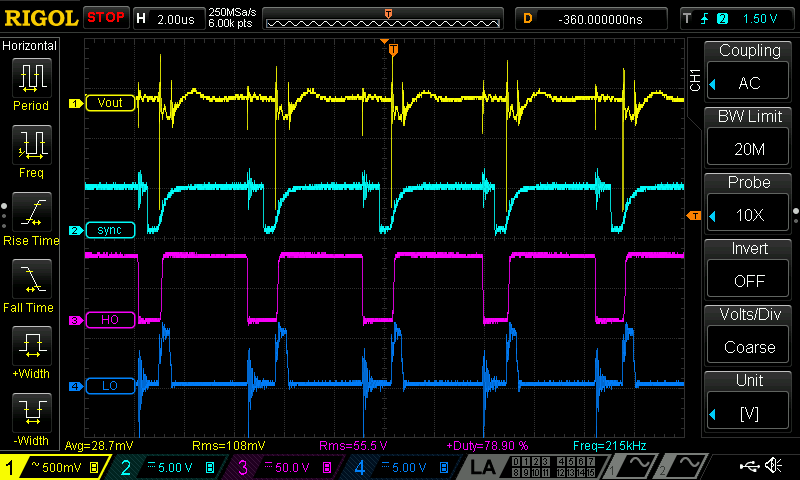

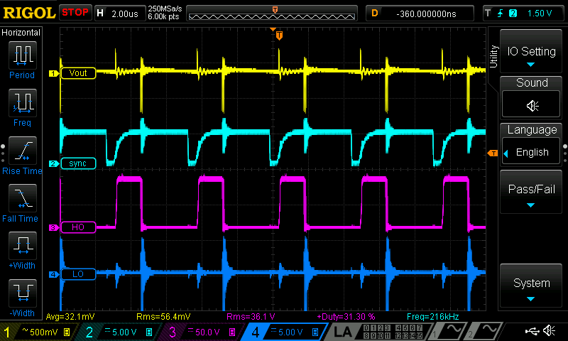

Schematic of tested power preregulator and measurements ...
Attached schematic reflects changes added to the initial version of the power pre-regulator presented in Sheet 1 (post #2). It's accompanied with my version of TI's quick calculator that is used for defining component's value.
Unfortunately I didn't succeed with deployment of the output filter (L2, L3, C17 in the first version from post #2) to further decrease ripple without serious oscillations when load is attached so it's for now removed from the schematic.

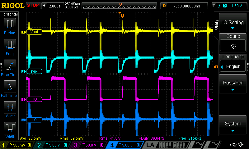

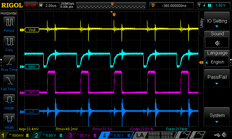

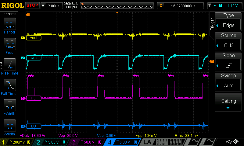

For testing I've used various resistive loads incl. lamps (see post #8, which actually works like a huge PTC resistor) and DC motor as an inductive load. Signal traces are marked with Vout, Sync (LM5118's pin 11), HO (pin 19) and LO (pin 15). I tried to checked output ripple, possible instability with various loads, gate output signal and power up/down overshoot. I hope that picture titles are self-explaining and as you can see I went with testing Iout with up to 5A (ok, still within projected 150W).

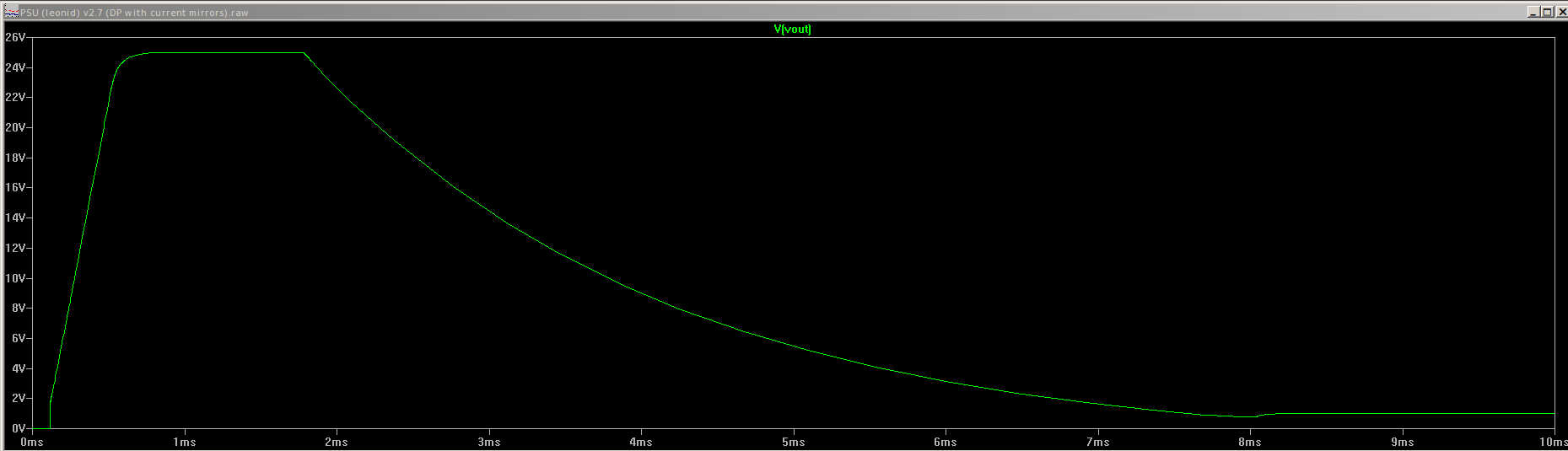

Interesting and on the first sight possibly misleading picture is one which shows power up and down with 4x35W lamp load connected. Since when lamp is cold its resistance is similar to short circuit, LM5118 gradually reach required Vout as wire filament heated.

2015-02-14 Pre-regulator Vin=48VAC, Vout=25V, Load=4x35W lamp, Iout=3A, power up and down.png38.7 KB · Views: 215
2015-02-14 Pre-regulator Vin=48VAC, Vout=25V, Load=8R2, Iout=3A, power up and down.png38.2 KB · Views: 174

2015-02-13 Pre-regulator Vin=48VAC, Load=4x35W lamp, Vout=48V, Iout=3A.png56.4 KB · Views: 694
2015-02-14 Pre-regulator Vin=48VAC, Load=4R1, Vout=21V, Iout=5A.png58.6 KB · Views: 706
2015-02-14 Pre-regulator Vin=48VAC, Load=4R1, Vout=17V, Iout=4A.png52.7 KB · Views: 745
2015-02-14 Pre-regulator Vin=48VAC, Load=4R1, Vout=13V, Iout=3A.png50.2 KB · Views: 798

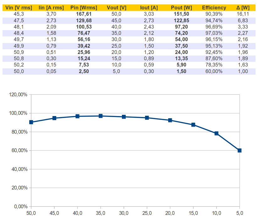

Power pre-regulator efficiency...
I tried to get some idea about power dissipation and does current heatsink will be enough for extreme case (50V/3A on output). Measuring Vin and Iin as AC (rms) and Vout and Iout as DC I got the following data:
If I substract few Watts from ~16W in 50/3A that is dissipated on power inductor (TR1) and Rsense (R12), and also add a couple of Watts because I have to go up to 52V/3A plus at least 6W on Q4 from post-regulator then it's still ~20W for max. output. Due to that probably a little bit bigger heatsink will be required. A previously suggested SK85/50/SA with thermal resistance Rth od 1.35K/W should do a good job keeping temperature to the 50oC if Tambient is 23oC.

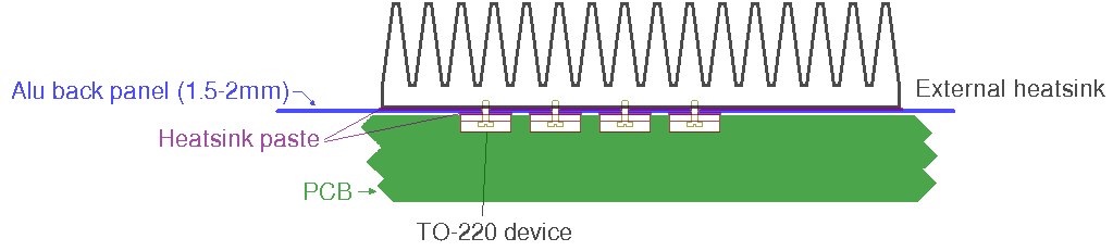

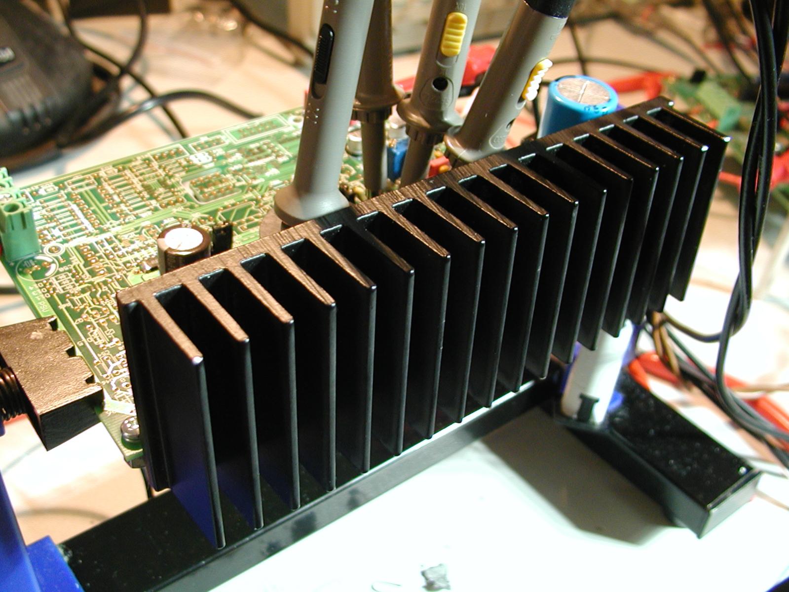

Doubt about installing heatsink on the back panel of Alu-enclosure
I have doubts about one rather simple issue: how to install heatsink on back panel of Alu-enclosure in the most efficient way? When I say efficient mean thermally and financially. One possibility is to open a huge rectangular hole on back panel that all TO-220 devices can be mounted directly on to heatsink. Another one is to mount them directly to the back panel and mount heatsink on opposite (external) side to assist thermal conduction. Second option is mechanically simpler (and cheaper) but with possibly lower thermal performance. But how much lower? Is it worth considering such option? Back panel area will be 280x115mm or 320x115mm (1.5-2mm thick). I'm not aware of calculator which take into account such setup.

Not so good news is that I found a mistake in connecting bias power supply coupled inductor. Fortunately it's not so big and with a couple of track cut and rewiring it works fine with existing PCB layout. A new Sheet1 with corrected coupled inductor wiring is also attached. LM5574 works very nicely alone and selected LDO's is probably overkill for DIY project. I'll probably in next PCB layout make a space for lower-cost alternative like LM317, LM1117 and LM337.
Finally a bad news. Currently the only "small detail" which stopping me to announce this board finished is that planned tracking control does works with LM5118. It even ends up with its blowout wiping out my LM5118 stock like a storm
. So, LM5118 works just perfectly when it is controlled with "standard" feedback derived from resistor divider network (R1/P1, R2 from the latest Sheet1). When JP2 is shorted on position 1-2 I have a real mess. It even cause that ZD1 used to connect Vccx to the aux bias (as a mean of lowering LM5118 dissipation) is destroyed! I hope that TI's people will came up with some ideas or completely different approach will be required (based on simple PNP or optocoupler trackers published in some LTC's application notes).
Power board is completely assembled and main function was tested. I have some good and some not so good and some bad news. Let's start with good one. Using bias power supply presented on the Sheet1 works much better and power up and down issues with overshooting caused by improper power sequencing is not exists any more. While "breadboarding" I used external transformer and set of standard linear regulators (7815, 7805, LM337) that provides required +15, +5 and -15V too late during power-up and vanish too early when power goes down. Power up and down sequencing can be found in the attachment. As a result a whole "mechanic" about controlling post-requlator power mosfet bias with TLC555 and relay is not necessary anymore freeing some PCB real estate.

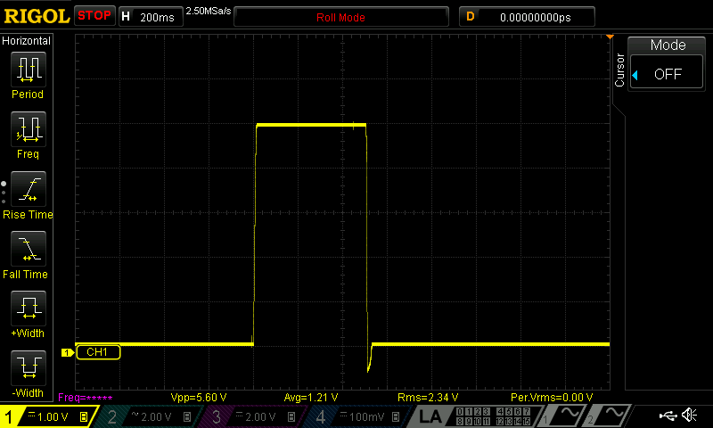

I made some progress playing with tracking control for pre-regulator. To be sure and avoid destruction of new arrived LM5118s first I tested that everything works replacing the lower resistor with a LDR (Farnell: 2293503) in resistor divider based feedback to set pre-regulator Vout (or PREG_OUT in schematic). After that step I built a tracking control coupling LDR with 3mm red LED which could be replaced in the final stage with some ready made solution (i.e. NSL-32SR3, Farnell: 3692218).
This solution works providing difference of ~2.1V between PREG_OUT and OUT+ (after post-regulator), but not completely. It failed to set a desired voltage if during power up load is connected (i.e. 100R resistor) 🙁.
If load is connected after power up everything continue to work fine: pre-regulator is "locked" to post-regulator output. Currently don't have idea why is that and yours suggestions are welcomed. Please also find in attachment some measurements during power up: without load (set Vout=10V), without load (set Vout=18V) and with 100R load (set Vout=10V or any other higher then 1.2V).
Please note that "glitch" when Vout is set to 10V. It's present for Vout range of approx. 2v to 18V. Maybe that's a clue to the workable solution 😕. Is it in any way connected with the fact that power mosfet driver is not connected to ground but to -2V currently derived from -15V using 13V Zener diode?
2015-03-06 LED-LDR Tracking control, Vout=1.2V (set to 10V), L=100R.png35 KB · Views: 156
2015-03-06 LED-LDR Tracking control, Vout=18V, no load.png38.4 KB · Views: 185
2015-03-06 LED-LDR Tracking control, Vout=10V, no load (2).png46.3 KB · Views: 239
regarding mounting semiconductors, I strongly suggest you cut a hole in the back wall.
Otherwise you need to use extensive screwing to prevent air gaps between the wall and heatsink, as the former probably will warp. Any rigid metallic object between semiconductor surface and heatsink will cause small airgaps.
Regarding your troubles with blowing up the buck regulator, I have justed looked quickly at your schematic but are you shure you are not driving the inputs at to high potential, ie you need some isolated transfer , fex optocoupler as you suggest.
Thanks for your feedback. Do you think that applying heatsink paste cannot "fill the gaps" even if we have here two areas (both side of chassis back panel)?
I blew up few od them when I played with inital "complex" tracking control that is on the PCB. It works fine if simple resistor divider is used or LDR-LED optocoupling described in my previous post.
I think that to get sufficient contact between to 220 capsule , back wall and heatsink ypu might damage the to 220 due to the high torque/ pressure necessary.
The heatsink paste should not be more than say a houndred microns thick, no more to bridge the airgaps between the uneven surfaces. It is like putting two handsaw blades teeth against teeth, the paste should fill the void in between.

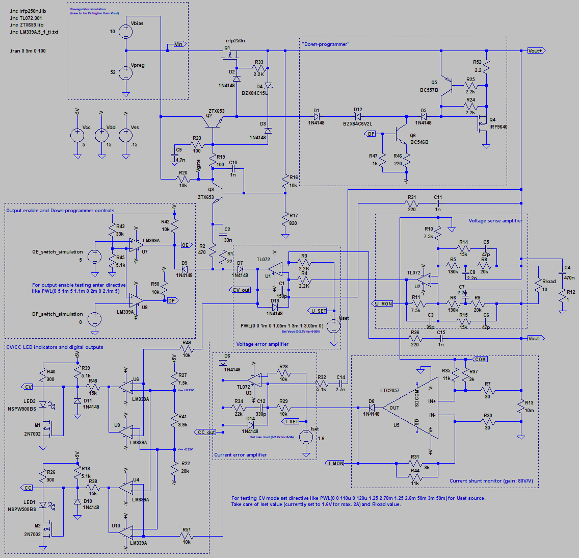

Current status...
Many things have happened since my last post. I continued my quest for workable tracking control and tried one that is e.g. used in LTC’s DC2132A. It’s interesting that they have two schematic revision where tracking control section is updated. Both of them contains RC filter without values. Don’t know why possibly because a whole thing is not so exact and require some experimenting. I tried that circuit and can say that it works fine up to ~25V and after that it starts to produce instability in SMPS pre-regulator especially after 30V which makes this solution unacceptable for my project. I tried to isolate PNP from FB pin using regular optocoupler (4N35), it works a little bit better but still not acceptable and finally when I used LDR coupled with LED it works nice up to 50V. So lets say that this part of the story is closed.
After that I decide to test NSB Lab design presented here and here. Finally I started to use spice software, first Simetrix but shortly came to free version limitation 🙁. That’s pity since this software works really nice and I started to use it almost instantly. Anyway simple CV control loop model for Simetrix is enclosed in attachment.
Next station was LTspice. Thanks to massive and excellent assistance from Leonid (NSB Lab) I ended up with model which is also enclosed. Actually three of them. First is with LTC2057 as a current shunt monitor which I selected since I have few of them on disposal for breadboarding.
Second model is derived from previous one as an example of CV control loop only in case that you have the same problem that I noticed – simulation lasts possibly forever (I left it overnight but without success). It’s possibly a problem with my environment since I’m running LTspice on Ubuntu with Wine. Due to that I also send in attachment another model with AD8610 used as current shunt monitor. I currently have no plan to test AD8610 since it doesn’t look attractive due to its high price. Final candidate for this function is still not selected, but there is no need to stick with only one since there is many nice op-amps that can be used. Here is the table with some of them that I found interesting.
Any your inputs is highly welcomed. In the final step when a new PCB has to be made I need to decide which package to use SO8 or MSOP8. Again, your inputs is welcomed.
Down-programmer...
New post-regulator include so-called down-programmer. I found this feature (check i.e. this and this Agilent documents) useful and decide to definitely test it and eventually add to the next PCB revision. Difference cannot be noticed with huge load (small impedance) but it’s clearly visible with smaller load or no load. Please find below two screenshots from simulations with down-programmer (DP) switched off and on:
Here is how it looks like when Vout is controlled by sequence 5-7.5-10-7.5V sent using DAC. Notice difference in fall time:
