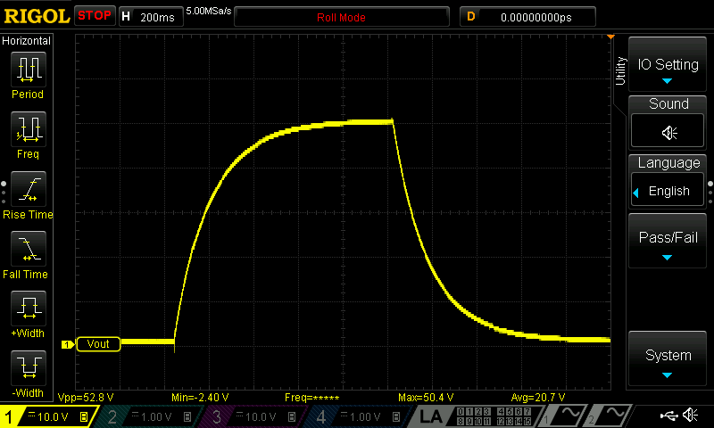

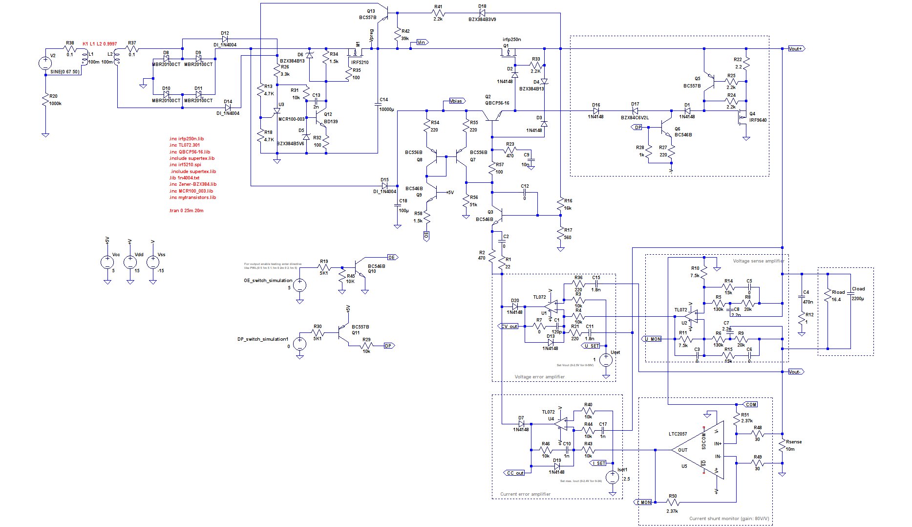

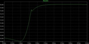

Testing capacitive load, CC mode
All mentioned in latest few posts about driving combination of resistive load with capacitor in parallel is performed in CV mode. I found some issue in CC mode possibly due to so many models and schematics that at the end I was put on the post-regulator PCB some values that is not used in simulation. End result was a significant Vout ripple (~1Vpp) when PSU enter CC mode (see first picture in attachment for 16R4 load in combination with only 470uF).

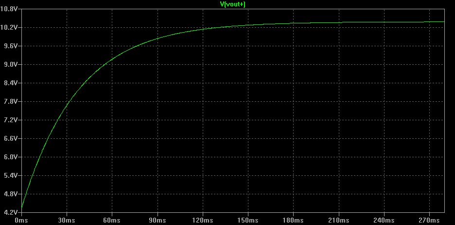

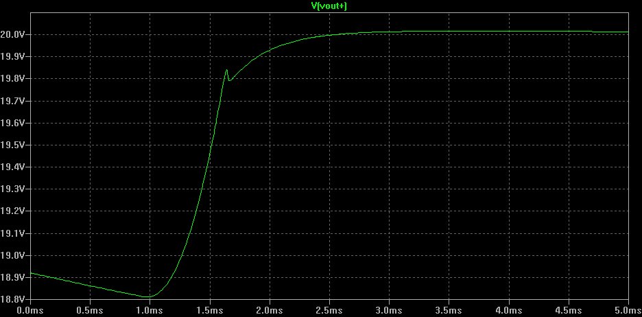

When I made all required correction I got very nice behavior that is equal with one in CV mode. You can see that on the second attached picture (OE step with 16R4 load in parallel with 10000uF). It shows same stability regardless of DP mode (on or off).
Finally I'm attaching latest LTspice with mosfet pre-regulator included that nicely follows what I got while testing the real stuff. Please note that I left few capacitors with value zero (C2, C3, C12) which was a source of oscillation in both CC and CV mode. CC/CV comparators are also excluded since they are not relevant for stability analysis.

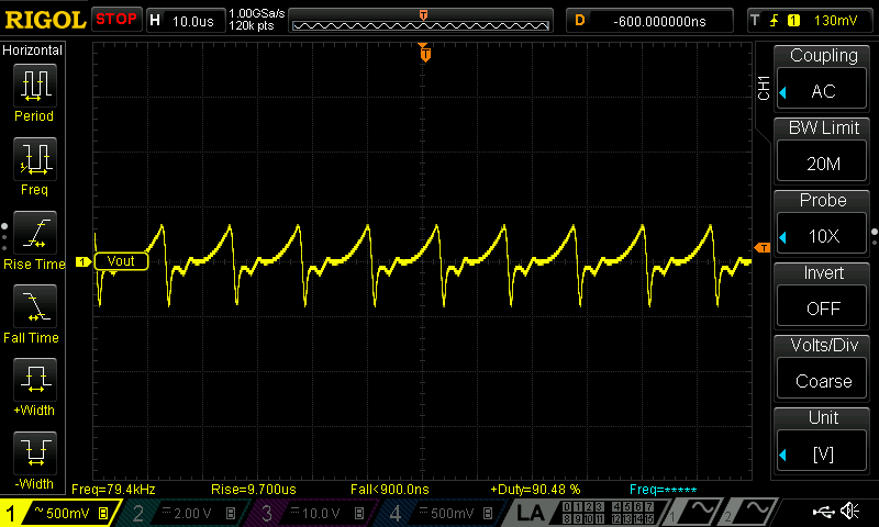

2015-06-05 PSU Vout ripple in CC mode, load=16R4 + 470uF.png40.9 KB · Views: 494
2015-06-06 PSU OE on, Vout=50V, load=16R4 + 10000uF, DP off, CC mode, C50 removed.png36.2 KB · Views: 433
PSU with mosfet pre-regulator, load=16R4+2200uF (from 20 to 200ms) CC mode.jpg64.6 KB · Views: 419
PSU with mosfet pre-regulator, load=16R4+2200uF (from 20 to 25ms) CV mode.jpg72 KB · Views: 431

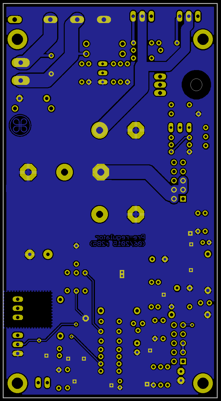

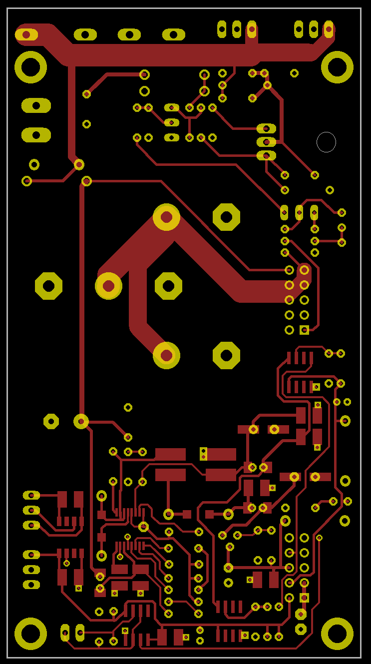

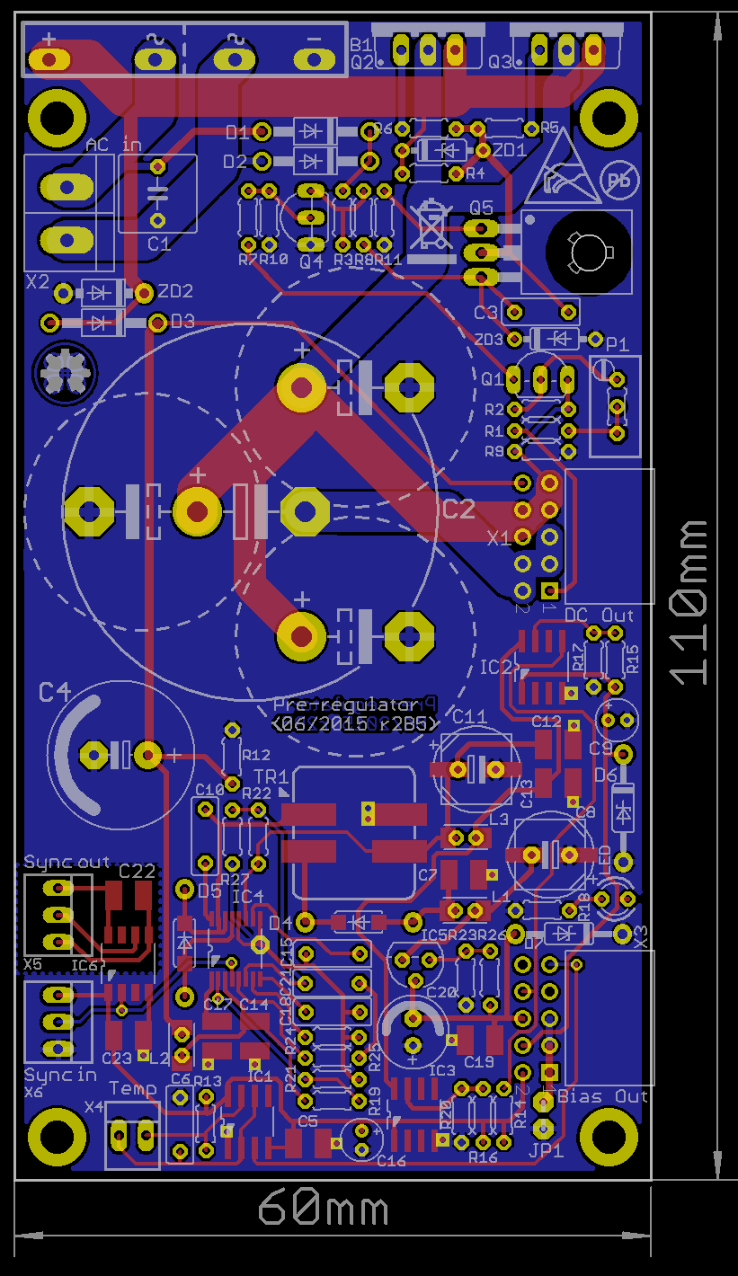

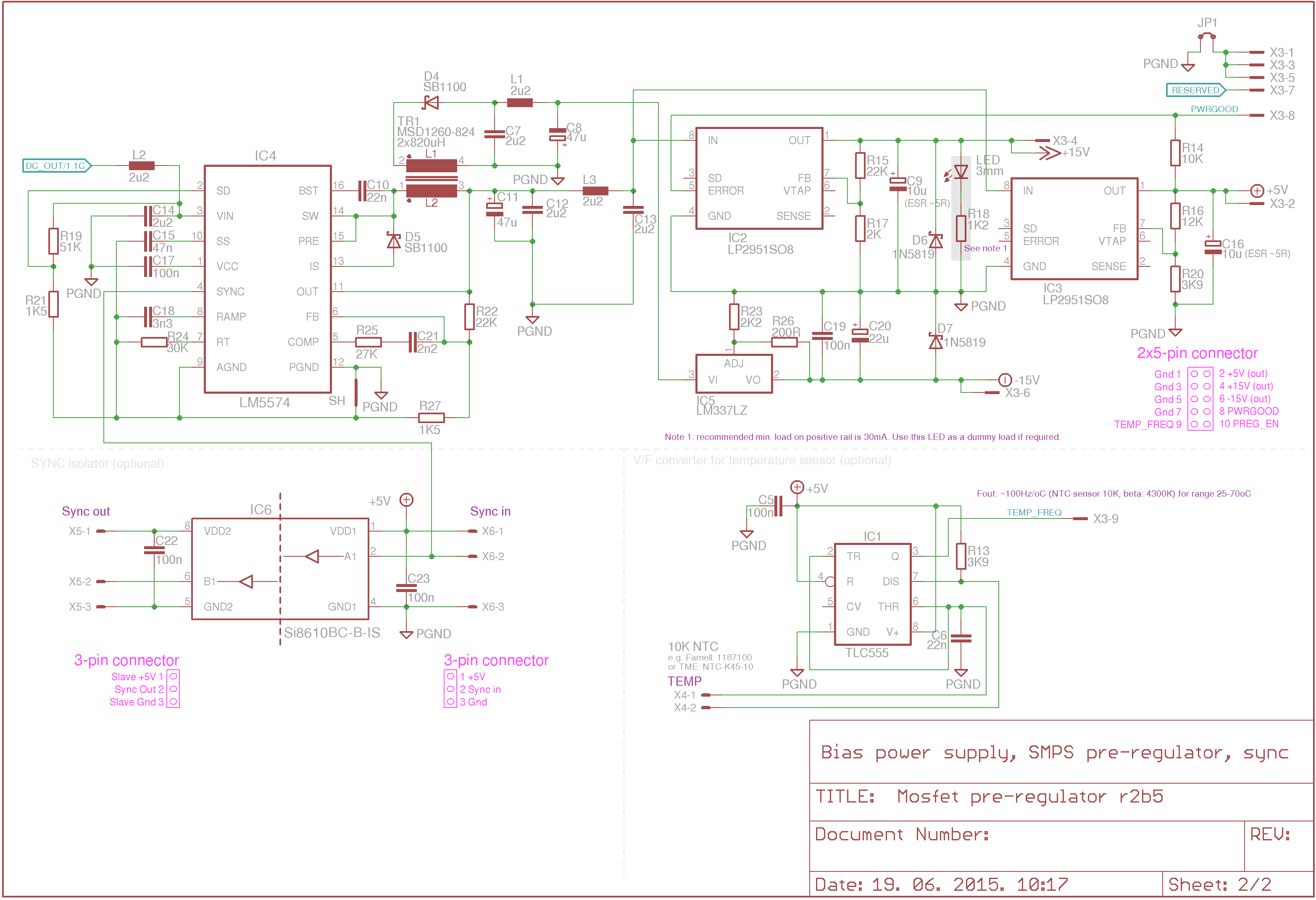

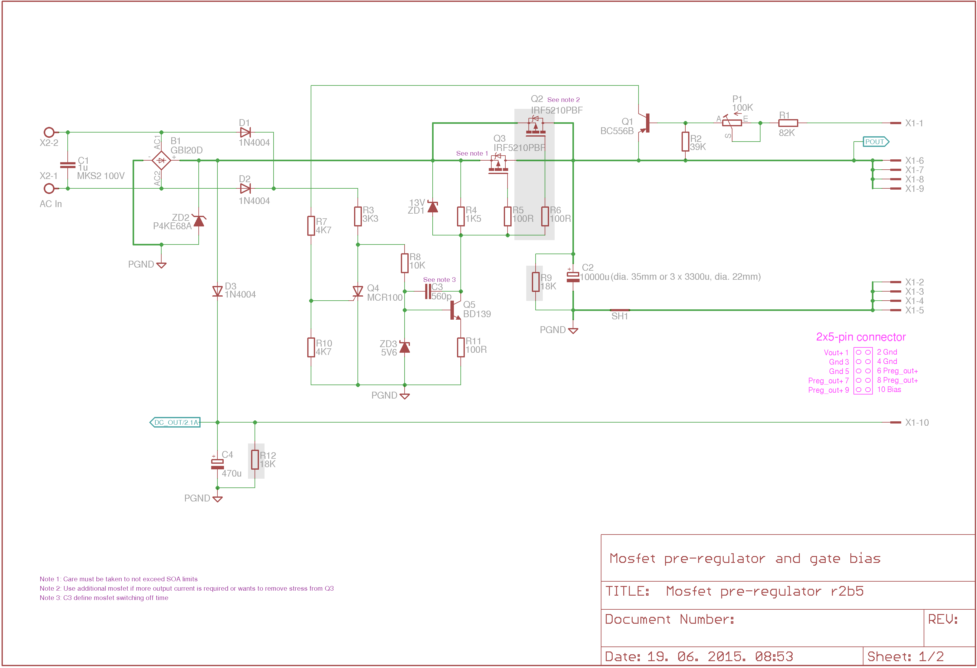

Mosfet pre-regulator PCB r2B5
Mosfet pre-regulator PCB is more or less completed. It now include the following sections:
Items 2, 3 and 4 is reusable for other pre-regulators (like SMPS buck or buck-boost). Last two items are optional: sync isolation can be used to synchronize switching frequency of all SMPS controllers. In dual channel version with SMPS pre-regulators their number can be up to 5 (2 high power, 3 small power).
V/F converter is used since there is enough room to place it on PCB and couple of unused pins were available on I/O expander (MCP23S08) located on the post-regulator PCB. It is not precise (~100Hz/oC in 25-70oC range) like dedicated temperature sensor devices but since it should be used for measuring temperature on main heatsink it is more then enough for monitoring if alarming temperature is reached or not.
In this version is fixed Power good signal issue what is important for proper functioning of post-regulator during power up and power down phase.
Schematic for r2B5 version is in the attachment. In new post that follow I'll attach Eagle files, Gerbers and BOM.

Mosfet pre-regulator PCB r2B5 layout and BOM...
Here is all files required for creating above mentioned mosfet pre-regulator. PCB is maybe a strange or unnecessary mix of THT and SMD components. If this project comes to group buy phase I can redesign everything to use SMD to maximum extent.
Edit: Don't know if custom library is also required for viewing Eagle files.

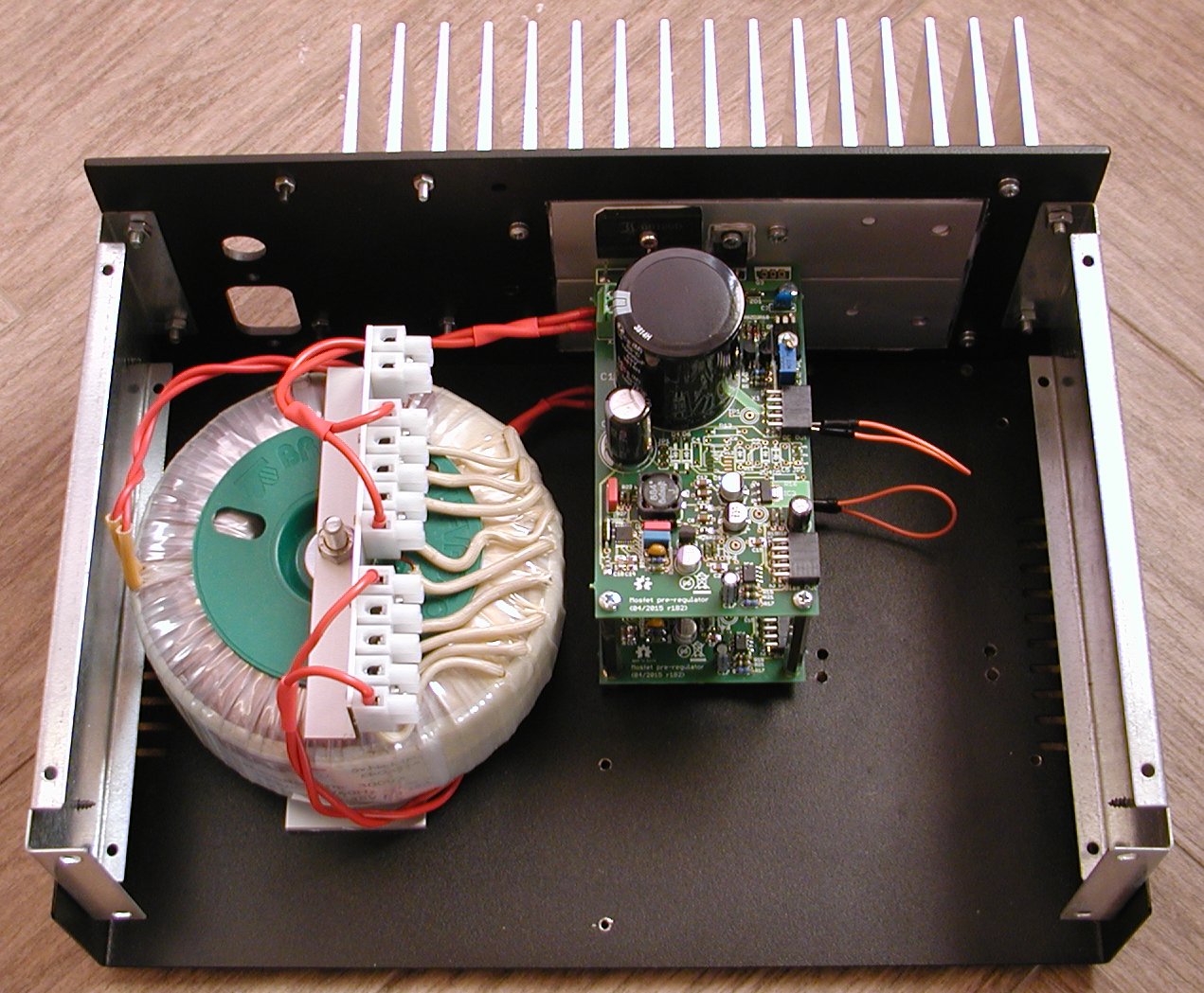

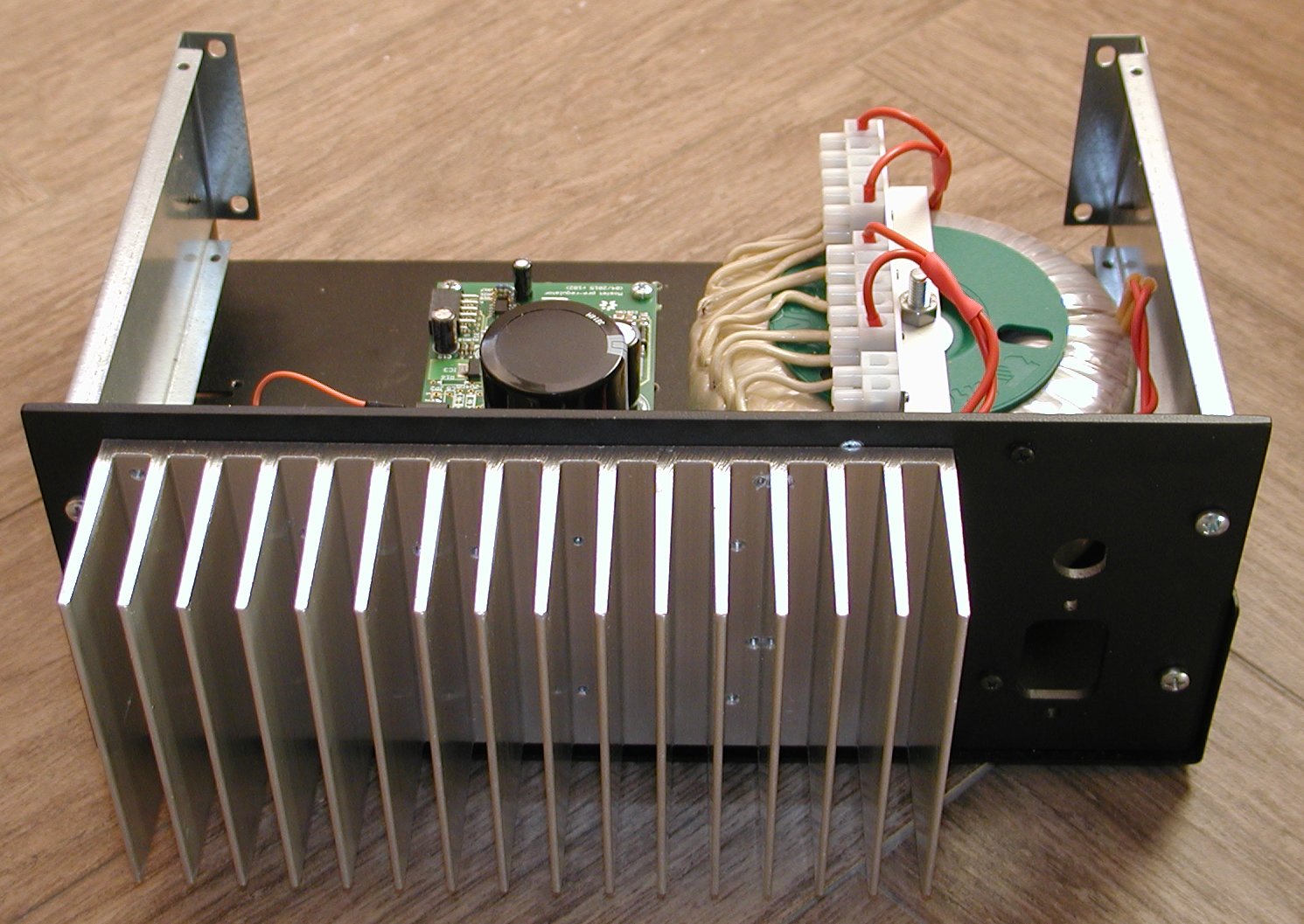

PSU in enclosure with provisional front panel
I almost succeed with mounting all required components into enclosure. Said almost, since as you will see the front panel has to be defined. Also some other mechanical issues have to be resolved. At the beginning I was planned to make a first prototype that is only manually controlled. I also had a chance to order a sample front and back panel for free from shop that belongs to brother's friend. The front panel is prepared for mounting multi-turn pots and cheap (and unusable 🙁, see post #53) eBay grade DMMs, binding posts for power and sense signals and protective earth:
I adopted it to carry the MCU, keypad and BP (Binding posts) PCBs. Now it looks like this (some pictures for some reason have a wrong aspect ratio in preview mode, please click on the picture to see it in right proportions):
Please note that this funny look is a provisional and a new front panel has to be designed. In the process I'll probably make a fusion of three mentioned PCBs. More about BP PCB will follow in the next post, here I'd like to present some mechanical obstacles.
First, AUX PCB has to be mounted on the removable top cover because it ends up that there is no enough space to mount everything inside even when MCU, keypad and BP PCBs are mounted on the front panel. This possibly don't looks nice but it's functional and require a little bit longer AC main cables and +5VDC for MCU and BP. The later is also provisional (twisted white-blue) and will be replaced with shorter and shielded one. Actually everything around front panel is provisional.
Second, "double decker" approach has obvious advantage in saving space but from other side if something went wrong on bottom channel, upper channel PCBs have to be removed first. Also even if everything is ok, and you'd like to concurrently monitor signals on both channel you are in trouble.
One can say that even sharing single main heatsink is not a good idea and makes channels chained to each other. I thing that is of secondary importance in comparison with the previously mentioned fact.
Transformer: few years ago I ordered a custom made toroidal which is declared as 2x150VA (2x48VAC). I know that is too low for continuous planned capacity of 2x150W. But, I expected that it can deliver without hassle at least 1.5A per channel or 150W in total. Some preliminary testing told me that this is not a case. Ok, it's summer time and my room temperature is 29oC but with such kind of load it can go easily to ~80oC. Don't looks nice 😕. What are you thing?
Now we comes to the most problematic part: front panel. First please note that USB cable (see bottom left corner) is connected directly to the MCU PCB regardless the fact that small "breakout" PCB for Ethernet and USB socket was made:
It's not mounted even provisionally since I had no idea where to put it: on the front panel or maybe on the back panel. Both are pretty populated and that is one more indication that this enclosure is too small. But, the same manufacturer have another slightly bigger (and not too big) that could serve the purpose better.
If USB socket (Ethernet will be covered in some of the following topics) can be mounted on the front panel it will be nice to put it on the MCU. Also CC/CV LEDs could be placed on the MCU and at the end the Keypad which is currently a separate PCB could be merged with MCU. But, here we came to the problem. The MCU PCB is "piggybacked" on the LCD and that adds ~10mm depths which is too big for chosen keypad's tactile switches. That means that "Front panel mainboard" should have a hole for LCD and some simple and not too expensive mean of connecting LCD. Currently I have no clear idea how to do that and especially what kind of connection to use. Possibly my description is also to confusing that someone understand what I wants to point out

post/pre-regulator development is more or less completed. Eagle files for Pre-regulator with mosfet is available in post #70. If you are fine with such concept and PCB layout that still include THT components, you can go with it (or you can wait for GB that is planned). Post-regulator require PCB redesign (form factor will be same) and I'm planning to switch from THT to SMD.
Currently I'm busy with MCU programming and complete redesign of PCB that has to be mounted on the front panel because as you can see in few latest posts current situation is not favorable 🙂. I still think that is possible to stay within same metal enclosure or one a little bit wider (40mm). A more good news about this will follow soon.
I also decide to redesign AUX PCB (AC input protection and MCU power supply board) by adding soft-start to have better control of in-rush current during power up.
