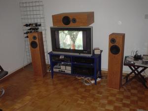

Mezzo, I'm considering your design. But I would prefer to make a design that is "smaller" as it would be an advantage to put the box on the TV. But maybe the estetic design has to be sacrificed for the sound as there do not seem to exist any exact clone crossover for the neat Proac CC One Center.

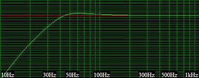

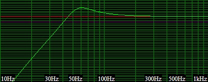

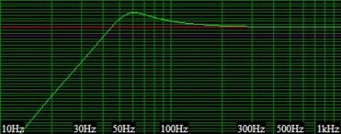

WinISD simulation
I tried to simulate the box with WinISD, and I got the following results. It has a 4.8 dB peak at 60 Hz, and the -3 dB point is at 40 Hz. Is that correct, or did I miss something? Is this acceptable for a CC, or can we improve it somehow?
Saci

I would like to start the proac center speaker project this week.
I'll probably go for the same drivers (but choose a shielded 8535) and x-over as the big ones and just make the box 1/3 size about with 19mm mdf on all walls and narrow the front width so that there is only 1 cm distance between the 8535 and the edge. This box will be too heavy/big anyway to place directly on the tv so I guess it's not necessary to have a shielded tweeer. I will either hang it on the wall about 20cm above the tv or place it on a 30 cm high stand on the floor with the center speaker slightly angeled 10- 20 degrees upwards.
Just tell me if I can go wrong with this!
