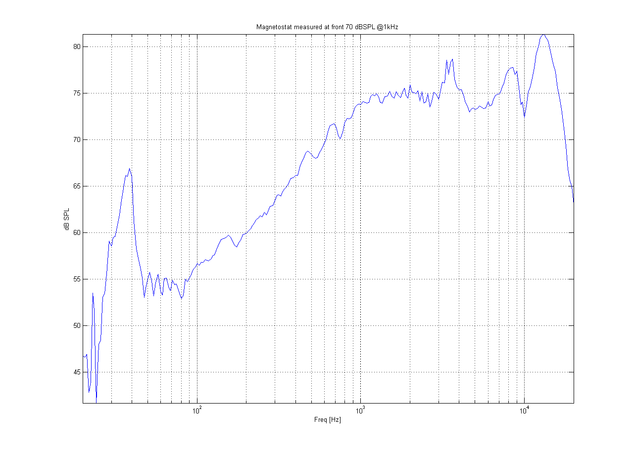

For my new planar i hawe made a downscaled version
[URL=http://img401.imageshack.us/my.php?image=billede404.jpg][IMGHTTPDEAD]http://img401.imageshack.us/img401/4026/billede404.jpg[/IMGHTTPDEAD][/URL][/IMG
[IMG][URL=http://img100.imageshack.us/my.php?image=billede405.jpg][IMGHTTPDEAD]http://img100.imageshack.us/img100/2301/billede405.jpg[/IMGHTTPDEAD][/URL]
It is not curved but bend .
I will try a 1½ way ,only the center panel plays treble,but all mid/bass.
This is how it looks in full scale.There are 3 panels,but only the center one plays fullrange ,or maybe tweeter.

It sounds like the other one i made with 30 my folie.It has a peak at 200-300hz.
The resistance of 9,6meterlong 4,5mm wide is 2.2 ohm.center panel is made of 3mm.foil 4,8meter long and 1,6 ohm.
The efficiency is as the one made with only 3 rows of magnets and 7 my alufoil.
Do i increece sensivity by running 2 or more conductors.in the same "gap"
The new one might call for a larger baffle size,
to make use of the larger membrane area at
low frequencies ....

Hello Bandsei , those are pretty wide gaps , the mag should be closer for better sensitivity.
also , and i'm not sure from the pics , but it looks like your returns are incorrectly placed , check the polarity between the panels for phase issues...

As has been pointed out, you are not getting enough out of your magnets. You need either to move them closer together, or run more turns between them. You can go close to the middle of the magnets to get the maximal out.
I once made a small push pull, seaker using only 2 mm thick neo magnets, running 6 lines of conducter and having 3 rows of magnets, 50 cm high.
Think they where fine down to some 200 Hz and the sensitivity was comparable to a normal speaker.
With you big magnets, you should be able to get really good sensivity.
(the measurement was only made from 1k and up on the picture below)
Beat regards Baldin

Here are the responsecurves.The peak is at 500 -1000hz.I dont have a problem with sensivity,i was surpised that it was not more sensitiv than my other planars.
One of the curves are with a 47uf. across the outer panels.All panels are in series.
My next move must bee to make a diapram with 7 my alu.There is only 10mm gap betwine the magnets.I always try my speakers with a battery to see if the membrane moves syncrone.
