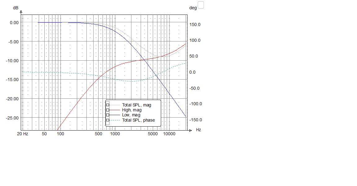

My messurements are made 1.5-2m.distance,and my latest crossover is like this:
I have tried to alter the values and it does not affect the dip much.At other gating settings it looks different regarding the dip at app.3,5 khz.
I realy like the sound .There is a lot of details and room.My subbs helps from 80 hz.and they contributes to the"roomy" sound .

Hi båndsei
I think you have a big phase problem.
Make some measurements from each driver individual without filter and post back here.
Then make measurements from low and high individual with filter and the combined measurement and the combined should always be above the individual lines.
My suggestion is to make 12dB filters and change the polarity from the tweeter.
If you can make a txt file from the individual speakers with magnitude and phase you can sent them to me and I do some simulation for you.

My strange correction was to get more levet at the top.
This one is made mith 0.85mh. in series with basspart and 10uf in series with 3,3 ohm and tweeterpart.

Well now the 3 k Hz region looks better.
The tweeter section still looks a little high in level.
One question you could ask is maybe whether it is necessary to make it two way!
Try to make a measurement of the tweeter only, without filter .... would it make it down to your sub?
Running two different voice coils on the same membrane, must cause some unwanted mecanical interferences between the "two driver"!
Mag, uses this two way design as they want it to be planar in the full range and not a hybrid.
