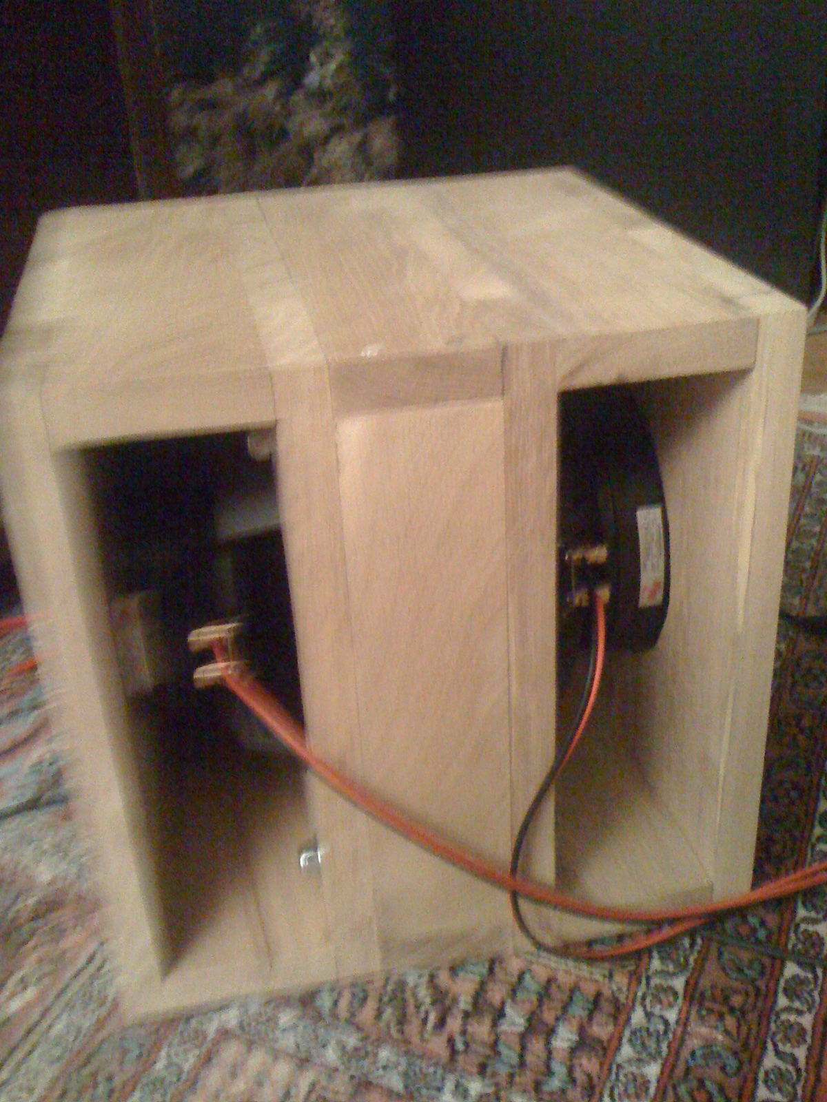

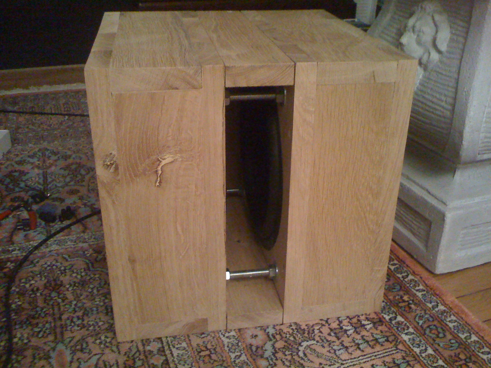

I haven´t messured SPL ,but I use 4 identical amps for sub and planar,and it´s app. same sensivity for each.My sub´s are 12" from Dayton, with passive radiator.
They can take lots of power,crossed at 200 hz.
Bernt
