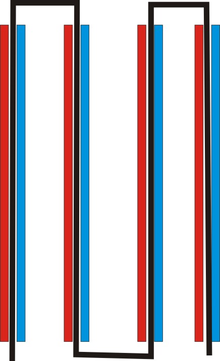

Here is a drawing,wich may show you how the "wirering" can de done.Don´t place "wire" on the magnets,but in the space betwine.You can place 1-2-or 3 "wires in the space,just remember the direktion of the current, shown as arrows.
Good luck.
Båndsei.

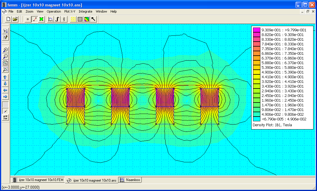

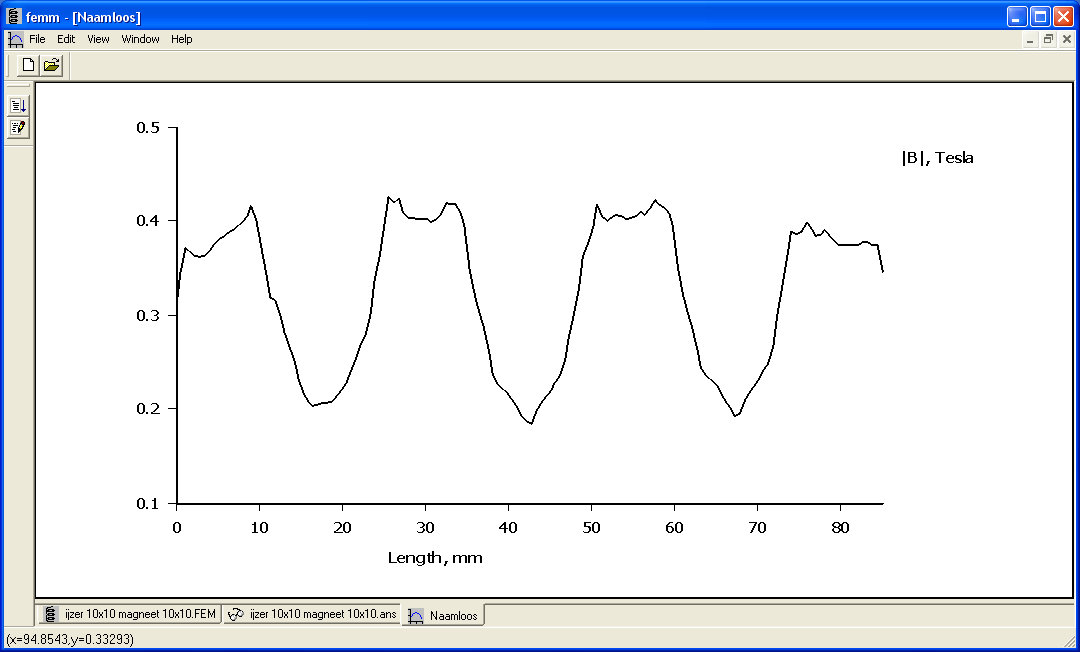

Here is a simm.Distance betwine magnets 15mm.
Resut for 15mm.
Result for 17.5mm.
Tangential flux density is shown.
Her is the simm. for 17,5mm.

Hi Bentl and båndsei
I think båndsei use strange settings and difficult to understand graphs.
Here are mine simulations from båndsei speaker.
The red line is the measurement line and it's 2mm from the magnets.
You can draw the red line everywhere you want to see if the magnetic field is linear enough.
I also attach the file for Femm.
Rob

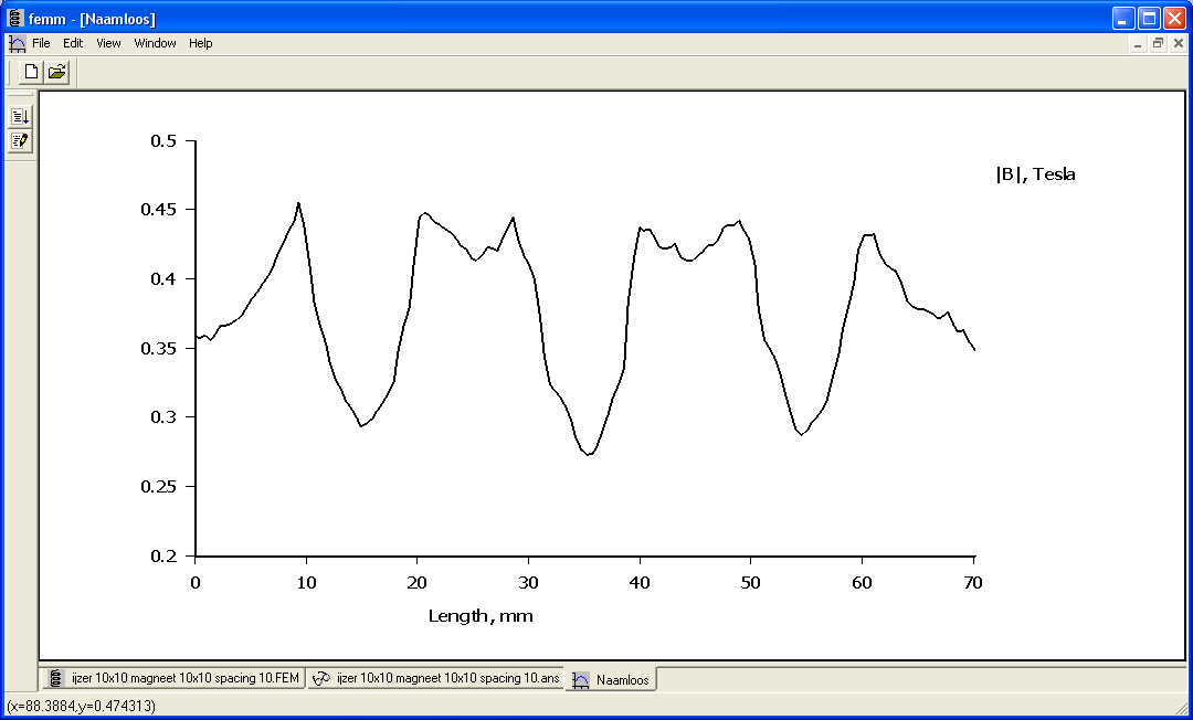

Hi
The above was with a spacing off 15mm and i did a new one with a spacing of 10mm.
You see the difference in drop off flux from about 15mm 0.2T to 10mm 0.3T.
So 15mm is not the best distance.
But from experience with ribbons it helps not much for spl.
Maybe if you use a lot off cross bars you can raise it up or maybe perforated plate.
Rob
