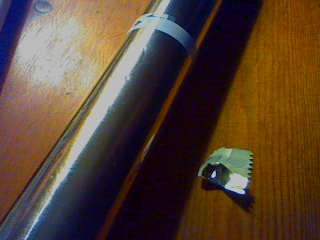

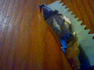

Pure kitchen foil have been used fore DIY planars around her fore a long time
Or should I say it stopped being used a long time ago
Its simply too "heavy", noisy, and results in low impedance
The use of paper backed foil is really a neat trick
Its probably very low quality foil of the worst kind, but it really does works
Im perfectly capeable of evaluating sound 100% objectively, and this material really is capeable to be used in exstremely good sounding designs
Better alternatives seems hard to handle, and only an option fore advanced commercial use, and have been fore years
But ofcourse it would be nice if someone found a way to handle it in easy DIY manner
So far, to me the paper backed food wrapping "foil" seems like the only option
Im not sure whether it will work as interconnects, but who knows

Thanks Tinitus for explaining about the alu/paper.
The paper is to be removed as the foil is in place.I am planning to try Mylar and glue alu/paper on and then remove the paper .Its easily removed with window cleaner fluid.

Here is a link to another planar magnetostat "La Folia". There is some links to manufactores.Planar Loudspeakers Ribbon Foil Speakers Project, magnetostatic design
I have been posting in a Danish site:HIFI4 All Bånd/planar højtalere.http://www.hifi4all.dk/forum/forum_posts.asp?TID=67356&KW=B%E5ndsei
DIY planar
I used Google translator to translate the entire thread. It was not a perfect translation but I think I understand most of it.I really admire your metal working skills and ingenuity. I want to reread the Danish thread again and then would like to ask you some questions. You mention that you removed the paper backing from the foil and laminated it to mylar in the later designs. If this is correct then I could obtain thin foil from a capacitor and wouldn't have to find a source of alufolie sandwich paper.
Some of the later "hardcore fanatics" who used foil from caps, or other advanced foil, actually glued it on to......japanese paper
Glue is heavy, and might present a problem of its own
Some of the problems båndsei have with the stiffer paper backed foil might relate in paticular to his own design, the curved diaphragm
Båndsei loves it, I know that
And it may be important to his design and sound
But the curving itself makes a much stiffer diaphragm, and thus holds a number of complications I dont like
I like the sound tho🙂
With a purely flat diaphragm I dont think the paper backing present any problems, on the contrary
The needed tape is a bigger problem
