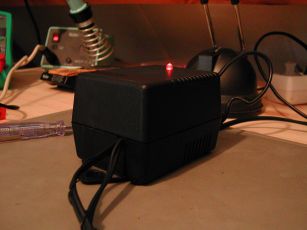

This thread has probably run its course. I'd like to thank everyone who contributed. Peer review, loud and chaotic though it might be, is still really helpful for me to add refinements to a design.
I'm particularely impressed with the dicipline shown by people posting to limit suggestions to those which added materially neither to the cost nor the complexity of the project. Fanboy comments like LM79xx suckx, NE5534 suckx were mercifully absent.
Thanks especially to Carlos for reminding me just how sensitive op-amps can be to seemingly inconsequencial layout changes.
The revised layout is shown below. If anyone thinks they can do a better job pm me. The original file is just an MSWord doc and I'd be happy to email it to you to play with to your hearts content. Credit please, though, if you end up using it as a base for your own work.
To them as don't like the grouding: The non-inverting and inverting input share 0.1" of common wire to the load star. And that's deliberate. I challenge you to find any issue more significant.
To them who don't like the position of the bypass caps. If you aren't going to take the trouble to listen to my side of the arguement there is little point, but once again: 10mm of lead at ground potential is equivalent to 10mm at Vcc as far as lead inductance goes, so its the distance from the power pin to the load return that is important, not the physical proximity of the cap to the power pin.
The feedback loop position allows the flexibility to accept caps of various sizes, using MKS or suchlike it could be slightly smaller but not significantly so. It'll never be pin-to-pin 8mm a la gainclone.
CRC is to first order a simple trade of power supply impedance for lower noise. It would likely also damp to insignificance any oscillation due to layout trace inductance of the kind responsible for the quirky dependence of the sound on capacitor position. Aware as I am of the benefits I an not enamoured with the sonic result. I prefer my power to be both low impedance and low capacitance. YMMV as ever.
Hush now, Peace! (or go make your own layout! 🙂 )
