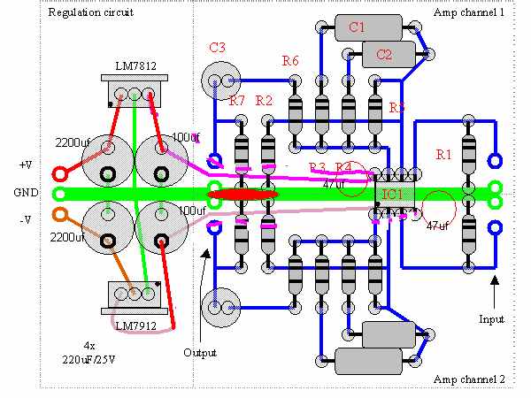

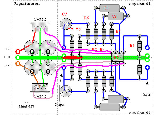

To change the subject a little, what do you think of this then?
VSPS Ultra
It's a little extreme, in the early stages, and may yet be consigned to the dustbin - but feel free to chew into it anyway. I'm not too familiar with moving coils, so expect bugs.

The value of the caps on the feedback loop is too high...
And I don't understand why you put only 220uf before the regulators.
And why 220uf after the regulators.
Better would be to bypass the regulators' output with a small cap and put the caps where they are needed: AT THE OP-AMP'S SUPPLY PINS.
Does it make this simple design more expensive?
Don't think so.
Just better.🙂

I re-wired the VSPS filter caps as shown on the pic below.
The output from the regulator is wired directly to the IC power pin, and this 220uF cap is no in effect wired directly to the IC power pins too.
Granted the leads are still a bit longer that one might like, but any bypass cap would have to be connected to the load return point (the red oblong on the ground next to R7) so it isn't that bad a compromise.
So we now have the IC "directly" bypassed by a large value cap, as Carlos wanted. Simple experiment:
If I'm right then this connection change will make absolutely no difference in the sound. The circuit is equivalent but for a few cm of wire.
If I hear any difference then I'll have to start paying attention to his posts. 😀
Guess what: pretty big difference. Similar but more significant than when I tried bypassing with the 0.1uF ceramics: less treble energy, less noise. The balance of the music is shifted quite dramatically downwards from the treble to the midrange. This time though the naturllness of tone is retained.
Go figure. I'm going to look at the layout again to see what can be done to tighten up the distances.

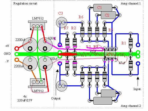

I realise that's what you had in mind.
(Where would we be without MSPaint!)
220uF is sufficient before the regulator to prevent dropouts. I see no point in increasing the conduction angle further by adding capacitance ... been there, done that, sounds bad. Though 2200uF is still borderline ok if you insist.
My main objection is those 47uF bypass caps now create a nice little ground loop indicated by my zigzag line. Noise currents off the power supply are now injected into the op-amp inputs. To prevent that you'd have to take the input grounds back to R2-R7 by a separate wire and that starts getting a bit messy!
Although having the caps physically sung next to the op-amp looks nice and correct, its really a false sense of security. The point the bypass has to get back to is R7. Whether the cap is next to R7 with a lead up to the IC, or at the IC with a lead back to R7, makes no difference to any electrical response.

Konnichiwa,
Yup. Good grounding is NOT easy. It does help to have the supply grounds separated until the star ground and to NEVER use BUS grounding (no matter how tempting). There are several possible neat tricks around this.
I prefer the one where there is only ONE local decoupling Cap between +V and -V instead of the symmerical pair of capacitors. Also consider making the supply lines lower inductance and shorter.
Or you could add some further RC filtering on the supplies, which is definitly good for the sound in more cases than it is not.
Anyway, there are many possible neat options to have clear grounds and layout.

Those 47uf caps are there just because the OPA2134 (or similar) NEEDS them.
I'm talking sound quality here. LISTEN to what you do.
Find a way to optimize the layout, but leave them where they are.
If everything is well, the OPA2132 is MUCH SUPERIOR than the OPA2604.
But you have to give it what it likes.

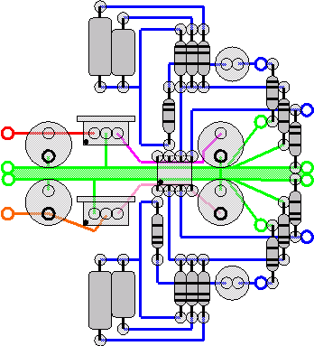

A star ground, when looked at closely enough, is just a short bus ground and for the beginner often as not turns into a mutant hedgehog with wires poking out every which way from out of a 50g solder ball. And since a few mm can be disastrous, I suggest people first learn enough to be able to wire a bus ground in the right order and then work on making it as small as possible.
For a single non-inverting stage it is really easy:
Front to back, we have: noninverting grounds, inverting grounds, load grounds, bypass grounds, regulator grounds, and power supply grounds. Stick with that and no ground loops will occur even if the power supply grounds or the inputs are shared, as in the VSPS layout.
No ground loops, but lead inductance can be a problem with a long ground bus, just as it is for long lengths of wire in other critical places. So the ground bus has to be as tight as possible between the bypass caps and the load, just as the power lead between the bypass cap and the IC has to be short.
Still the components - espcially through hole - are of a finite size putting a limit to how small everything can be made. And compromises: halving one lead length may more than double another for example.
I'll prioritize the bypass cap lead length and see what can be done in terms of a new layout.

Konnichiwa,
If it is THAT then it is NOT a star ground. I usually use multiple star grounds ensuring correct "kelvin returns" (meaning single physically extremely small points where all currents in the relevant loops add to zero) for the local loops. I then "bus" these local stars using low inductance techniques.
Remember, you are in effect amplifying the difference between the two inputs, however especially low impedance feedback networks inject substantial signal currents into the "inverting ground". Bus groudning is thusly entierly inaproriate.
These again form current loops with significant signal current impressed and care should be taken how they are arranged. I prefer seperate PSU buses with each rail fully separated and the only "joining" of the various current loops at the load ground, which in effect forms the high level star.
Sorry, I can see at least three unwanted current loops that cary signal currents. This is less relevant at low levels (as the currents involved are small) but can lead to plenty of problems even there.
Hence the best solution is to keep any given curent loop seperate untill it is functionally essential to join them up.

rjm said:load grounds, bypass grounds, regulator grounds, and power supply grounds.
rjm said:Stick with that and no ground loops will occur even if the power supply grounds or the inputs are shared, as in the VSPS layout.
rjm said:Still the components - espcially through hole - are of a finite size putting a limit to how small everything can be made.
Sayonara
You'd better heed Kuei's advice about using CRC filtering after 78/79s. These are noise regulators, and with all-in-one-go phono stages at MC sensitivities, opamp PSRR is mostly an illusion.
The very best single 5534 phonostage I known happens to use a CRC with R a whopping 75 Ohms. Don't remember the cap values. Might be 1000uF and then 100uF.
