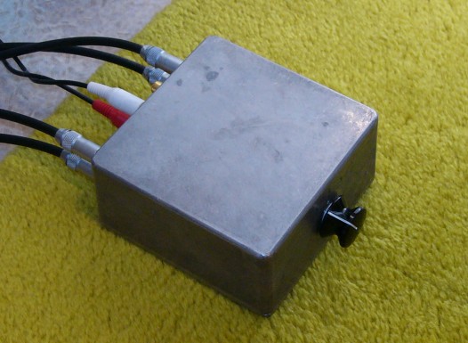

Here's mine. 3 position 4 pole switch. I have three inputs but only a single output and I switch the input grounds as well as the signal wires. With 20/20 hindsight I would have probably added a second output to use with my headphone amp, as you have. Oh well. The case I picked is too small for a retrofit. /R
