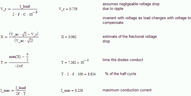

I have made an estimate. The image is from the MathCAD worksheet. I mgiht be off by a factor of 2, but it makes the point.
Assuming the VSPS draws 20mA,
-with 6800uF capacitance, the diodes conduct 2% of the time, and the maximum current is 1.2 A.
-with 220uF capacitance, the diodes conduct 10% of the time, and the maximum current is 0.2 A.
My arguement is that 1A current spike in 200 microseconds (vs. 200mA in about 1 millisecond) does more to mess up the sound than the ripple reduction from 750mV to 25mV p-p does to improve it.

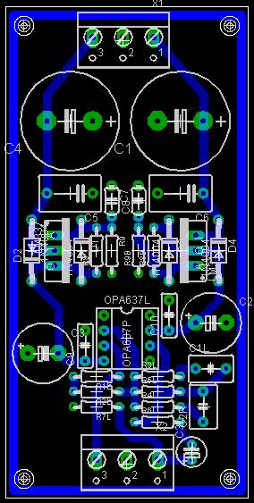

I want to make this design as my final for my preamp...any comments or suggestions before I etch it?
It:
- is dual mono with a ground plane
- uses LM317/LM337 regulators per channel
- has power at one end, signal at the other

If the vsps draws so liitle current, what's the advantage of using a large transformer?
That's an interesting one. First, "because it sounds better". I'm pretty confident on that one, having tried various transformers in many different situations. But, whats the "why" behind it? There I'm still out of my depth. I haven't figured out a really good reason.
One possibility is the lower impedance and/or larger magnetic core and/or better regulation. I frankly admit that's hard to justify, given the minute load currents.
Another is that larger transformers are better able to filter out power line noise. Well, maybe, but...
My best guess is related to the conduction angle discussion, in that the bigger trannies are better able to absorb the diode switching noise and current spikes. Something about LC tanks and what not. Emphasis on guess.

PS. The PCB looks fine, MAXW, though I didn't go through it rigorously.. Provided you know that those are the sizes of components you will use, I'd say give it a shot.
