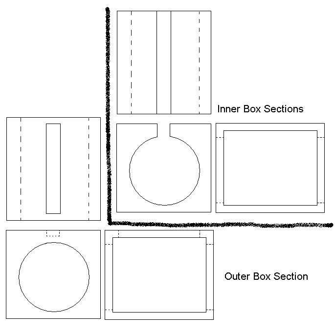

Bill, referring to the cutaway drawing you posted, have you thought about how you would get the wires to/from the VC?
I think we could borrow from Adire's excellent thinking on the matter and use a leg of the metallic "arachnid" spider as a signal pathway. 🙂

Here's a pic of what I was thinking the box sections will look like, if slots need to be fabricated to allow the VC leads to travel back and forth.
Good idea. Somehow I thought that the wires would have to go away from the former right away. If the gap is big enough to run the wires through, having them attached to the former and run out to the spiders should work fine.

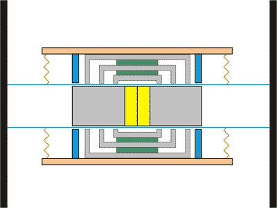

Bill F. said:
Bill F has attached this image:
Bill, it appears that you are a man who has been struck by a stroke of genious!
Of course, it all does really depend on the availability of the metal... and whether we can really mate them up tightly enough that the flux will flow freely between them... and there's also the possibility that the thickness of the metal walls for those square tubing pieces might progressively be thicker, proportional to the size of the tubing.
It's also got to be available in just the right sizes... even increments... so that our gaps are actually evenly spaced. 😉
And, I'm wondering if you FEMM'ed this design?
It seems to me there's the possibility of the magnetic flux being stronger on the side of the round hole cut in the steel that's closer to the wall of the tubing, as opposed to the sides of the hole that are facing the opening of the tubing.
Just some concerns that I think need to be thought through.
But as I said, I think otherwise this is a stroke of genious! 😎

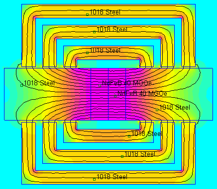

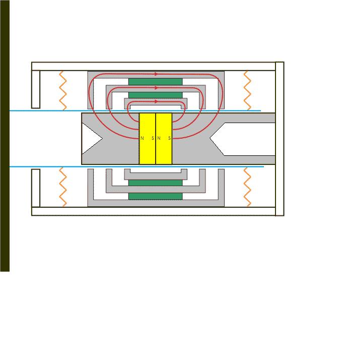

Vikash said:
I think I've finally figured the motor out. I've highlighted how how I think the circuit works (please confirm), and also a more symmetrical support leaving the diaphragm better exposed. Supporting the pole piece may require some additions.
Could you cut away some of the material in your pole piece like XBL^2 does? That should reduce some stray flux and flatten out your BL curve.
Also, maybe it has been said earlier, but what is the point of having the flux flow in opposite directions? Why not send all your flux into three gaps and use a single coil? This should reduce inductance quite a bit in the design, reduce cost, size, and still offer an extremely long throw.

The flow of flux in two directions assumes that the VC's will be wired in opposite arrangement to each other right?
Right again. It amounts to siamese-twinned motors joined at the buttocks. 😉

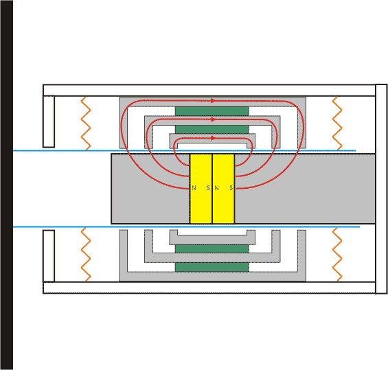

Bill F. said:
Vikash,

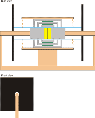

I just hope we can get away with supporting that long, heavy pole at only one end...
I have a limited understanding of flux flow, but it seems to me that you could machine the pole piece like this to without compromising the effectiveness of the magnetic circuit. It would however greatly reduce the moment acting at the attachment point.

Eric,
Yup, that would work just fine. You could remove even more material without affecting flux flow--FEA could tell you how much.
Only trouble is the additional cost of the boring...

Vikash,
Thanks for doing that plot and saving me the trouble. 😎
It's a great illustration of another side benefit of this topology. Notice that when one coil is entering the slightly higher flux density of the inner gap, the other coil is entering the slightly lower flux density of the outer gap. The net result cancels the difference! Isn't that just divine? :angel:
PS. Looks like you spec'd 1"-thick structural steel tubing--might be kinda hard to find in that thickness, and a little heavy, too...
