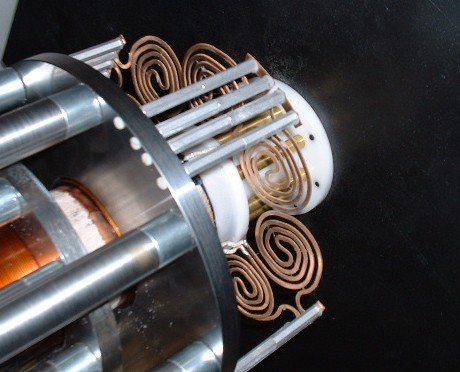

I also have qualms about a spider in front of the diaphram. Seems like a recipe for some air turbulence noises at high excursions. Maybe that is an unjustified concern. As far as limiting the use for pure dipole application, I don't see that really being the case. If you can put one diaphram in a tube or box "cylinder" and let the diaphram sweep like a piston, I don't see any reason why you can't do the same with two. The cylinder would be longer, but this thing isn't exactly meant to be a space saver anyway! 🙂
I've attached a picture of the Parthenon's "Arachnid" suspension.
You can see it's size is relatively small compared to the size of the diaphragm, and it's also relatively open, allowing adjacent air to pass. As it reaches higher excursions, it opens up even more...
There's nothing causing an increase in airspeed over that velocity that the cone reaches itself, and we aren't taking a mass of air and compressing it to higher pressures (both of which are the problem with noisy ports, for example)
Regardless, we'll need at least one of these things on the sub at any rate... so if there was noise, we're not avoiding it by only having one spider, as opposed to two. 😉
Also, we could actually improve things by having two spiders of this type, one in front, and one in rear of the cone:
The "arachnid" spider as Adire used it had eight 'coil springs' if you will.
If we believe we could accomplish our target suspension stiffness with one spider... one set of these eight 'coil springs'...
We could allow for even more airflow (and less noise, if it occurred) by arranging this as four springs in front - and four springs in rear. :wiz:
I think having a spider both in front and behind the diaphragm is actually in keeping with your goal of ensuring as little air-rushing noises as possible. :usd:
:att'n: Possibly Dan could comment though, on the likelihood of even fundamentally having air noise past the springs?
I personally can't imagine that would be an issue, just fundamentally.

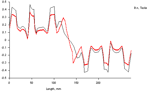

RHosch,
I thought this was interesting. The one magnet version of what I've been modelling is only ~0.1 T down in the gaps then with two magnets. Smaller disk magnets may do equally ok, but there goes the option to vent the pole piece...
Edit: infact I think the 3" magnet works out better with 1.5" contact area on each half vs 4.25" ring which works out to 1.25" ((4.25" OD - 1.75" ID / 2). Plus the 3" magnet you mention is 0.05" thicker. This is all at the expense of the pole vent possibility though.
Red line: 1 Magnet, Black line: 2 Magnets
