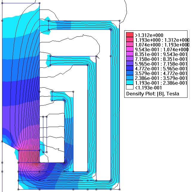

I spent a few hours of mine tweaking models and running simulations, so now it's sharing time.
A few posts ago, Dan W. made a case for a motor topology with three gaps and one coil. I agreed with him in principle, but I have also been flirting with the less-conventional 6-gap, 2-coil DDD topology (essentially a symmetric siamesed arrangement of the conventional motor in which the VC passes completely through, allowing spiders and potentially diaphragms on both sides of the motor).
So I decided to optomize both topologies and bench race them.
I chose a common set of denominators:
--Identical coil lengths, spacings, and 0.8" sq. total coil cross sections (=same wire and number of windings in the real world)
--4.24" dia. poles of 1018 steel
--1/2" 1018 steel return circuits
--Identical NdFeB ring magnets
--1/10" minimum clearance on both sides of coil/former
--1/10" former wall thickness

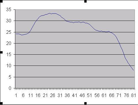

I started with the conventional tri-gapper.
2/10" clearance + 1/10" former + 2/10" coil thickness gave me 0.5" gaps, very close to what Dan recommends.
When I put the model through its paces and generated a BL plot, it looked like this:
(Continued in next post...)
As you can see from the plot above, flux flow seems to diminish as the voice coil progressed from inner gap to outer. (The degree of change suprised me. I suspect it may be a compromise of the 1018 steel--I'm still learning.🙂 )

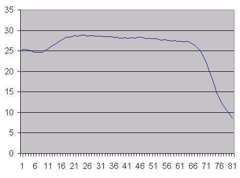

In an effort to flatten the BL curve, I spaced the inner gap at 0.7", and the middle at 0.6"
