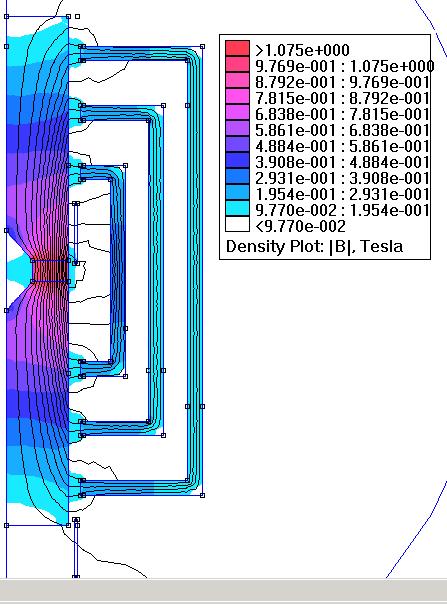

Next, I slammed together the DDD version. 2/10" clearance + 1/10" former + 1/10" coil (x2, so total coil cross section is preserved) = 2/5" gap spacing.
(Continued in next post...)

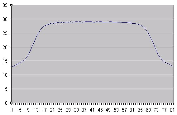

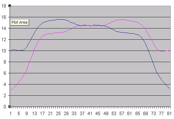

However, since they were mirror-image and superimposed, they summed to an amazingly flat plot--the flattest I've ever personally generated. 🙂 Like the other motor, BL is around 29 Tm.

Summing up:
It is true that I penalized the 3-gapper by adding extra gap spacing, but it was a matter of necessity to flatten the BL curve. Keeping an eye to simplicity and expense, we could certainly explore other 3-gap architectures that might manifest less BL variation.
The nice thing about the DDD topology is that it turned those stair-stepped BL curves against each other and netted an extremely well-behaved plot. (It looked so good, I checked myself a couple times to be sure it wasn't a fluke!)
This tells me that the DDD topology is suited to my inexpensive nested square tubing approach, where the Tri-gapper may not perform to its full potential. At the very least, it tells me that the DDD approach should not be entirely discounted, as it seems to perform equally or better than the tri-gap in this situation at equal minimum clearances. And I'm convinced the DDD will always return a significantly lower Le.
Dan earlier pointed out that deeper motors generally need more clearance. I can see how this is especially true with topologies (like the tri-gap) where the VC is supported on a single end and cantilevered into the gap(s). In that case, any radial deflection of the spider is proportionally magnified by the cantilever.
However, when you support the VC former on both sides of the motor, radial VC movement is limited to no more than that of the spider(s).
I'm not saying we necessarily should do this thing one way or the other. I'm not personally sold on one over the other just yet--I just wanted to point out that it's a closer race than some may think.
Just my hundred and two cents, folks...😀

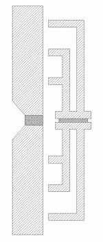

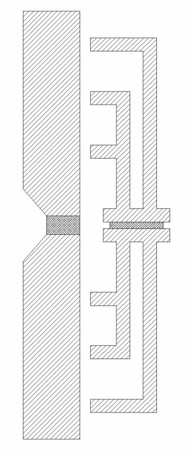

Cross-sectional area... good. The following image shows a 2" x 2" x .25" N40 magnet in the return path. This would require some welding, but the primary return path structure is still comprised of standard box sections. They are simply ripped in half, and welded to two plates that sandwich a line of these 2x2x.25 magnets. Lots of extra surface area... magnets are less than $15 each, so relative to the rest of the project cost not bad.
The reason the first two gaps share a return is because to provide room for a 4.25" ring magnet in the pole + adequate gap width required the central section to be rectangular and turned 90 degrees to the other to avoid interference. However, with an axisymmetric FEA I figured you could just model a common return path for a first rough cut.
The section sizes I used were 8x6, 10x8, and 14x10.

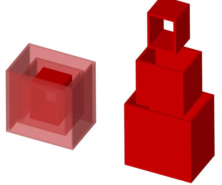

To get a better idea of how the three box sections are arranged, here is a rendered image showing them assembled and disassembled. This doesn't show the hole for gaps, nor does it show the central plate gap for additional magnet area. I'll have to add that tomorrow.
Now that I think about it, magnets in the return path are really only a form of stacking magnets, except that in this configuration you could get much more surface area than a magnet inside the former/pole piece. Which makes you wonder if it would be more cost effective to abandone the pole piece magnet altogether ($100) and only use magnets external. Not nearly as nifty looking, but perhaps more practical. 🙁 🙂
