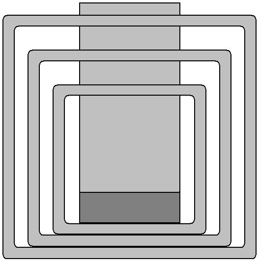

So now we may have a competing motor design.
Three or even four gaps can be cobled together if we put some ingenuity towards it. The machining is not rocket science. The only part of the motor design that bothers me is using enough magnets to force a saturated field at each top plate pole piece junction. But not more than needed. And the size of the piece of steel needed tomake the pole piece. The top plates can be cut from plate if needed and the turned down. But that pole piece is going to weigh what 10 to 12 lbs yikes maybe more ( time to get out the slide rule )

Another decision...Triple gaps work, as do quad gaps, 5 gap, etc. Simply increases the cost and complexity of the motor. And the diameters of the plates start to get big, unless we play some fun games with dual gap plates hung off of each row of columns. Simpler way to do this is to use dual or triple gaps, and dual voice coils. Many supply houses will do small runs of voice coils custom wound - not cheap, but doable.

Dual coils, dual gaps are more difficult to design, but less expensive in terms of machining.
If someone has a fantastic hook-up in terms of machining, that's one thing... but how are we managing these expenses?

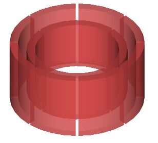

Bill, Dan, I have a question about motor design fundamentals.
Why are magnets polarized N/S on their faces (assuming a ring shaped magnet, as is typically used in speakers, and even in the Parthenon) used in combination with ferromagnetic metal to complete the magnetic circuit on either side of the gap? In particular, why is the pole piece just ferrormagnetic metal? Why not magnetic material?
There are NeFeB magnets that are arc shaped, polarized N/S on their curved faces. If these were used to assemble two complete (near complete, anyway) rings to produce a gap - one ring outside the VC, and the other inside the VC where the pole piece typically is - would that not significantly increase the flux density? The motor structure could then be machined out of aluminum or other non-magnetic material.
For example, this is the kind of arc segment I had in mind:
And below is the arrangement I had in mind, though with the magnets I first found the VC would be limited to less than 2". I'm sure other arc segments are available or could be manufacutured.

RH, to add to Bill's comment...
The first image shows how two naked neo mags result in non linear flux across the gap. The second illustrates what happens when some ferromagnetic metal (trapezoid) is used to concentrate the flux into a small gap = increased flux density and increased linearity across gap. Also a standard return circuit provides a path connecting the poles, thus reducing stray fields and requiring less magnets.

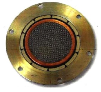

RHosch's last post of concentric arc'ed NdFeB is similar to the magnetic bearing in my push-pull motor sketch. For a bearing, the inner magnet would be much longer.
This image is the Aura Neo Radial Magnetic motor. The center cylinder is the steel pole piece that runs down and is attached to the outer cylinder-ring for the complete magnetic circuit. The next concencentric ring is a copper Faraday ring to reduce inductance. The ten arc segments outside the gap are the NdFeB magnets. NdFeB is brittle and difficult to machine. It would be difficult to manufacture an NdFeB ring to tight tolerances, and hence multiple arc segments are used. This topology offers a very uniform magnetic field over a long underhung coil length. The physical former and coil can be shorter than the JBL Differential Drive, and this can save mass. Also, the radial field and having only one magnet to metal interface gives good efficiency and field uniformity.
Seas Millenium tweeter uses a similar radial design with 6 rectangular bar magnets.

...An excellent segue to my first back o' the napkin sketch of how we might save money on the motor structure.
Remember how they used to do AlNiCo motors with a section of square tubing serving as the return circuit? This is the same concept to the 3rd degree.
The picture below is a side view of a tri-gap motor composed of a 4" dia. cylindrical pole, a 4" dia. puck of NdFeB (available on Ebay! 🙂) at the base of the pole, and three nested sections of square structural steel tubing, (available, perhaps, at your local salvage yard).
This design would cut way down on both material and machining costs. Properly executed, this circuit could have all the functionality of the Partheon motor, with none of its beauty. 😉
There is also the possibility of a Parthenonesque design compromise that would use square plates and pillars which would be cheaper than the Parthenon's cylindrical machinings.
