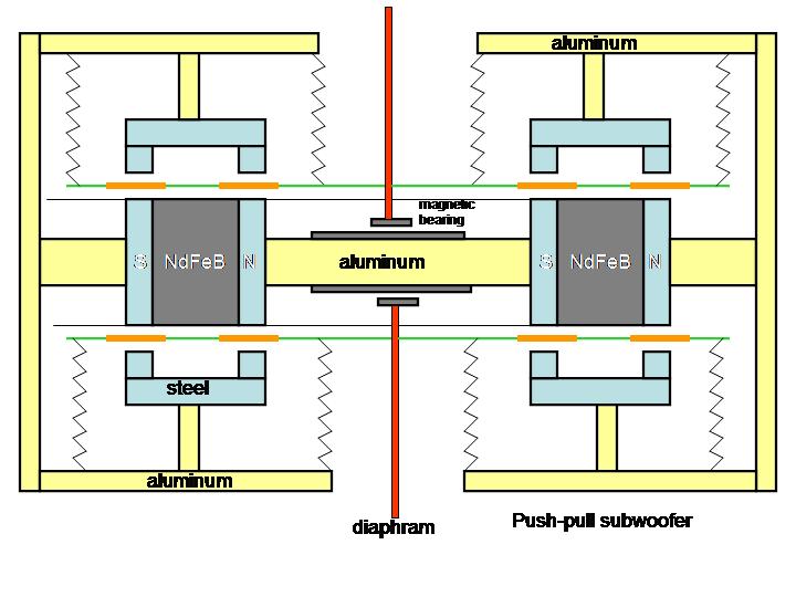

PUSH - PULL MOTORS
How about a PUSH - PULL design with the diaphram between two motors?
No suspension for restoring force would be necessary, each motor could be half the power, distortion would be lower due to even push-pull forces and canceling non-linearities between the motors.
I think a magnetic bearing would also be easier to design around a push-pull topology. Circular arcs of NdFeB magnets are available. One long circular arc'ed magnet between the two motors for the inner bearing, and a larger diameter circular arc'ed magnet attached to the center of the diaphram - long enough to provide enough leverage to stop angular diaphram movement.
I would also build the push-pull JBL Differential Drive motor with front and rear spiders Very low distortion, very low Le.

Push-pull Motor

Mr. Dan Wiggins. My only question is how close are we getting???? And do you want to reveal all?? ( your design ideas in principle not exact specifics )
Mr. Linesource I like the idea. It will cost twice as much. Weigh twice as much. Will we get a double benefit in canceled even order distorsion??? And will your magnetic bearing idea work???
Can you give a bit of an explanation?? For the bearing. The rest makes sense.

You're plenty close - it's a pretty standard buildup - one motor, one suspension - that we used, just used some of our patent pending approaches for the motor and suspension.
What kind of details do you want? One thing to be aware of with the dual gaps in opposite flux polarity, it is patented by HyperDynamics, and used in multiple licensed models. Building a patented product - even for educational/instructional purposes - is illegal. As such, I'd recommend not using the approach shown in LineSource's post.
When the patent issues for our XBL^2 motor approach, I will waive prosecuting patent infringement for non-commercial applications related to this thread. So it's a "safe" way to go here...🙂
With that said, note that even/odd distortion from motors is related to BL nonlinearities over excursion. A flat BL motor like the XBL^2 approach makes using a push/pull arrangement essentially irrelevant.
Magnetic bearings can work, but they need to be pretty far out from the motor itself. Note that if the voice coil moves over the magnetic bearing (or even gets close to it) the BL of the driver will change. You can't have your magnetic bearing near the motor parts. And with high stroke, that means you need to be quite a way from the center of the driver. Thus the reason we chose the simpler approach of a slip ring. Properly machined, it's close enough to eliminate chatter, and once waxed (only need to do every thousand hours of operation or so) it is remarkably silent.
Front and rear spiders as Chris (Geolemon) espouses also works, but you'll still want a guide of some sort. We used the lightest materials we could find, and still had an Mms of 800 grams. to work with spiders, you'd have to have a decent stiffness, which would raise the Fs and Qts of the driver. So, to keep Fs down to the single digit range, we used a really soft spider setup, and the mechanical bearing for support. Note that efficiency is strictly BL and Mms, so keeping Mms down was imperative for us (efficiency of the Parthenon as is clocks in around 97 dB @ 1W, 1m, thus the reason it jumps 2.5" one way with a 9V battery).
Triple gaps work, as do quad gaps, 5 gap, etc. Simply increases the cost and complexity of the motor. And the diameters of the plates start to get big, unless we play some fun games with dual gap plates hung off of each row of columns. Simpler way to do this is to use dual or triple gaps, and dual voice coils. Many supply houses will do small runs of voice coils custom wound - not cheap, but doable.

The magnetic bearing will change the Le and the Bl of the coils. Not something you want!
We want a stable as possible Bl and as stable as possible Le. Sapping motor strength and having a variable inductance is plain nuts. More potential sources for IM distorsion are not what a moving coil transducer needs. A good motor design has enough problems to begin with. This design seems to minimise some of them by allowing a flatter Bl curve. Thus the purpose of multiple gaps.
