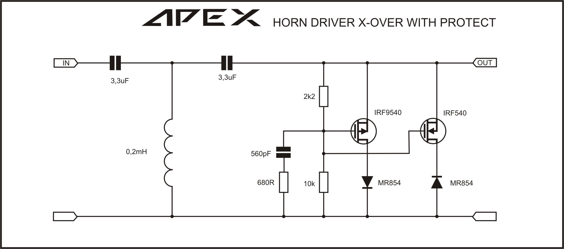

HF X-OVER + PROTECT

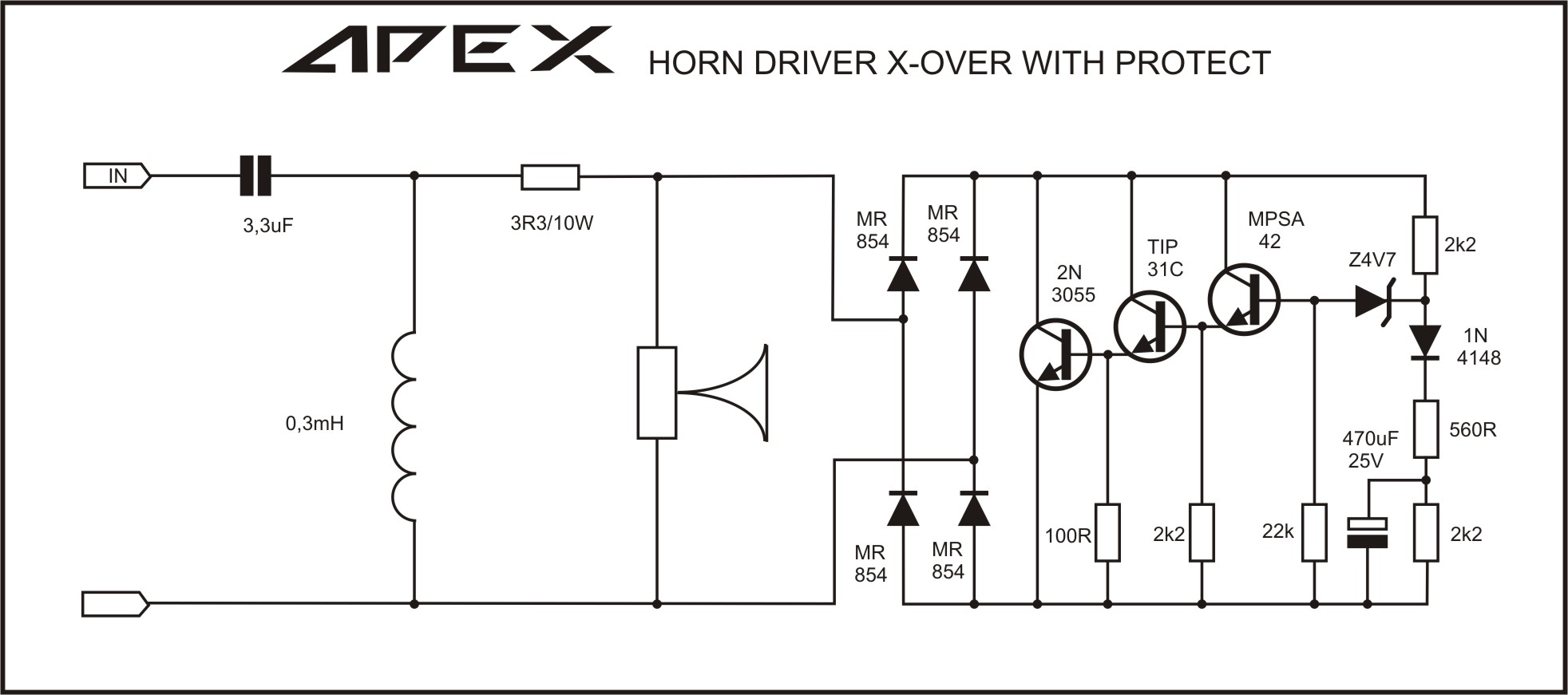

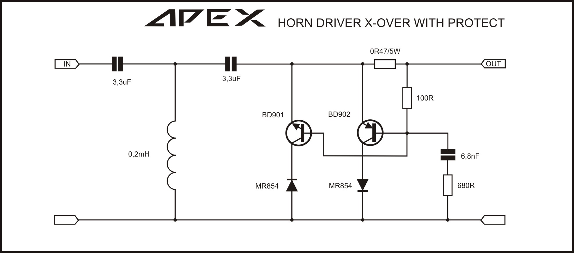

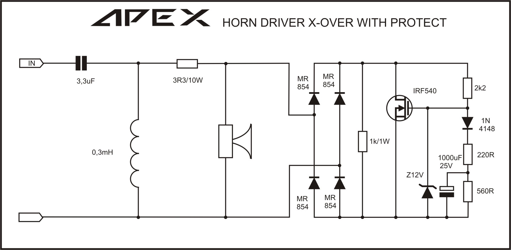

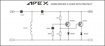

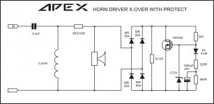

X-over circuit with fast mosfet protect for horn drivers.

It just clips them. Won't that 10 watt resistor go smoke if you run the thing continuously in protect? DJs have been known to do that. I'd beef it up to a pair of 20 watters in parallel - and don't forget to heat sink the power transistor.
Yes resistor must be 40W if power is continuously double than maximum (25V RMS on driver), I forget protect from DJs 🙂
