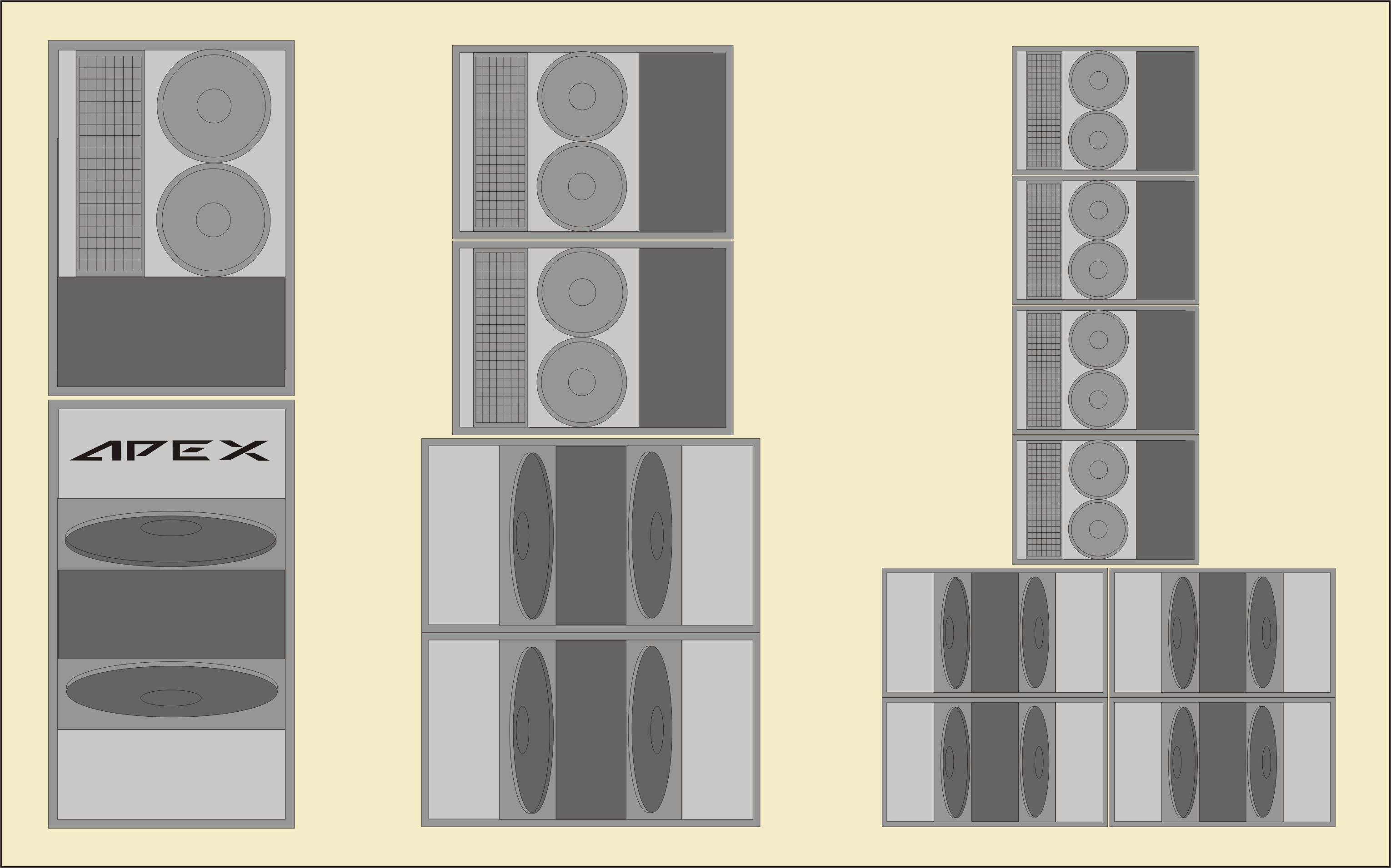

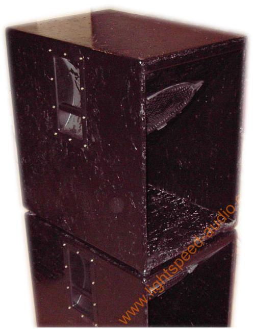

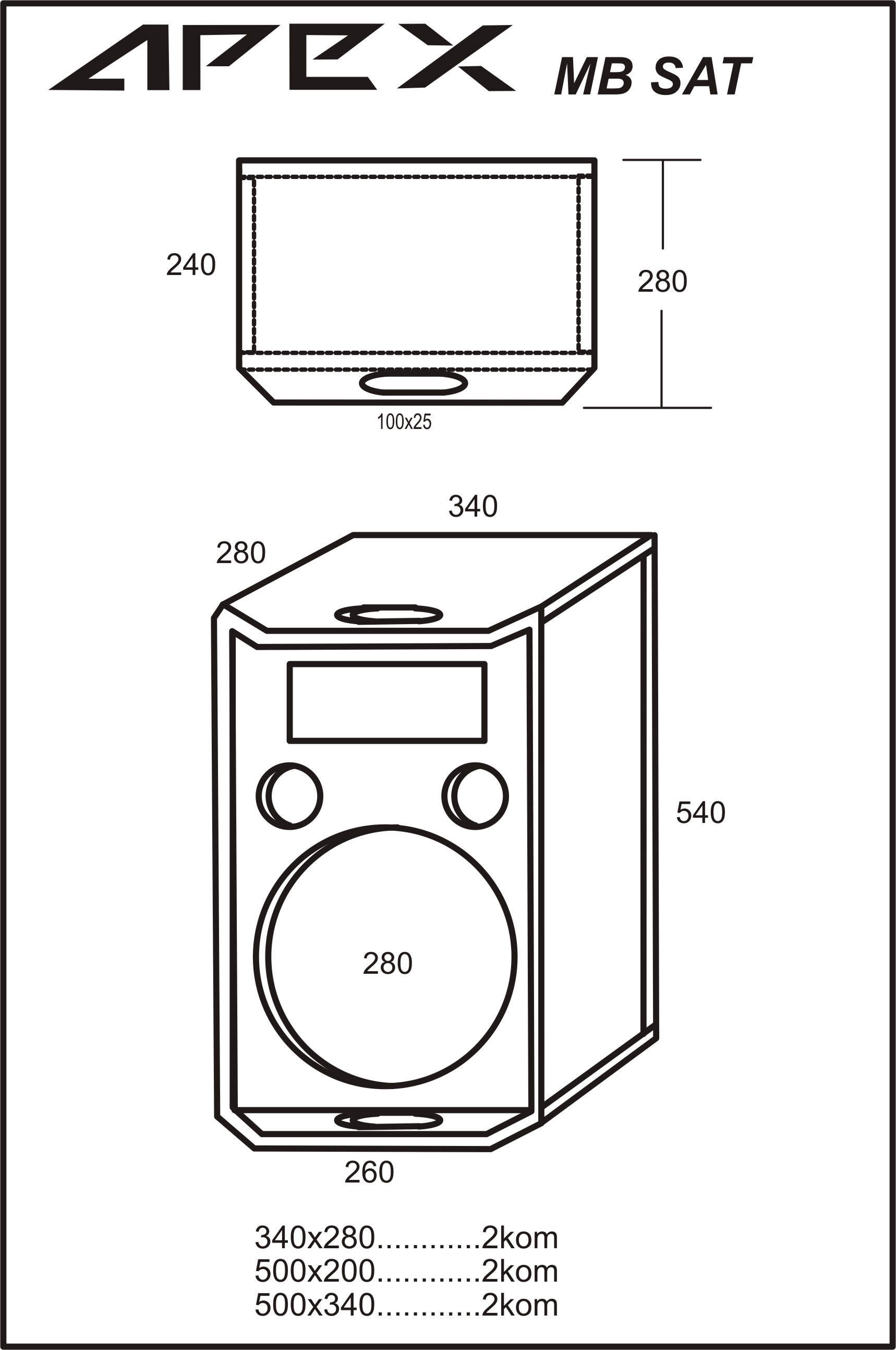

Rotate angles are 5deg and 10deg.

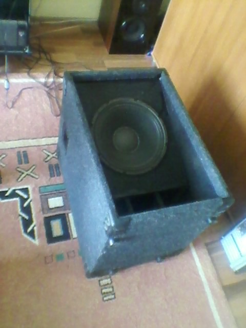

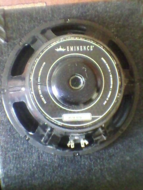

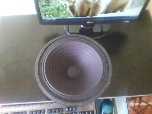

I am currently using Eminence 12LF in some subs, but I would hear them also in 2 way box, so can you now tell me what diameter for tube and how long should I use in your project? For Ei and Eminence.
