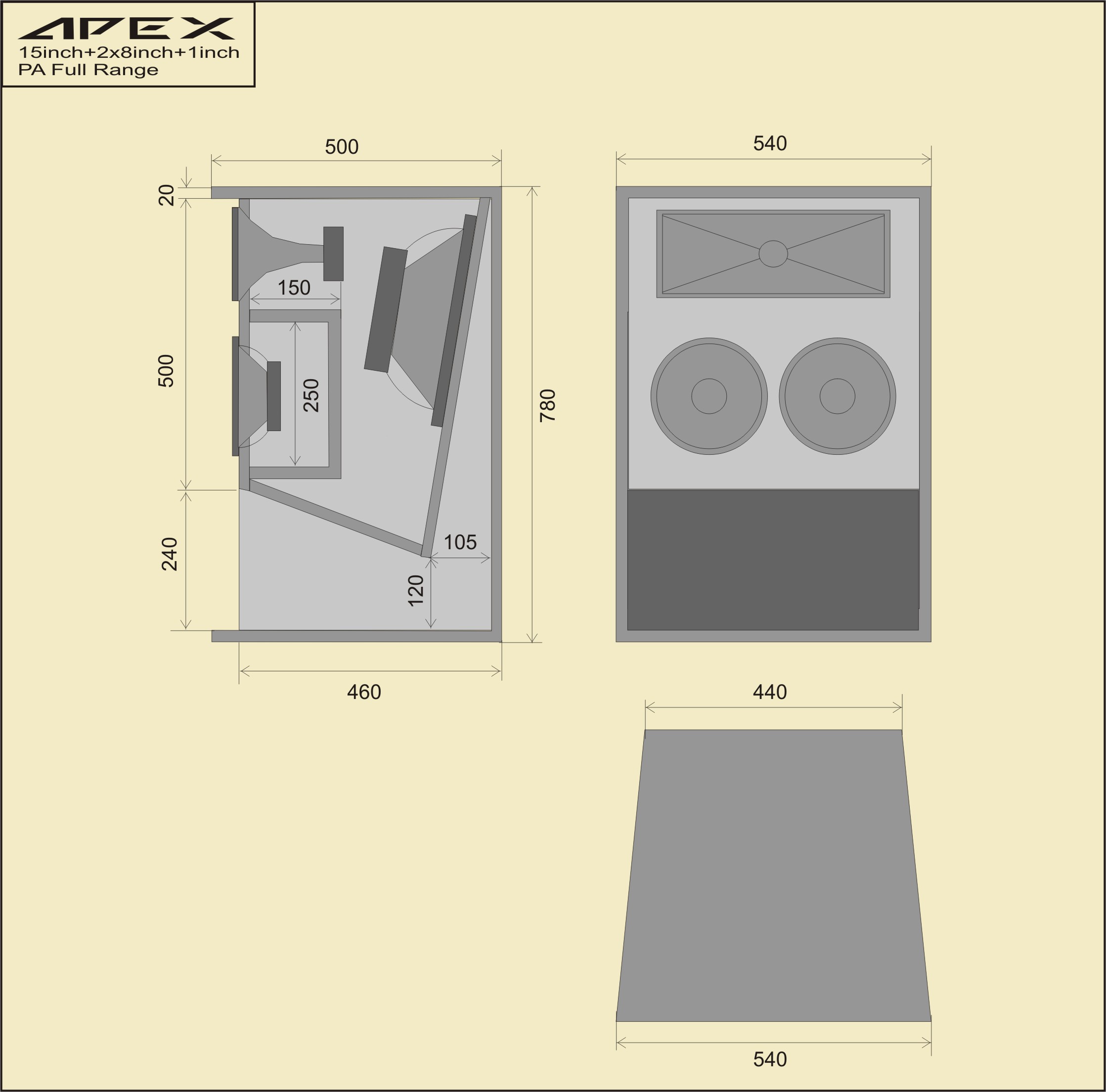

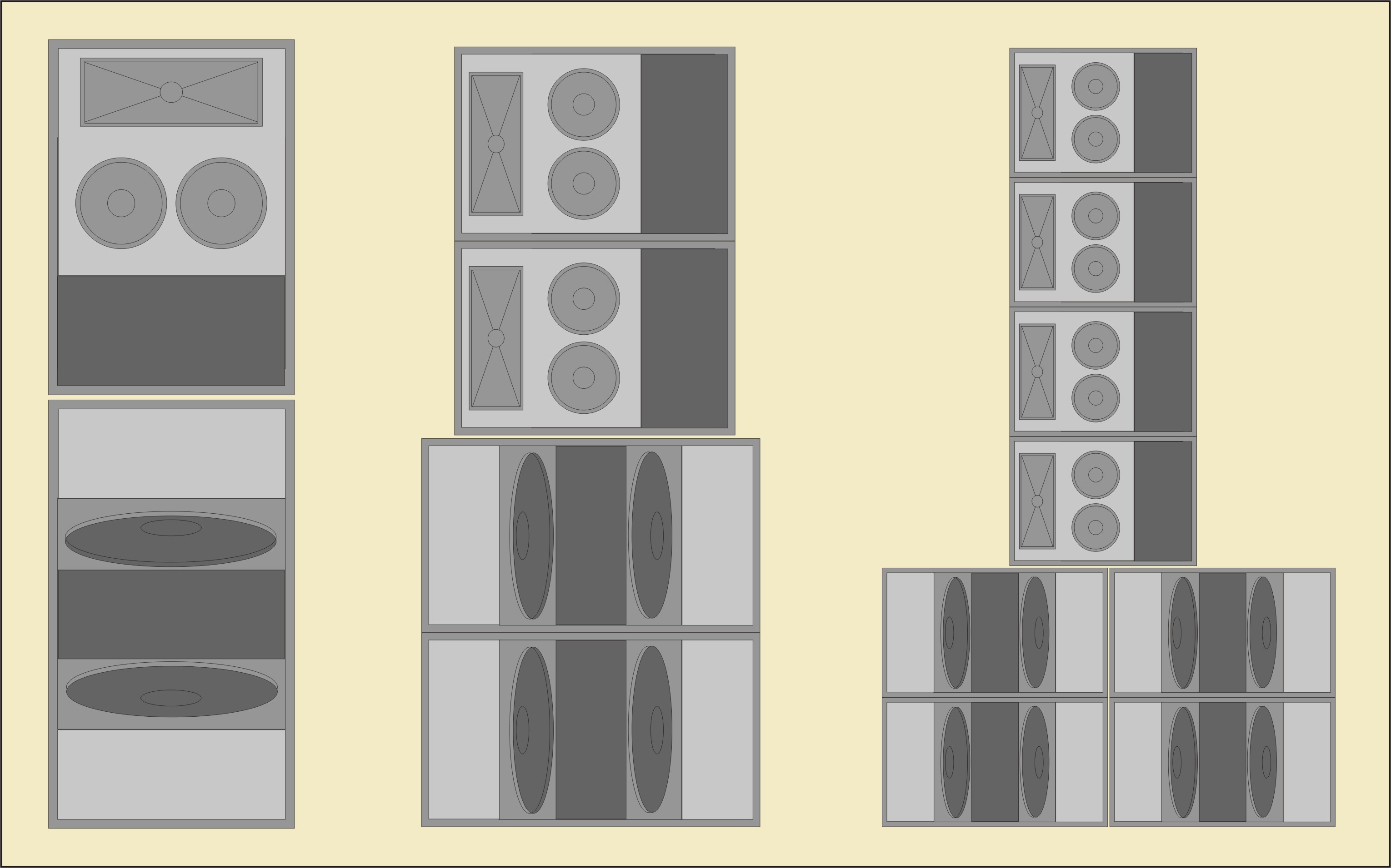

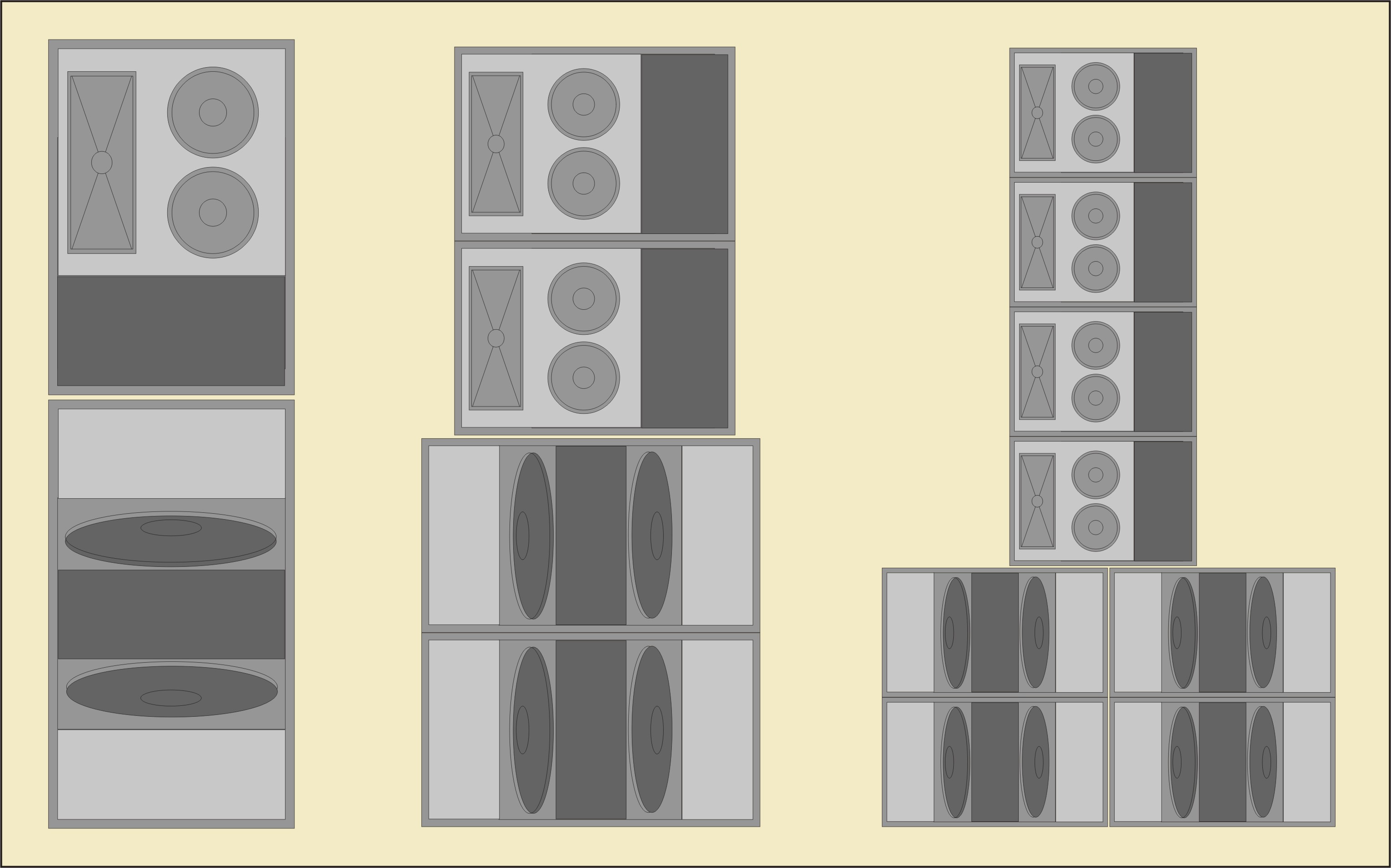

DIY PA Speakers for general purpose or Line Aray.

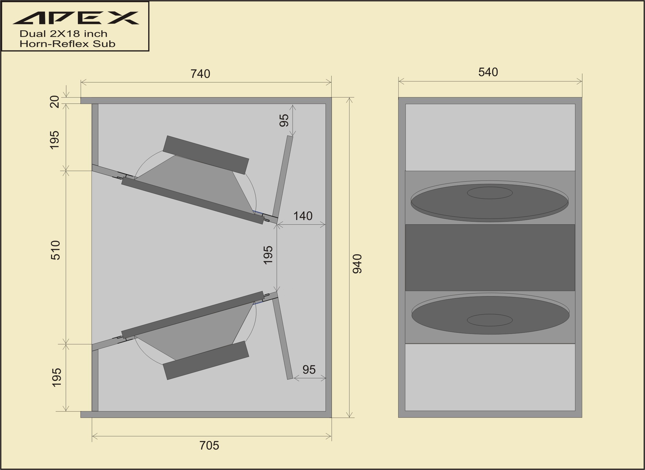

Dual 2X18inch Horn Reflex Sub (40-200Hz)

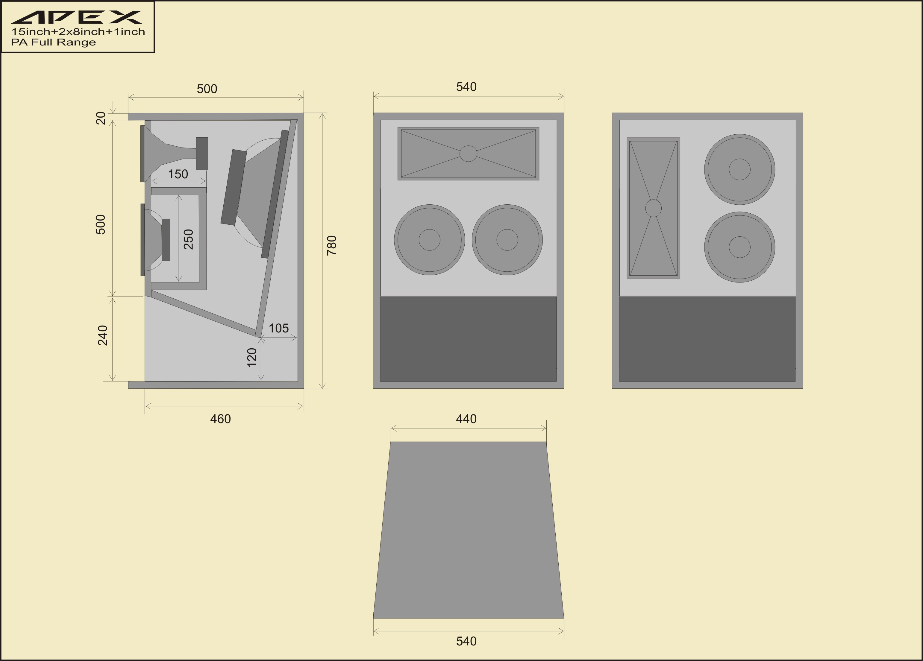

Three Way Full Range (80-20000Hz) 15inch bass horn + 2X8inch mid + 1inch HF driver.
The bass horn looks like it will be a big cancellation mess from the back wave and the midbass 15 horn looks like it's an upper mid horn. Maybe you should look a little deeper.

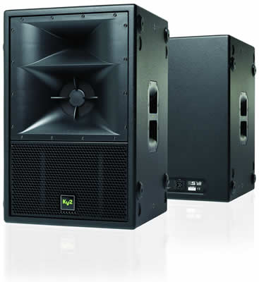

Similar bass horn, and midbass horn you can find in many brand speakers: KV2, EV... and it's work, there is nothing realy new. Dynacord 'Cobra' is compact line aray speaker system, and this suggest DIY sistem can be compare with Dynacord, but useing more available speakers for many diyers.

You spoke like salesman (don't try to build line array it can't be made you must bay it), but diyer with some skills can make usefull 'line aray', and save lot of money. Diyers build two way speakers (15inch + HF) all the time, only for a few hours, and this is just next step.

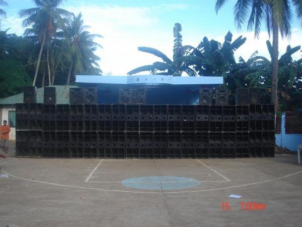

Give some advice to this people
Regards
I'm not gonna build 'em !
You don't need 'em, but people who put 40 subs and 10 two way suts over need some advice and suggestions 🙂
Well, they are W-Bins. Don't get me wrong, I've had a lot of fun with them, but you often need quite a few to get the job done.
For the line array, keep in mind that you cant use just any CD horn. It must be very carefully chosen to work well with adjacent boxes. Some use multi-varying length throats to focus the energy, some use several drivers with rib-like structures built in front of the drivers to do the same. There are several designs in use out there, but those are the ones I work with day to day.
Just take a few minutes and model your ideas in Mr McBean's Horn Response program. It's pretty darn accurate Hornresp
CD horns for line array is available, but it's still bigest problem. I not suggest W-Bins, I suggest horn reflex like EV phenix PX2181 or old MTL1X.
I use similar horn like KV2 in EX1, modeling not meatching with real life.
Indeed. The old MTL subs are still well respected, even if no one likes lifting them.
I suggest sub with more compact size than usual for two 18inch speakers.
Front panel (500x500mm) with mids and CD horn can be rotate 90deg angle, if use one box in setup.
What does meathing mean? Do you mean when you model the KV2 it does not perform like the Horn Response model? Are you using it and modeling it in half space?
