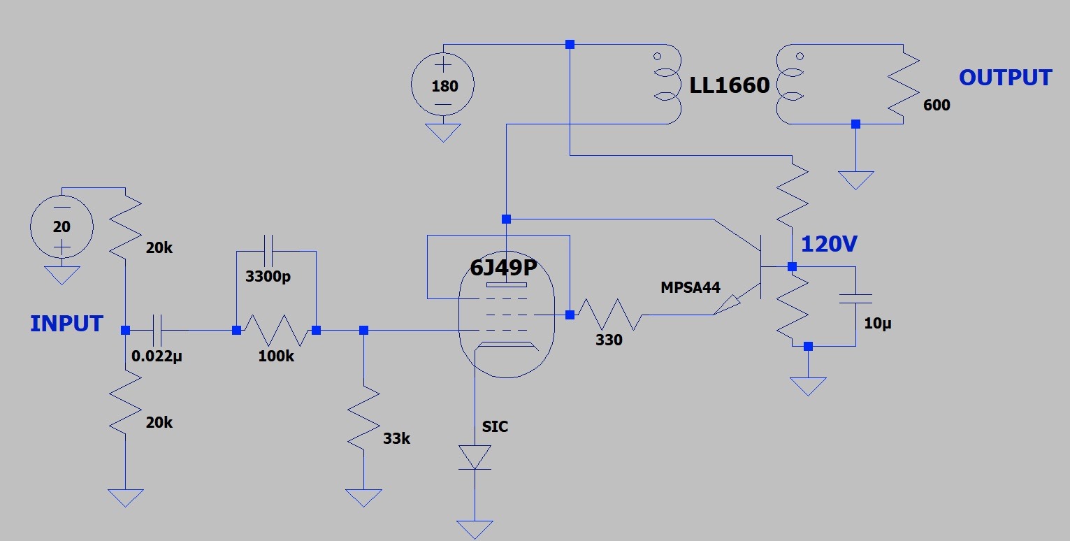

I just got the DS-E1 and made single stage preamp.
My speaker has active woofer with integrated subsonic filter so I didn't build that part.
It's an interesting entry level cartridge sounds more like CD but more detail.
If budget allows would recommend 003 as I am missing the resolution from exotic stylus (shibata/sas/micro-ridge).

You using the DS document on powering/EQing the cart? This is the latest one I know of: https://ds-audio-w.biz/cms/wp-content/uploads/2021/11/Technical-information20221212_c.pdf
Thanks for the latest doc,
I am using 20K I/V for 2nd generation cart, for 3rd generation it's 16K, otherwise I am following the DS doc except the subsonic filter since I have a hypex D-amp to power the woofer.
>> from DS doc,
The internal connection of DS Audio’ s optical pickup cartridges are shown as follows.
In the 2nd generation pickup cartridges such as “DS Master1”, “DS-W2”, “DS002” and “DS-E1”, single infrared LED is used as a light source for both channel PD.
In the 3rd generation pickup cartridges such as “Grand Master” and “DS003”, separated infrared LEDs are used as light source for each channel PD individually.
As a result, output signal from the 3rd generation pickup cartridges is boosted against that of the 2nd generation.
If you would like to optimize your phono equalizer for the 2nd generation pickup cartridges, additional gain would be desirable.
(For example, replace 16k ohm bias resistors to 20k ohm in fig. 2.)
