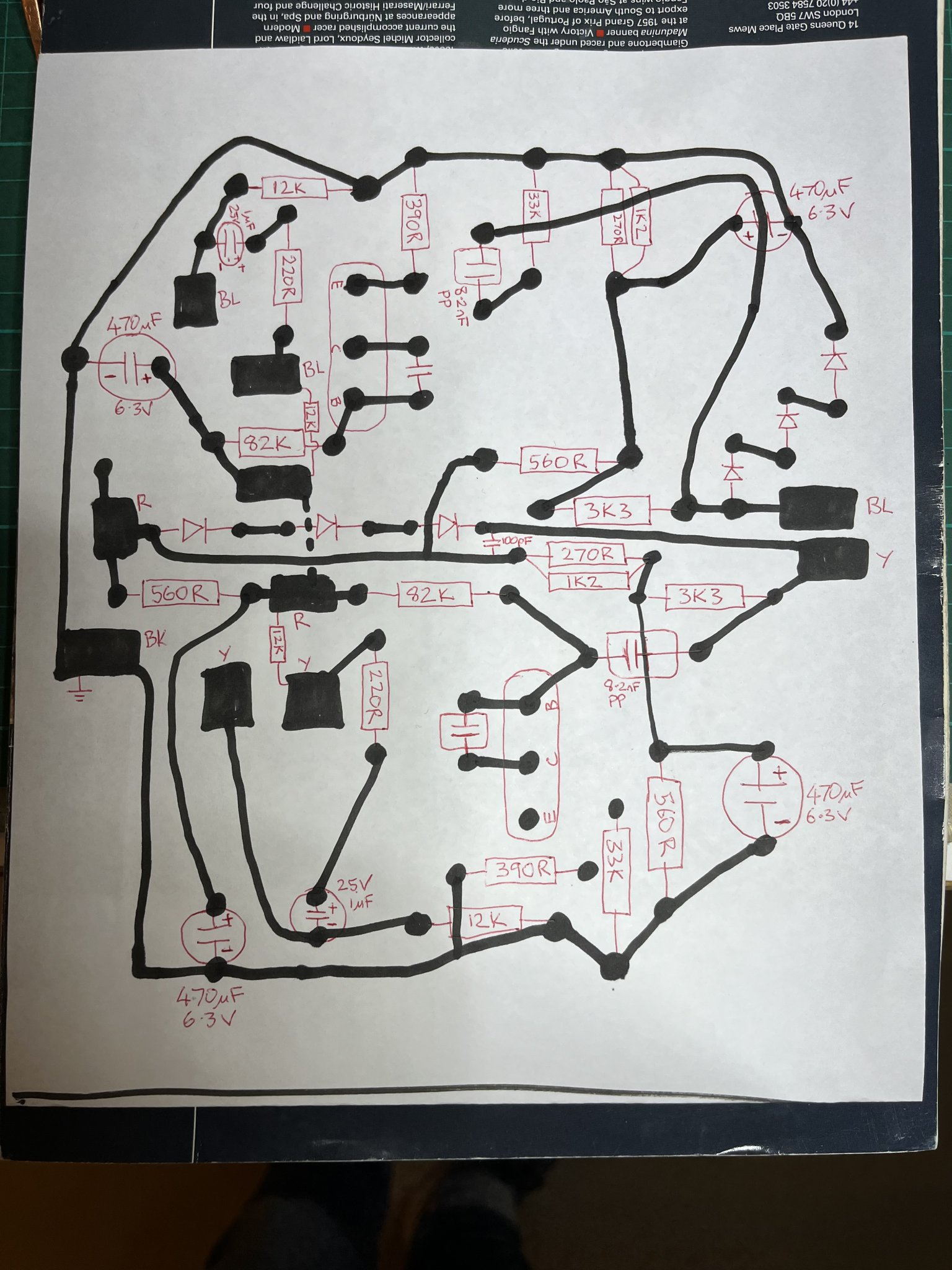

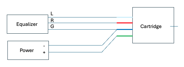

Separated the ground wiring to power and signal at cartridge clip side, good result and will keep this setup.
Yes the 5.6VDC lamp voltage supply is for the KE-9021 cartridge lamp in the cartridge. I haven't traced the circuit for the pilot light on the preamp, but it may be 100V AC. On my preamp the bulb appears to be open circuit.
I did not measure the pilot light voltage, it works without it...
The cartridge was connected when making voltage measurements. I will post further findings when I get time.

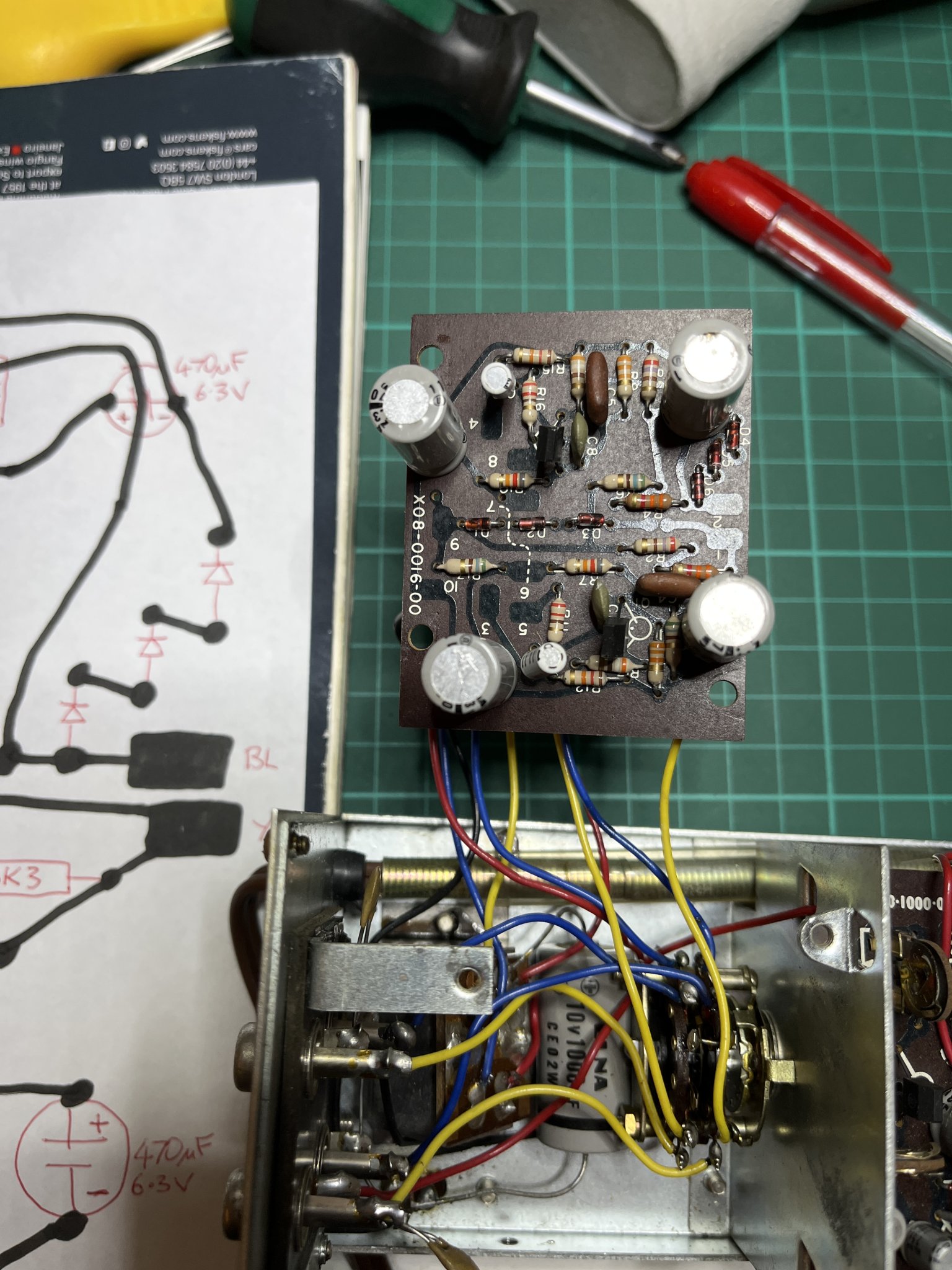

I found a cold solder joint which may be the cause of the hum in the left channel. Next I will power the circuit from a 6VDC battery with a dropper diode and measure current.
By the way, congrats on your cartridge purchase. Is it the one I saw on Yahoo Japan in the last month?
Hum was still present after resoldering. Next step is to try a battery supply. I suspect that separating the grounds will help here also.

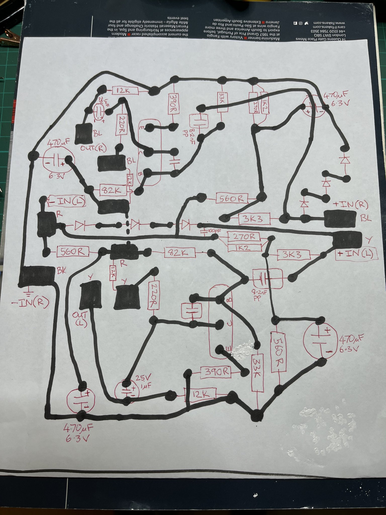

I’m rather confused by several R’s, Y’s and Bl’s that are not connected to each other. What is their meaning, I suspect wires having the colour Red, Yellow and Blue.
If so, where are these wires going to?
Hans
Those are the wires connected to the board. Yes correct on the colours. Still chasing down all the connections - consider this a work in progress.
I haven't confirmed the resistor values yet - values posted are just from the colour codes. And there may be some mistakes.
Mike

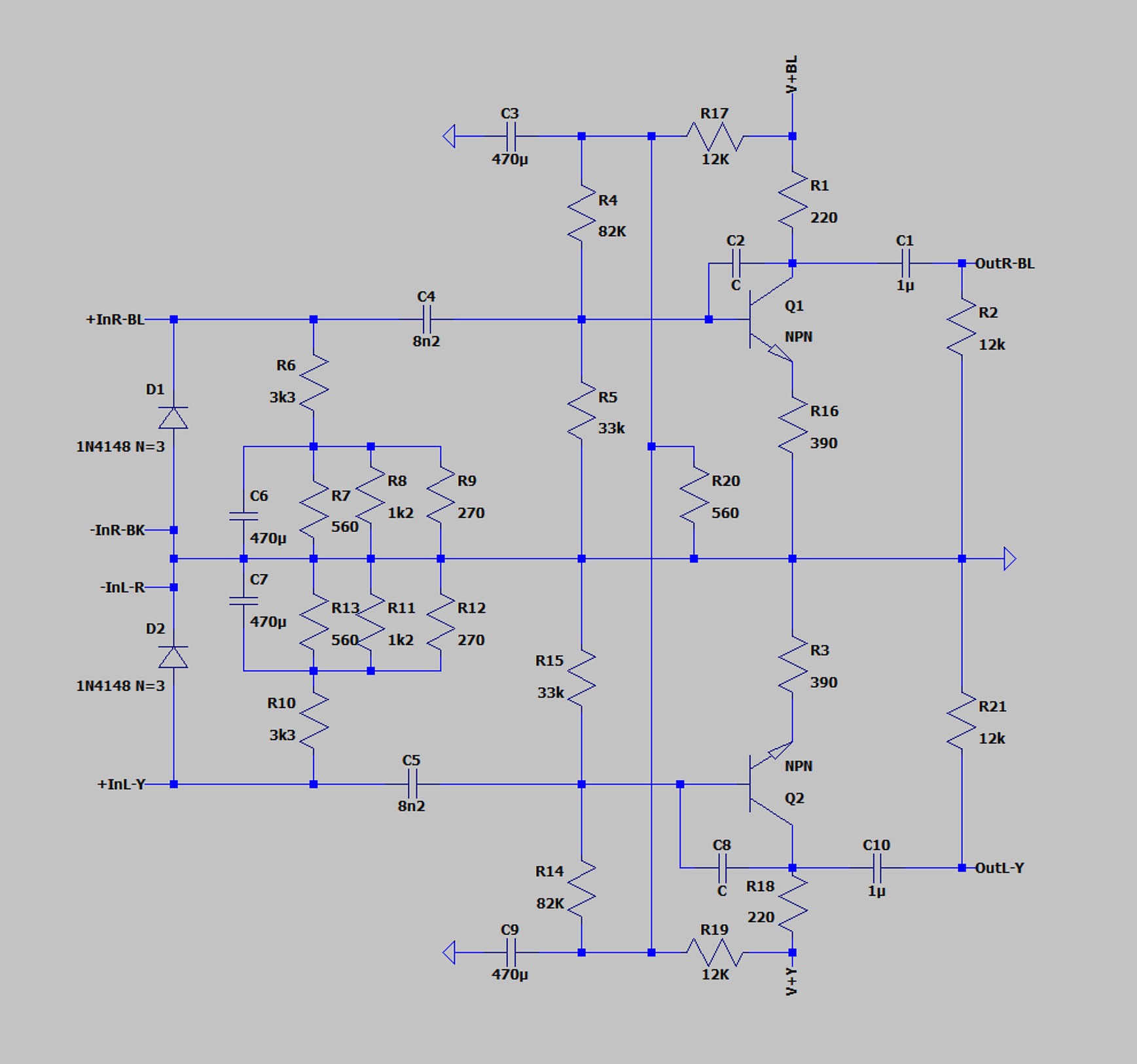

This is the best I could make of it.
I assumed that both -IN(R) and -IN(L) are connected to GND and not just -IN(R).
Then connected to -IN(L) is a 560R resistor, R20 in my circuit diagram, I very much doubt this value since it would not leave any bias voltage left for the transistors.
The other thing that seems weird is the 8.2nF cap feeding into 82K//33K, giving a pole at 826Hz, a frequency that doesn't seem to make sense.
Hans

I have checked over my circuit "map" and am pretty confident it is correct. The circuit is not symmetrical since one channel input is inverted in phase, and this has to be corrected before the output.
I will measure voltages later this week.

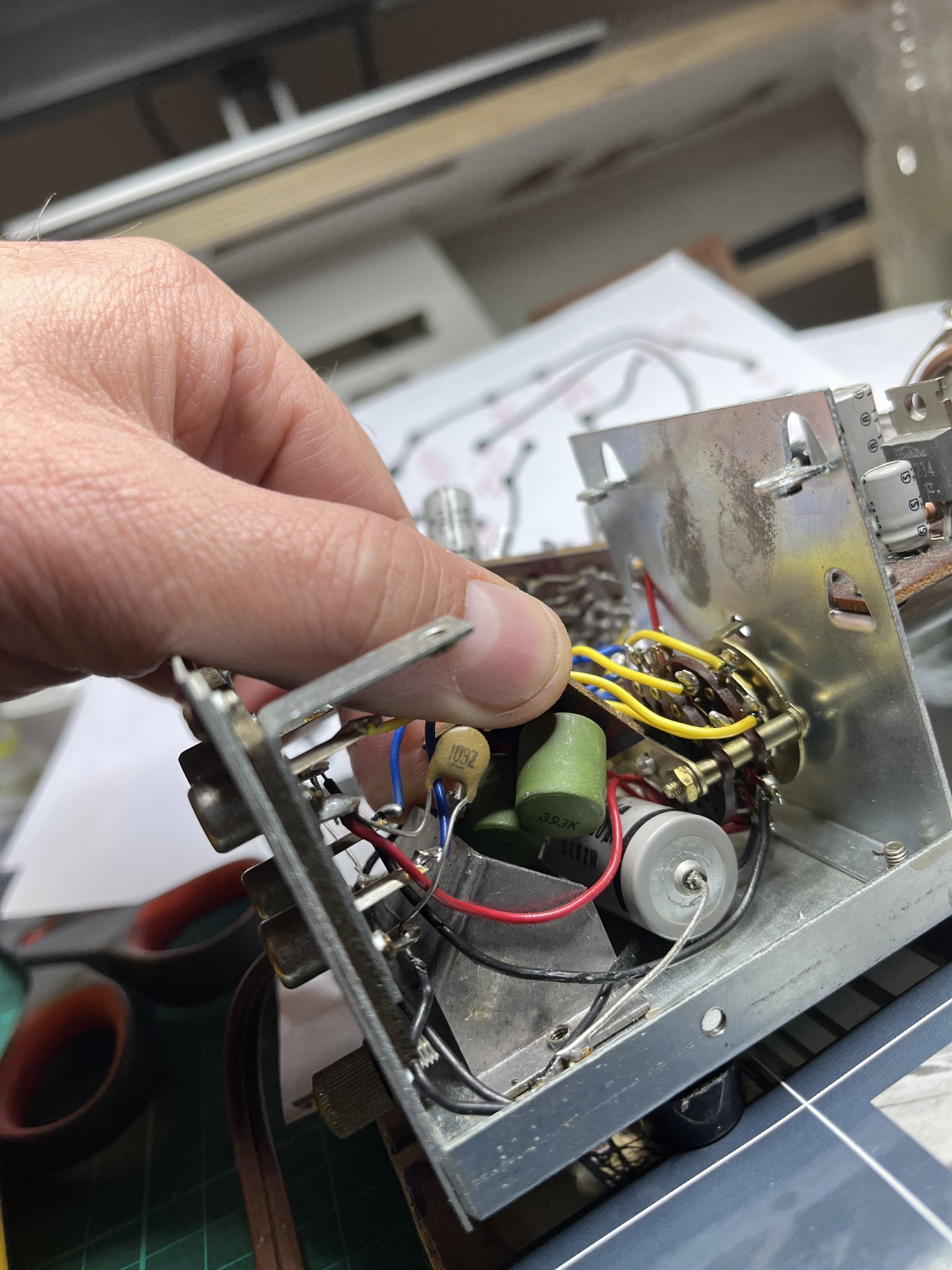

This evening I opened the enclosed metal box under the pcb to find...inductors!
These are 39uH inductors (about 25 ohms DCR). Looks like part of the filter network, that incorporates reverse-RIAA and EQ for the optical cartridge??? Or maybe just RF suppression? I need to run the numbers...
If it is part of the filter network, I'll be able to leave it out in my implementation as I will be using DSP.
