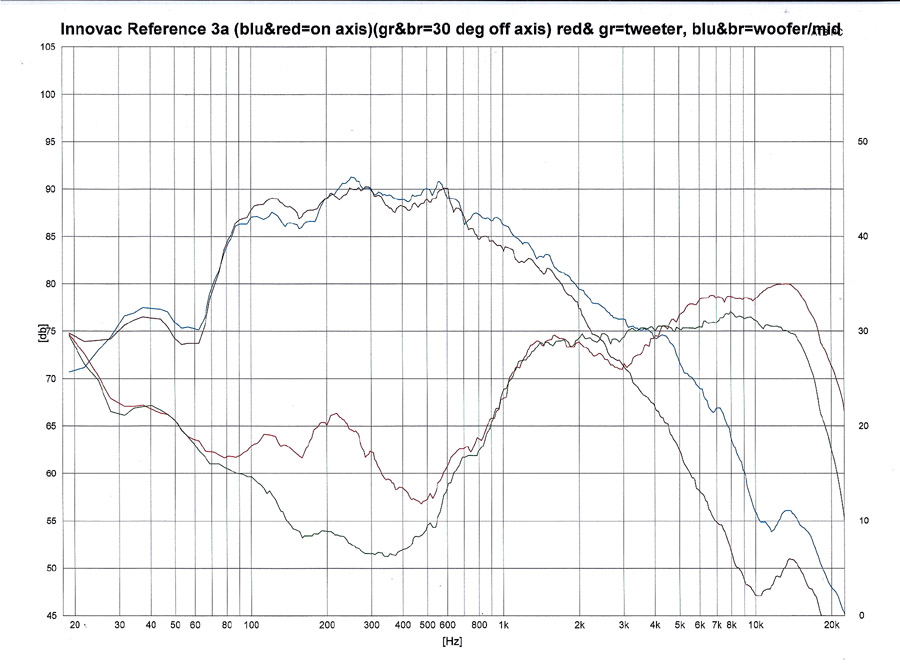

I'm looking at this chart and have a couple of questions.
If I'm not mistaken, the levels of the tweeter and woofer weren't merged, so that the frequency response may actually look a great deal flatter, than what it looks like in the picture. Also, it "seems" that the overall frequency response has a BBC dip in it. This may be what the designer intended and could provide a clue as to why this speaker is liked by some. If that's the case, then it may be possible to use tone controls or an equalizer to create the same "sound" in other speakers.
