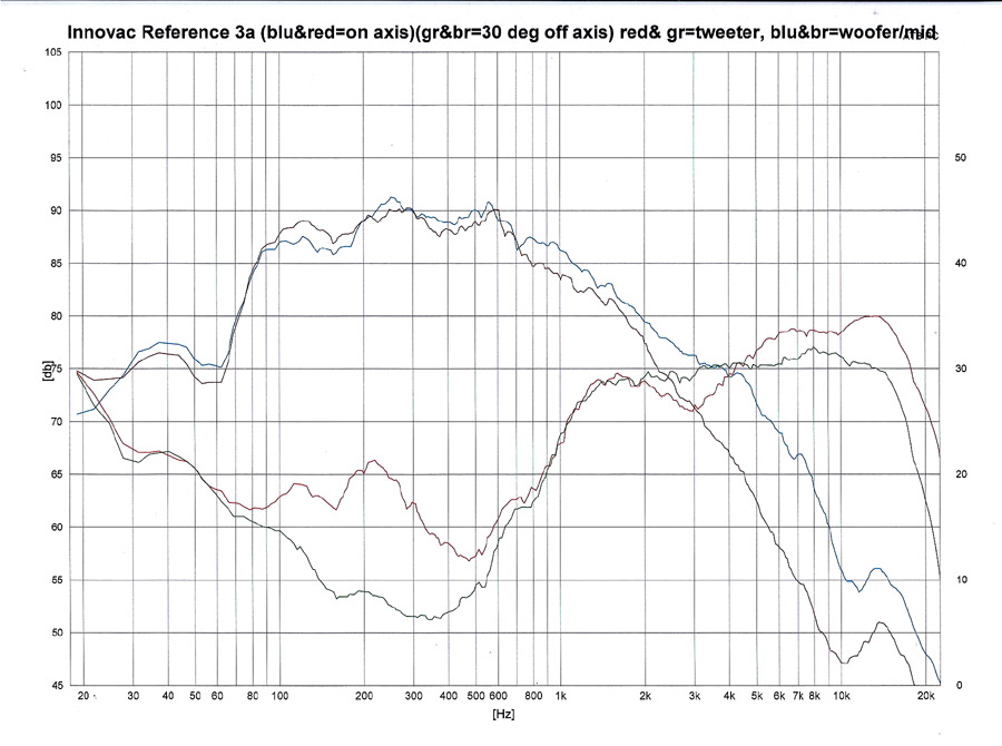

Regarding the Reference 3a speakers:
I bought my pair of these for a few hundred bucks from ebay (an older version, from the early 80's, I think). So to me this not a "cost-no-object"-thing. On the other hand I heard some very expensive speakers in the past that didn't impress me at all. Ok, the 3a's measure terribly, but: There are for example a few valve amps that do also measure terribly, but some of these have the ability do draw you into the heart and soul of the music like no other piece of equipment. Further more, measurements that are made in a special room for measurements do say very little about the frequency response in MY room or in YOUR room. A rouler flat response in a certain room can become a very odd resonse in another room. Just think about some of the very popular fullrange drivers, which many people do like very much. Look at their frequency resonses for a moment!
Then, some of us here in this thread do seem to be of the oppinion that a flat response and good electrical measurements are one key for musical sound reproduction. Others do seem to think that measurements do not mean that much in terms of musical reproduction (me for example). In a post above I said I find the 3a's to sound very "accurate". With this I didn't meant accurate in terms of a flat frequency respose, but accurate in terms of timing and speed of every single note or tone. This stiff and lightwight carbon fibre membrane is capable of following nearly every single impuls immediately, which is, in my oppinion, a very important thing when it comes to a speedy, impulsive, live-like reproduction of music.
There are a few conventional loudspeaker driver designs that are able to work with no or at least with minimum crossover requirements. One older driver that is unfortunately no longer available is the good old Seas W140NP. This one really works best without any crossover! Not new but still available is a unit from Monacor International, the SPH-165KEP. I tested this one a while ago and it sounds quite good with only a single inductor in the range of 0,33 to 0,47mH, but it can even be used without crossover. This one is great for a smallish standmount 2-way or a MTM floorstand. Also quite good without crossover or just with a single inductor of around 0,47mH is the Monacor SPH-170, which is good for sealed volumes of aorund 15-20l or vented in 35l with very deep bass down to 40Hz. It has a poypropylene membrane that is not as fast and precise as the SPH165KEP, but it's also a lot cheaper. I build a few speakers with this driver and the customers are quite happy with them until today.
Last thing is, of course a "crossoverless-2way" always means: no crossover for the woofer, and (in most cases) a single capacitor for the tweeter! Sometimes an additional RC-stage parallel to the tweeter for impedance linearisation is also required (as in the Reference 3a's), but in some cases a single cap does the job (often 2,2 to 3,3uF if a 8ohm tweeter is used).
In all these cases you will always have to deal with a few compromises. Sometimes a more complex crossover indeed sounds more precise and may be preferable for certain music like classical music. But then, the same speaker with a minimum crossover may sound more organic, fluid, open and involving, which may be suitable for other kinds of music like rock, pop or jazz. It's a matter of personal preferences, but it really is fun to try things out!

I had the opportunity a while back to work on a pair of Swiss-made Innovac Reference 3a's. The cabinetry was beautifully done. This pair came with an upper vented cabinet two way with carbon fiber bass/mid (no xover) and tweeter with a simple 2nd order xover. It also had a lower woofer section.
I did some measurements on the upper section; testing the bass/mid separately from the tweeter on and off axis. As you can see below, they do measure badly with a decline in response starting around 500 hz (someone mentioned this in a previous post) trailing off to 15 db down at 4 kHz and not rising much after that. I thought an off axis measurement might show some decline in the bass/mid's 100-500 hz 'hump' but it didnt. Off axis done at 30 deg.
I have no opinion on the sound because I didn't spend much time listening to them. Wanted to include the measurements in the discussion just for the record.
