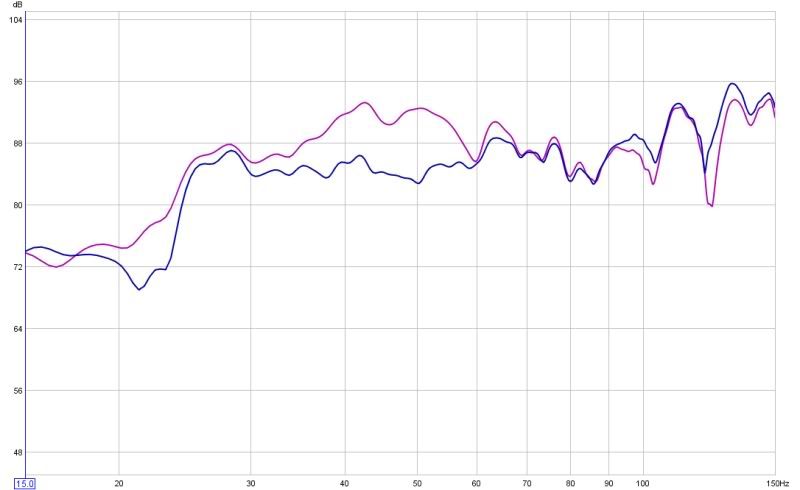

Do an experiment, those of you who can, run a sweep of your system, now delay the subs a few milliseconds, then run the sweep again.
Show us the graphs of the FR you get...huge variations from just changing the delay. Try it, I'm serious.
Delaying a driver (in the completely misguided attempt to infuse some sort of 'musicality' idea) will wreak havoc on the very thing you are trying to get, maximum extraction of musical enjoyment from a FIXED source, cd or lp etc.

Switch to looking at the arrival times between the drivers, fix that first last and always (if you are able to), THEN do any eq.
maybe time for a graph??
here's one I captured a while ago, I found it quite 'amazing'.
these are the results of that sweep idea I mentioned above, the frequency covers the range where my subs cross to my mains.
note the large difference at the crossover point (around 50 hz or so). (from memory, that difference is 10 db or so, quite a bit no??)
I did not change anything at all, except the one with the dip had the subs delayed by, well quite a bit actually, around 15 ms or so.
Yeah, you COULD throw eq at it and end up with a nice flat looking graph, but the subs timing would still be wrong none the less.
Ie you can only fix a timing issue with a timing solution.
