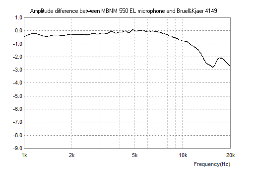

Amplitude difference between reference Bruel&Kjaer 4149 and MBHO MBNM 550EL.

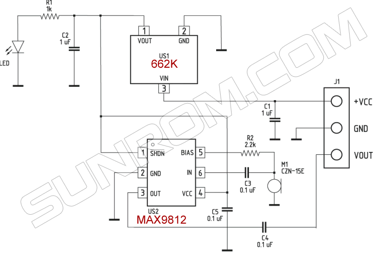

But I have in my drawer the Mic with amplifier :
MAX9812 Microphone Amplifier Sound MIC Voice Module for Arduino 3.3V/3.5V for raspberry pi 1 2 3 b w MAX9812 Microphone Amplifier Sound MIC Voice Module for Arduino 3.3V/3.5V for raspberry pi 1 2 3 b od Microphones na Aliexpress.com | Grupa Alibaba
For , used for Arduino. It is possible to find a producer of this module :
Microphone Amplifier MAX9812 [4836] : Sunrom Electronics/Technologies
Mic capsule - CZN-15E
Mic amplifier MAX9812
Power supply XC6206
Could anyone try to compare but calibrate with calibration mic.
