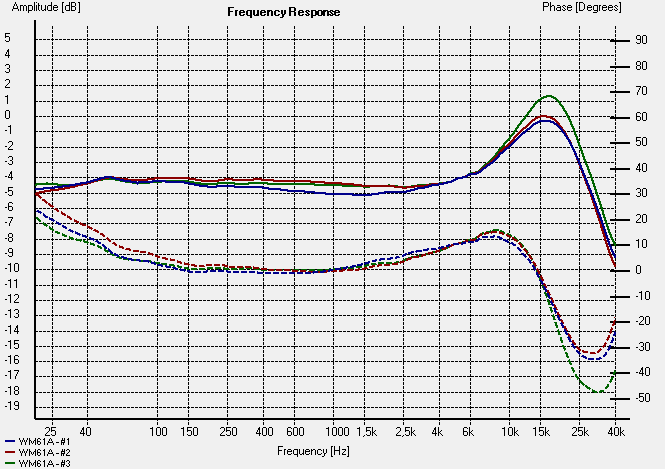

Hi, if of any interest I have a calibration file for the Panasonic wm-61a.
The capsules differ a few dB and degrees in phase.
But in overall they are quite the same
http://www.holmacoustics.com/downloads/MicrophoneCalibration/Mic_WM61A.cal
The attached image show 3 capsules (The dashed lines are the phase)

Re: Panasonic wm-61a Calibration (Gain + Phase)
Hi
Yes, very interesting (for unit to unit variation) quite good, but expected from same/similar batches.
Any information of the test configuration would be very much appreciated? In other words ...Can it be repeated by DIY folks here?

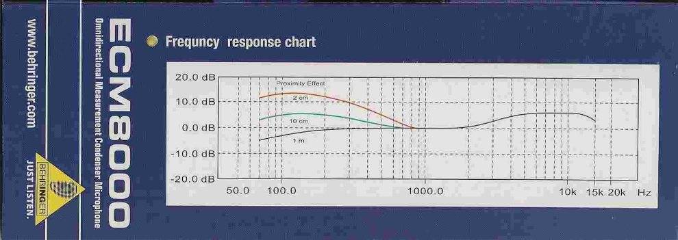

I wanted to warn you about my findings on the Behringer ECM8000 that I recently purchased. I had checked out Behringer’s web site for the spec’s on this mic prior to purchase and it seemed OK. However, when I received it, I found the attached printed on the outer cardboard sleeve that covered the carrying case. As you can see, there is a significant rise in the response at low frequencies due to proximity effects, making it quite unusable as a measurement microphone at these frequencies. I haven’t had the chance yet to construct a phantom power supply for this mic, so I don’t know if this response truly represents the response of this particular ECM8000 sample. I’ve sent an email to Behringer about a week ago asking them to elaborate on the applicability of these curves to the ECM8000, but I haven’t received a reply yet. I’m hoping it isn’t going to be a problem, and that the response will be the same as what Behringer advertise on their web site. I will probably have a phantom power supply up and running in a week or so and will let you know my findings. If anybody else has checked for proximity effect on this microphone I’d appreciate them letting us all know their results.

My guess would be that in order for the object to affect the mic response (proximity effect) it has to be of a size comparable to the wavelength at that frequency. Note also how quickly the effect drops away with distance.
This is just my opinion, of course.... the usual caveats apply.
I wonder if that is a printing error.
"Proximity effect" is an issue with directional microphones. Omni mics should have no proximity effect.
Yeah, an omni mic doesn't have proximity effect - but that doesn't mean the Behringer doesn't have a bump in the low end. Anyone in the US should pay $40 for a calibration, its sooo worth it. See my post earlier in this thread.
cuibono, i think all mics to have proximity effect at low frequency. some mic has much proximity effect. some has less.
Re: Re: Panasonic wm-61a Calibration (Gain + Phase)
The microphone capsules have been calibrated in cooperation with
the danish company (http://www.delta.dk )
It is the on-axis response.
My point is that if anybody are using a WM-61A without any clue about the response and have no calibration, then the calibration I link to is a lot better than nothing.
The measurement program I use is freeware (Developed by me): HOLMImpulse
