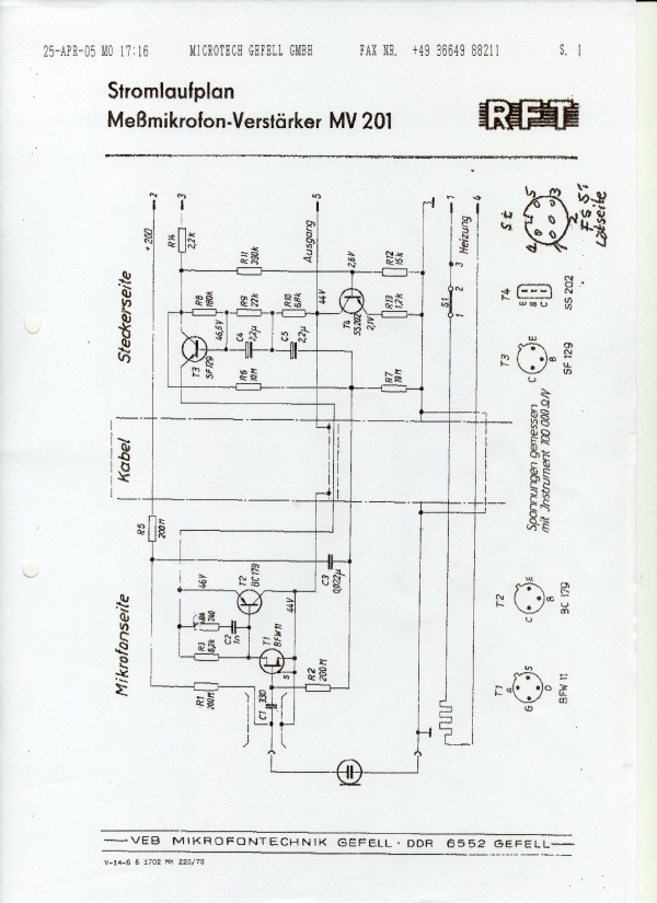

I just found this via Google. Phase splitter transistor... not exactly an instrumentation amp but, hey... it is what it is...
BTW, it seems that there are a few different versions. I don't know which one this is.
Thanks for that!
Yeah, nothing fancy there. C6 looks to be drawn in the wrong place
it goes to ground rather than the other side of R6 at the phase splitter output.
Outputs are in a sense open emitter to the phantom power source resistors.
I'd like to up C2, C3, C6 to 10 uF to flatten the response down to below 20 Hz.
This subject is covered here, somebody measured the mic and there is no output on one pin, it is not actually balanced and the connection of the coupling cap is as shown in the schematic - as much as it makes no sense:

I comment further here the phase splitter resistors seem to be set up incorrectly also:

My ECM8000 also only has output on one pin.
I just finished the Linkwitz circuit, but I can't seem to make it work with my line-in.
A couple things first:
1) I did not do the WM-61A mod;
2) I connected the capsule in the conventional method as shown here, but with a 10k resistor going to +9V (the 10k resistor in Linkwitz' circuit to the left of the input cap goes to +9V instead of -9V);
The preamp and mic seem to work when I use it as the input to a set of powered speakers, but when hooked up to line input it seems to be lacking gain.
I am not sure how to troubleshoot this circuit, any ideas?

That circuit has no gain. I suggest you build, instead, the Jason Neal mic preamp. It is a tried and tested circuit which I recommend.
