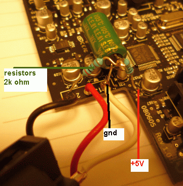

I recently did a small modification to ESI ESU22 soundcard.
http://www.thomann.de/gb/esi_esu_22.htm
This soundcard originally has a mic input for dynamic microphone, but by adding a 2k resistor - 50..100u cap to ground - 2k resistor to plus input of XLR connector one can nicely use an electret microphone.
(XLR -> RCA converter is also needed)
The plus of this card is that it has software controllable mic gain with dB accurate steps.
