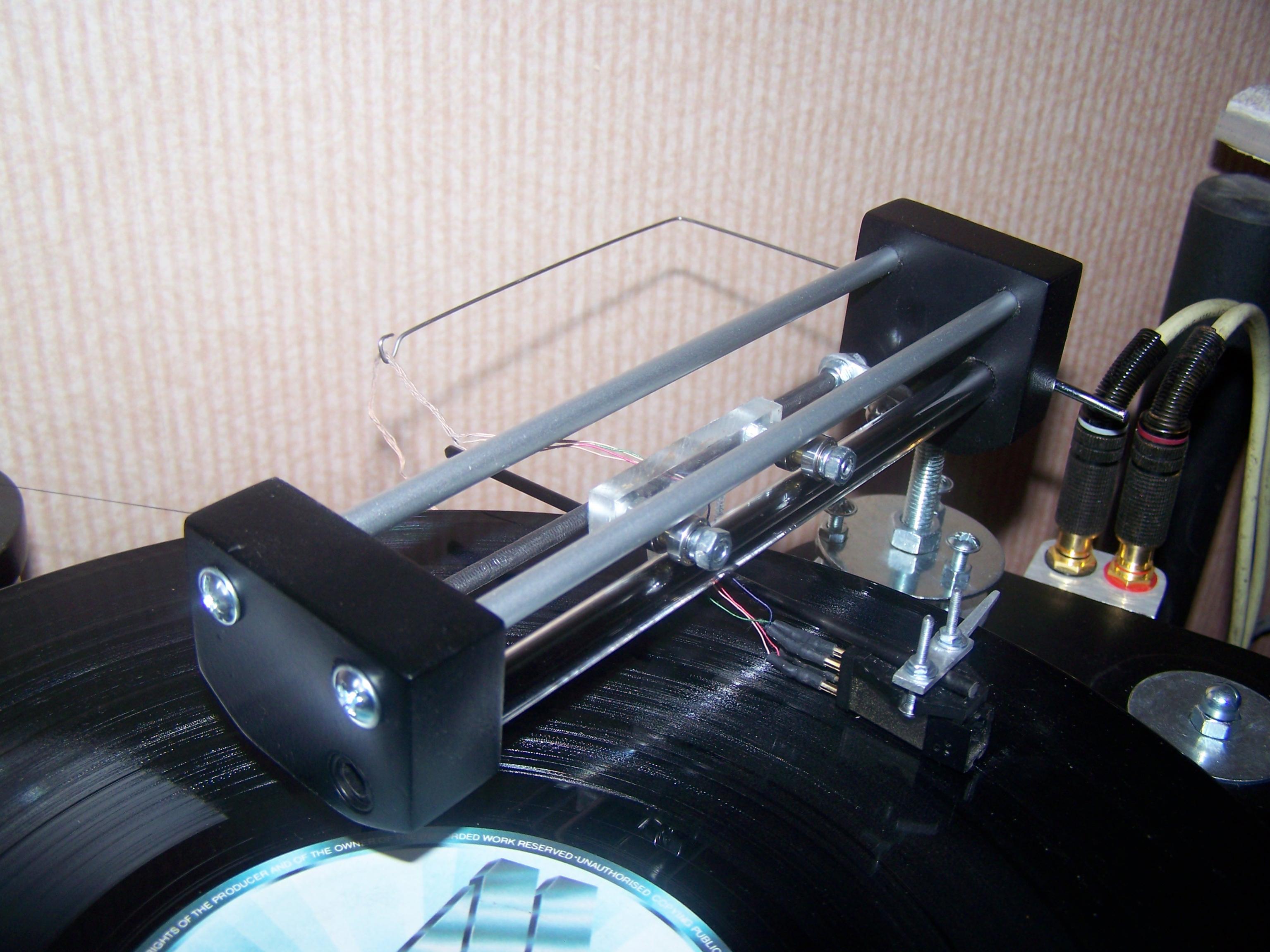

Tube termination

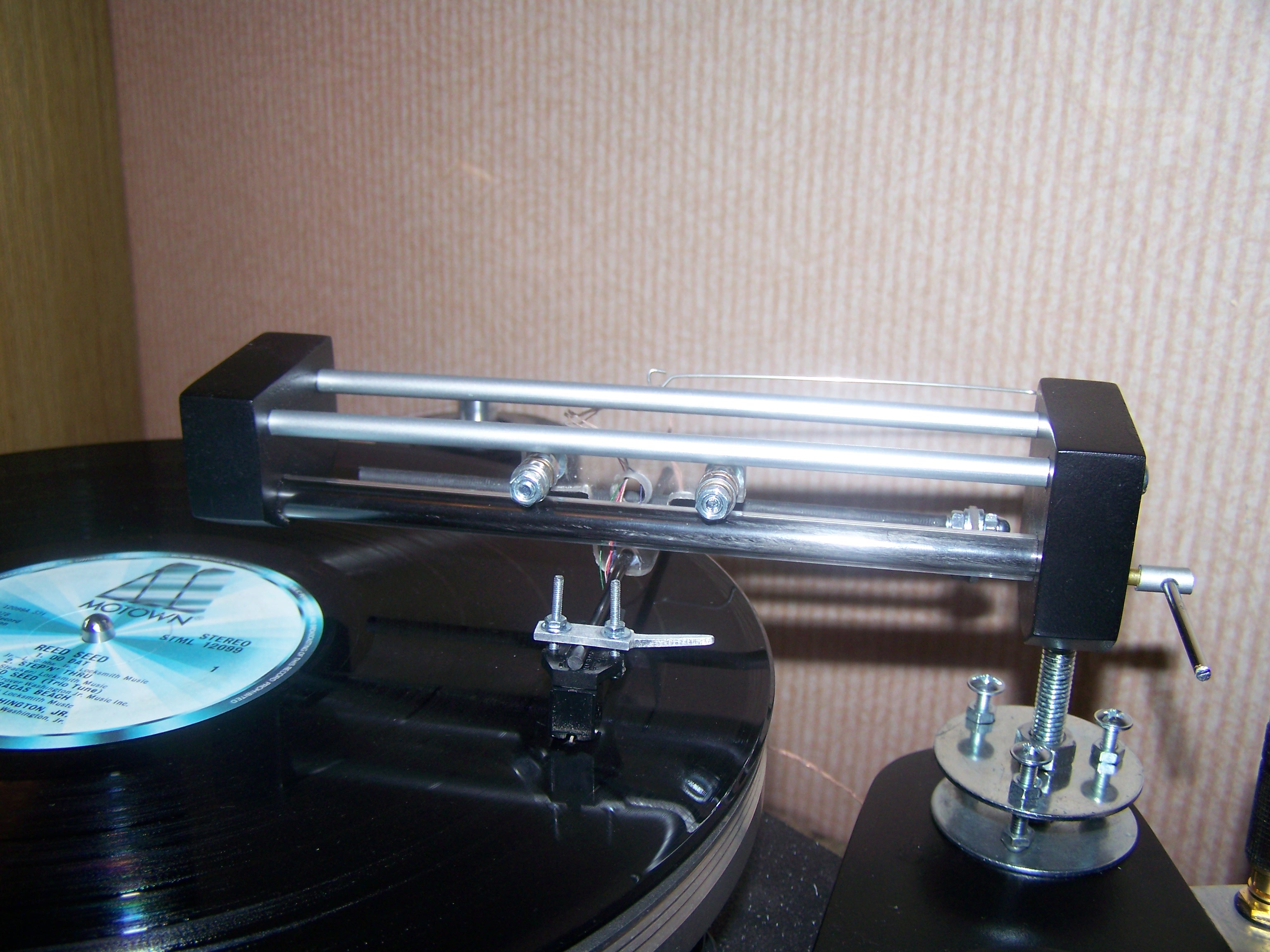

Looks nice! It looks like you've just glued or friction fit the glass tube into the end caps correct? The two aluminum rods at the top look like they will keep the whole assembly very rigid.
Hi
The glass tube is a friction fit. The aluminium tubes are glued and screwed to make the whole assembly very rigid indeed. This I believe not only helps with tracking but also with bass-listening to 'A Remark You Made' by Weather Report really showcased Jaco's bass playing. Need to do a few adjustments at the weekend-but if this is anything to go buy-we all have a real winner here!

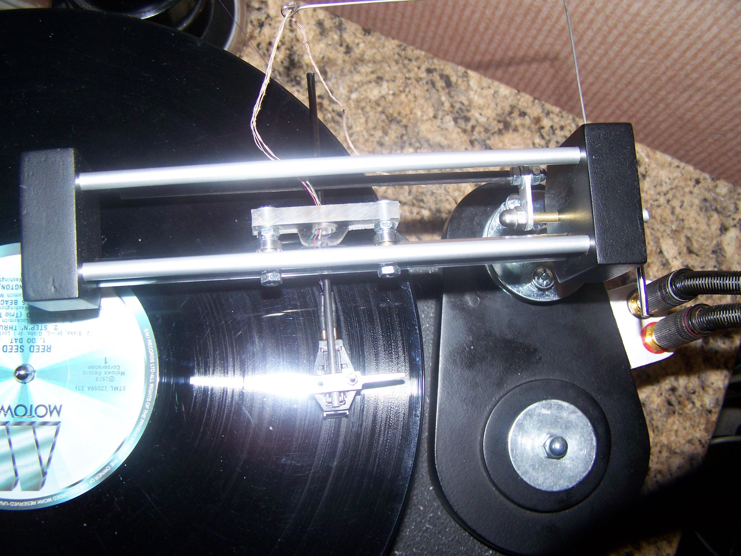

Nice build ChrisG139. Looks great but how did you align your arm? I imagined that the stylus would trace a line that would pass thru the spindle and run parallel with the arm's direction of travel. It might be an artifact of your photo-taking method but it looks to me like the stylus is well beyond such a line. I'm sure I could be wrong here.
Great work Chris!,

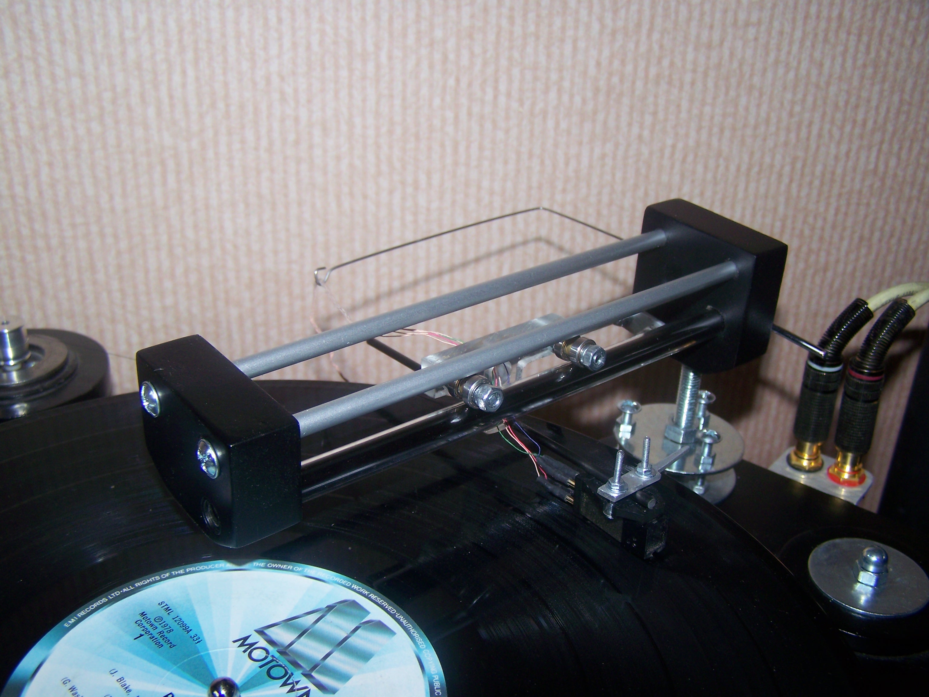

The extra bracing is beneficial for rigidity, I used a single 3/4" hollow Alu tube with a threaded rod for simplicity and the ability to change a potential broken tube if need be. This expansion also brings the resonant frequency down for the rail assembly which means further out of the critical audio band. Of course as ive seen you have done, is dampen the tube which is very simple and rubber o rings are very effective in this area since we don't want ringing getting back into the carriage. When all is said and done, you should be able to tap the glass lightly with your fingernail with music playing and not hear anything through the pickup other than maybe a slight low thud, a very damped quiet thud.

You are absolutely correct. I'm an old hand at parallel trackers-had a Cantus and a Clearaudio Tangent. The stylus in in perfect line -must be the angle of the camera!
Speaking of perfect line,
I must wholly reiterate how important a linear is to being setup correctly, fail this and you'll be wanting, achieve this and you will be surrounded by glorious music and tracking. In this design the goal is keeping the whole carriage cartridge included under 30g, mine with cart is 28.8g, which is fine if you keep the mass center of gravity low as a whole.

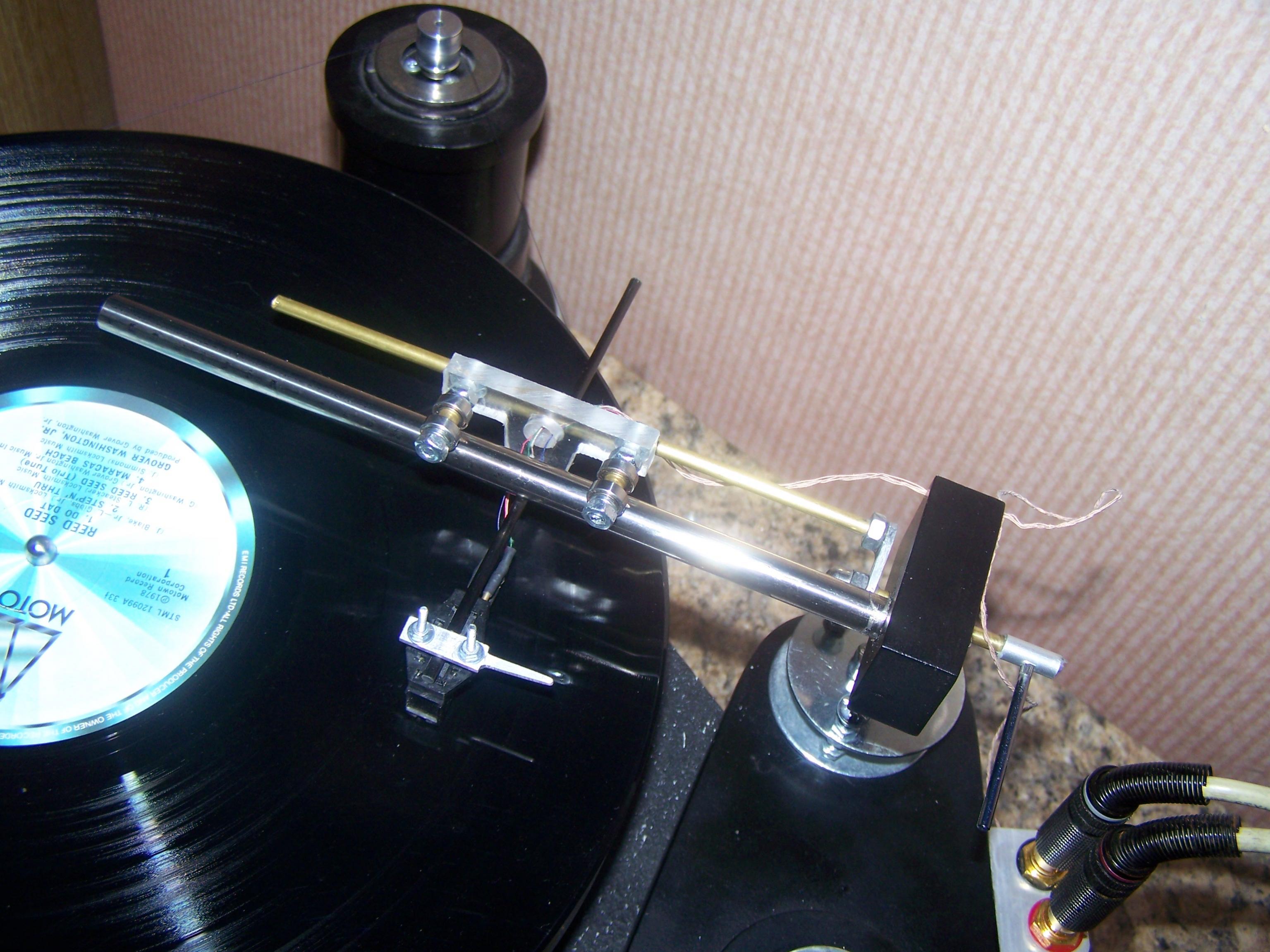

Hello Everyone

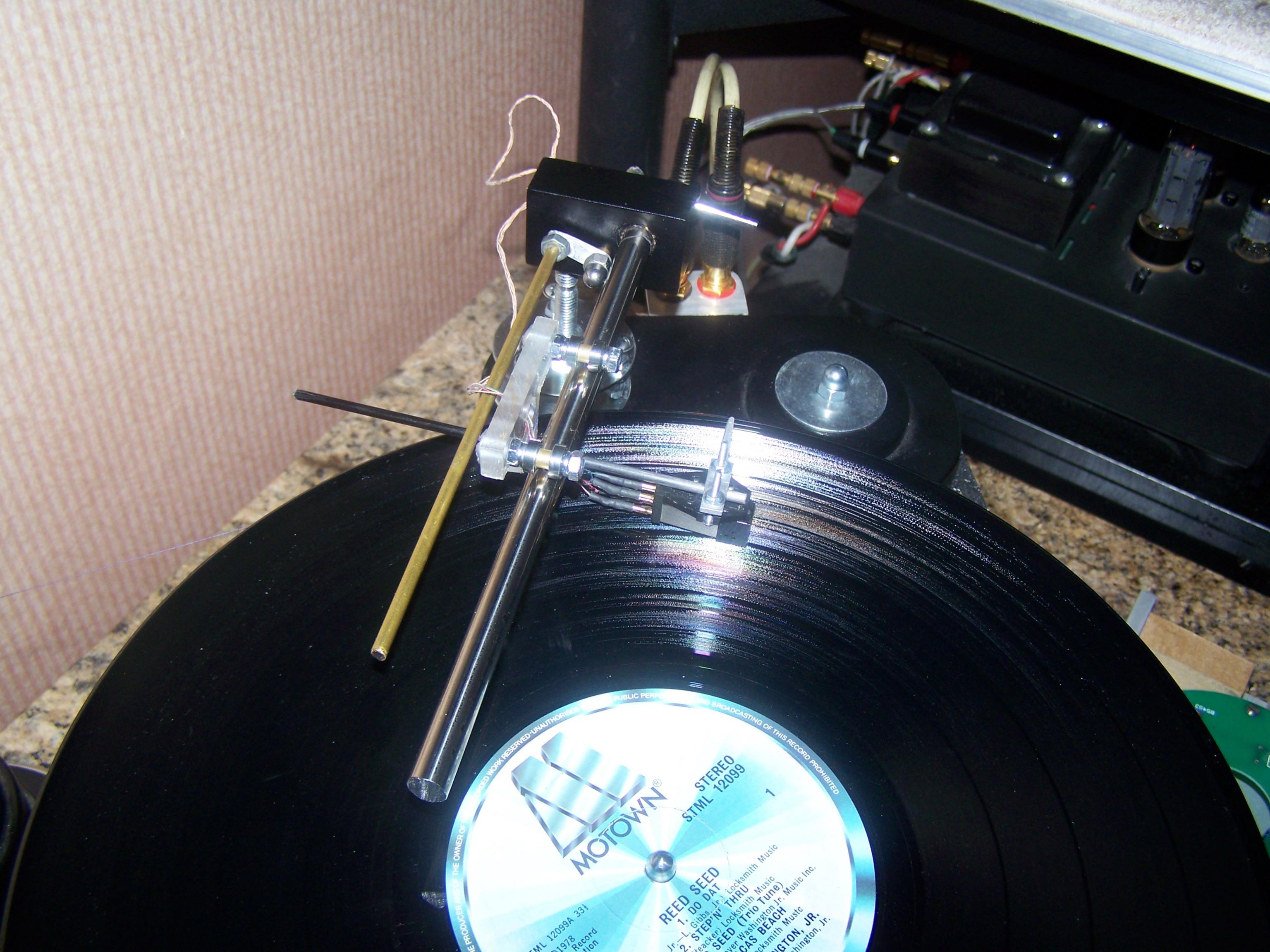

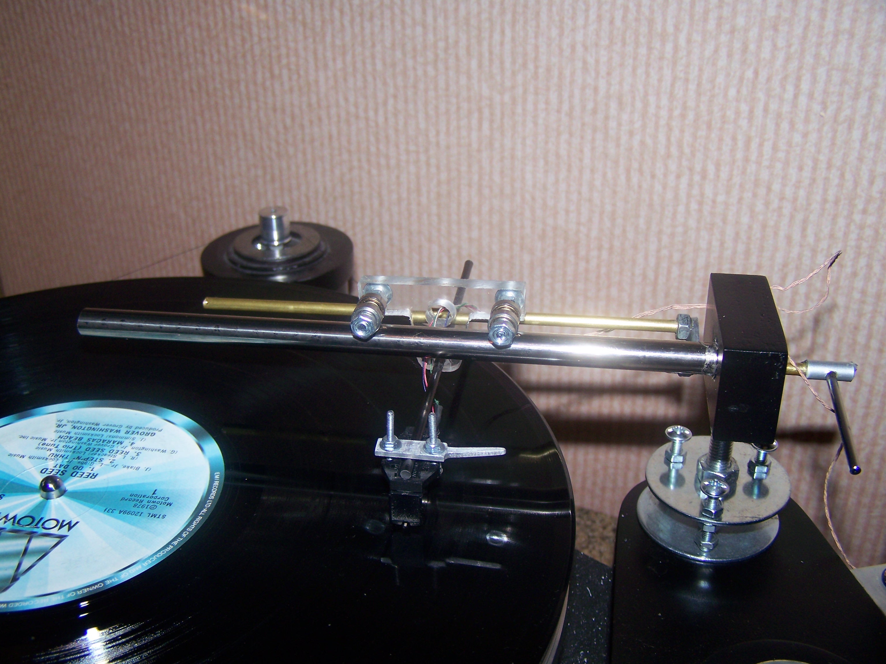

After proving flawless performance with my last version, I remembered someone mentioned the rod out of a printer-the one the ink carriage runs on. At lunchtime today, I noticed a printer which we were going to throw out in the corner of of the office. Hey presto-ten minutes later I had one highly polished metal rod!
Got home after a two and a half hour drive (M6 on a Friday is not to be recommended). After cutting to size, I mounted the rod on my original carrier (see pictures) and was immediately impressed at how much smoother the carriage rode the rod compared to glass. Early days but it again operated flawlessly, but also detail seemed a degree or two more real and bass was also a step up on previously. Has anyone else actually tried this?

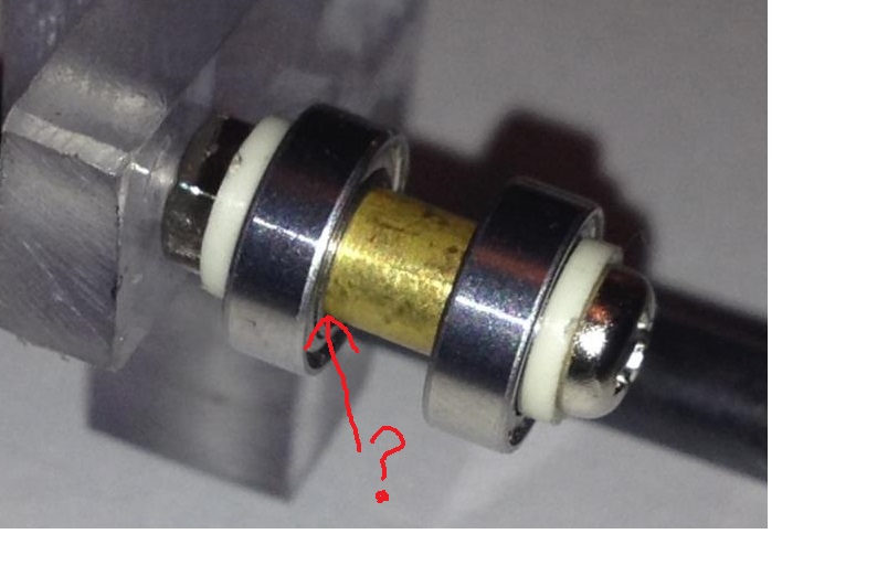

Is there any gain to hope by making a groove in V or U shape around the external part of the bearings to have 2 contact points per bearing ?
That is to say only two bearings instead of four.
I can do it with a lathe and a grinder.
you can also buy them, search " concave Yo Yo bearings "

one more Q :
I'm realy wondering how tide , or loose the bearing should slide across the bras rod . perhaps the maker of this arm design can chime in here ?

Chris: is the metal rod larger or smaller diameter than your glass tube? Best regards Moray James.
Chris
Glad it worked out for you - all I knew was that the rods are straight and round have a good surface finish

The 12mm tube will require a 5-6mm bearing spacing, a 10mm tube is 4-5mm. Bearings should be loose enough to slide easily across the shim when not riding the tube.
