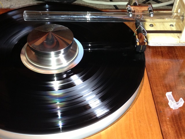

Maybe another material which is possible :
ROD10/200-4B1 - FERROXCUBE - FERRITE CORE, CYLINDRICAL | element14 Australia
The ferroxcube rod.
I don't know the geometrical accuracy nor finish, but it is cheap, easily available and it has a very hard skin.
The ferroxcube rod.

That 0.002" deviation? is that with the tubing on the flat surface, end to end?
Suggest hanging one end OFF the end of the precision flat by an inch or so and seeing if the deviation is in the center of the tubing or because of the way it is made or cut and held at the ends??
I would think light shining from the rear and looking at the edge on the flat would tell the story visually.
IF the thing is bowed like a mild parabola it might impact the tracking at the center as it would look like a mild "uphill". Otoh if these are merely surface undulations, maybe not much of an issue.

bear :
It is funny that you mention how the deviations were measured. You are right on point.
This morning I took the samples of the tubing I have on hand and put into a Hardidge 5c collet and hand spun them in my lathe. The results were not pretty !!!! It was like spinning a " banana ", you did not need a dial indicator to see what was going on. I would not use any of these tubes for this project. Period.
Not only that, but visible distortion while shining a light through the tubes and a newspaper placed behind the tube was obvious. Most people here do not have the ability to measure their tubes but this a critical part of this arm. Some people here think this extreme but I beg to differ. I believe tube quality will separate a " very good arm " that " works " from an excellent arm.
When molten glass is extruded gravity will take its toll.

This thread has been very inspiring. While reading it twice I was wondering about the way the bearing->tonearm connection is made. This is similar to the Cantus tonearm, basicly the connecting T-bar+bearing is a C-shape. That form is a must in the Cantus because the bearing is inside the glass tube. Now with this 4-bearing design, doesn't the bearing on the side of the "T-bar" take more/most of the stress of the weight.
This C-shape of course makes it easier to remove the tonearm from the glass tube for more fiddling, but it also makes me a bit scared that a clumsy user, like me, could drop the whole structure off of the glass tube.
So, how about a U-shape structure like in the attached drawing? This woud prevent the dropping of tonearm and it would give all 4 bearings same load.
Although not in the image, you still could make the bearing assembly with the brass shim etc. like the original desing has.
I hope somebody undestood...
